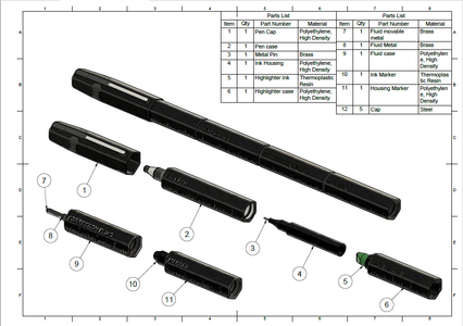

Multipurpose pen as the name implies, it consists of different functions. To be exact and precise, it has four functions. It can function as a ballpen, highlighter, correction fluid, or marker. The key to combine all of the function stated in the previous statement is to create a total of four equally dimensioned barrels. Barrels will serve as a container for each of the functions. The barrels can be connected or disconnected to each other. If they are connected to each other, it looks like a normal ballpen but don’t be discouraged, multipurpose pen hides many functions and possibilities. Multipurpose pen can be rearranged depending on the choice. To pick the desired function, place it to the very bottom portion.

The design was made in Fusion 360 along with the dimensions. After that I provided an intractable for the steps. Here is the process:
Step 1: 3D Printing

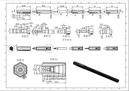

3d print the four barrels. For the ballpen barrel, it has a dimension of 46.6 cm long. Highlighter barrel is 35 cm long, and for correction fluid and marker barrels, it has a dimension of 37 cm long. All of the four barrels has a diameter of 10.02 cm. Aside from the barrels, 3d print also the cap. The cap consists of an overall dimension of 44.85 cm in length.
Step 2: Ballpen Portion
Provide all the materials for the ballpen portion such as tip, ballpen tip, and ink chamber. For the tip, it consists of an overall dimension of 11.22 cm in length and 6 cm in diameter. As for the ballpen tip, it has a dimension of 3.15 cm in length and 0.5 cm in diameter. Lastly, for the ink chamber, it has a dimension of 29.48 cm in length and 6 cm in diameter. Fill the ink chamber with ink, assemble all the parts of the ballpen and insert it in the barrel.
Step 3: Highlighter Portion
For the highlighter portion provide a cotton core with a dimension of 35 cm in length and 5.5 cm in diameter. As for the tip of the highlighter, it consist of an overall dimension of 9.35 cm in length. Fill the cotton core with highlighter ink, assemble all the parts of the highlighter, then connect and insert it in the barrel.
Step 4: Correction Fluid Portion
For the correction fluid portion, provide a cartridge that would serve as a storage for the correction fluid with a dimension of 37 cm in length and 3 cm in diameter. As for the tip of the highlighter, it consists of an overall dimension of 11.58 cm in length. Fill the cartridge with a correction fluid, assemble all the parts of the correction fluid, connect and insert it in the barrel.
Step 5: Marker Portion
Just like in the highlighter portion, provide a cotton core that would serve as a storage for the ink of the marker with a dimension of 37 cm in length and 6 cm in diameter. As for the tip of the marker, it has an overall dimension of 8.92 cm in length and 3.87 cm in diameter. Fill it with the ink of the marker, assemble all the parts of the marker, then connect and insert it in the barrel.
