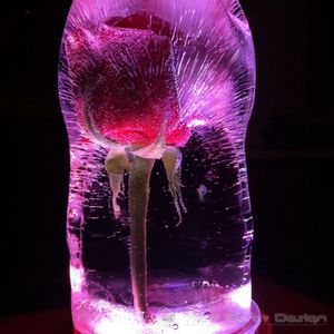

I created this project to add a little sparkle to the dining table when having a romantic meal with the girlfriend at home. Taking inspiration from the Enchanted Rose in Disney's Beauty and the Beast, it consists of a block of ice with a real rose encased inside. The ice is illuminated by a short strip of LED lighting enclosed in a 3d printed light base enclosure.
This is a relatively quick project to build, I did the whole thing in around 8 hours (including the time to freeze the water).
The light is remote controlled and can be set to static colors or to change light effects automatically.

Step 2: Making the Frozen Rose
To make the frozen rose ice feature I used the following items:
- Plastic drinks bottle (I used a 1.5L Cola bottle)
- Red rose
- Water (ideally distlilled or filtered, but I used tap water)
Polystyrene (to hold the rose while it freezes)
The ice feature is made using a plastic drinks bottle, with the top section of the bottle cut away and filled with water.
Get your rose and poke the stem into the piece of polystyrene, this will hold the rose in place. Drop the rose (upside down) into the water, resting the polystyrene on the exposed rim of the bottle, then place in the freezer.
How long it takes to freeze will depend on how cold your freezer is, the starting temperature of the water and the volume of water you have in the bottle. The height of your ice feature will be determined by the amount of room you have in your freezer, so check it all fits before you get too carried away!
When frozen, simply take care to cut away the rose stem that's exposed from the ice and gently remove the ice cylinder from the plastic bottle. If you struggle to get it free you'll find that running some water over the outside of the bottle will help to free it more easily.
