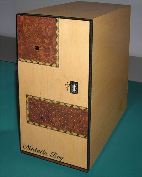

This is another version of a project I posted about 18 months ago, the "MidniteBoy" (Mb):
https://www.instructables.com/id/Multimedia-PC--Low-Power-File-Server-Recycled/
I took the last one apart and re-used the parts with some additions in a new design. I call it "MidniteBoy2" (Mb2).
The main changes are an integrated LCD panel (yes, I had one from a project that became scrap), some improvements on the simulated wood technique, a fan to deal with the added heat, much better user interface software, more Windows chrome removal, and a few other interesting tricks.
Also, this version is made to hang on a wall like a painting instead of sit on a shelf like a PC-style box next to a TV.

To start with, the whole box surface, inside and out, was painted matte black.
For this design, I wanted to end up with a satin finish on the box. To get this, I used matte surfaces then finished the whole thing with a satin protective coat.
After getting the design I wanted for the wood parts, I went to my local print/copy shop and got very high quality prints of my artwork on tabloid-size sheets (11 x 17) for about $2 per page. They came out beautiful too.
The artwork pages were trimmed and glued to the box using 3M spray adhesive.
