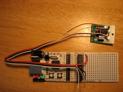

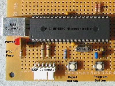

Step 1: About the CREATE USB Interface

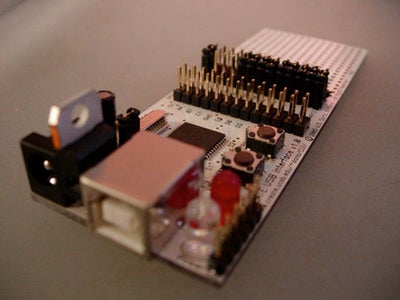

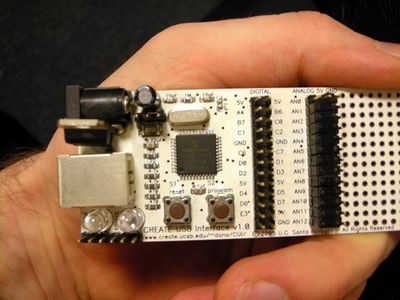

The CREATE USB Interface (CUI) is a simple PIC-based programmable circuit that can either be built entirely DIY, or you can get a pre-built one from me directly for $50 (+ 5 for shipping), and you won't need to buy a PIC programmer since I put the bootloader on it for you... see the website for details, or just email me to request one:
CREATE USB Interface website
The CUI can function as many different things, and has by now been used in hundreds of interesting projects all over the world... a few examples from students at UC Santa Barbara are in this conference paper (PDF). The CUI can be reprogrammed through the USB cable using the bootloader, which is why it is so easily adaptable - simply change the firmware and it is something else.
For example, it is easy to make the CUI into a wireless sensor interface using one of the Bluetooth modules from spark fun - if anyone is interested in doing this, post a note in the comments requesting another instructable. The CUI has 13 channels of 10-bit analog inputs and 16 general purpose input/output pins. The default firmware shipped with the CUI v1.0 boards sends them all as inputs to the host computer, and works nicely with interactive art-making environments such as Max/MSP/Jitter, Pd/Gem, SuperCollider, Chuck, etc.
I used one of the CUI v1.0 boards to build the Multimodal Music Stand in this instructable. We use Max/MSP/Jitter as an environment, but by all means feel free to adapt this to Pd or your choice of software. I am a big fan of open source (the CUI itself is open source), and it helps greatly if we all stand on each other's shoulders and improve the things we're making!

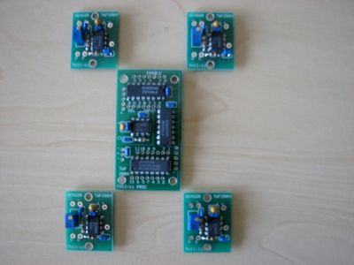

Step 2: About the ThereminVision II Kit
The ThereminVision II is available both as a kit ($50) and pre-built ($80) from the vendor site, RobotLand, and is also open source - the ThereminVision II manual (PDF) includes the circuit diagrams. For the MMMS, I bought the kit and then decided to go with the pre-built one this time (this is the second MMMS I've built).
As an aside, in case you're wondering why I don't offer a kit form of the CREATE USB Interface, it's because the CUI bootloader has to be programmed with a conventional PIC programmer before new firmware can be sent over USB - otherwise I would definitely offer a kit, though it would involve surface mount soldering...
So back to the ThereminVision II - if you bought it in kit form factor, follow the (great!) instructions in the pdf:
There are a lot of nice diagrams of the wiring you will need to do - the only thing it doesn't show is the connections to the CREATE USB Interface, so I will post the photos I took on the next few steps... oh, and I got the antennas for the ThereminVision (not included) from All Electronics.

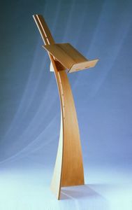

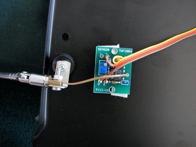

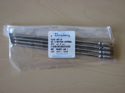

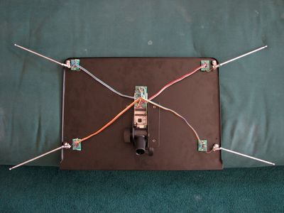

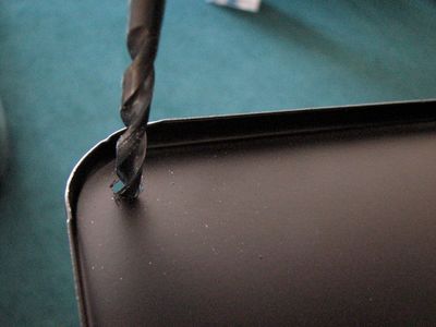

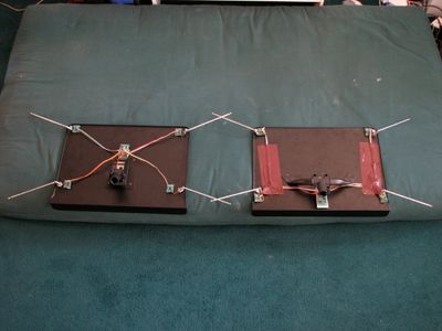

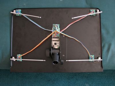

Step 3: Preparing the Music Stand

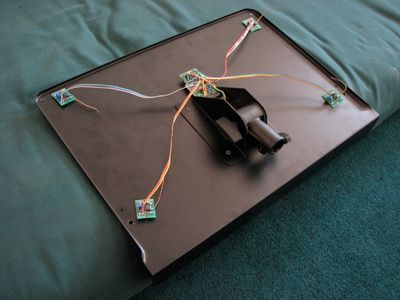

Make your Multimodal Music Stand out of a nice music stand such as the "conductor stand" shown here or use whatever you have on hand - better yet, make your own!

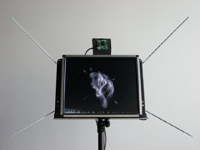

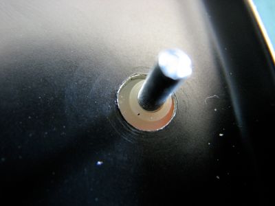

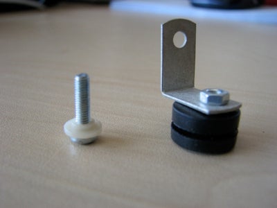

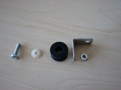

No matter what stand you use, it will need isolated mounts for the four antennas at the corners of the stand. Start by drilling holes in the corners - the mounting hardware I had laying around worked with a 1/4" drill bit, yours will probably be different. Try to keep the front of the surface as flush as possible to avoid interference with sheet music.

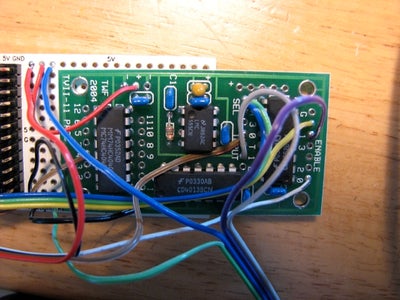

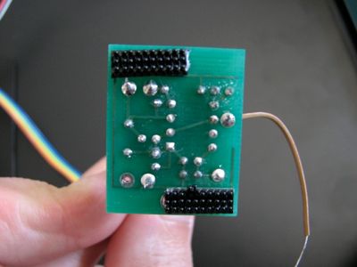

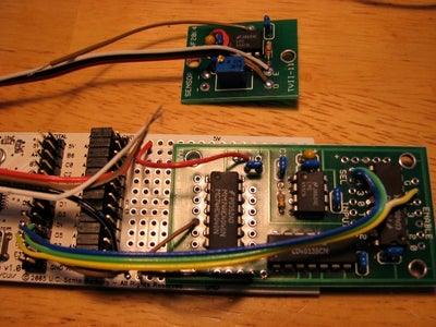

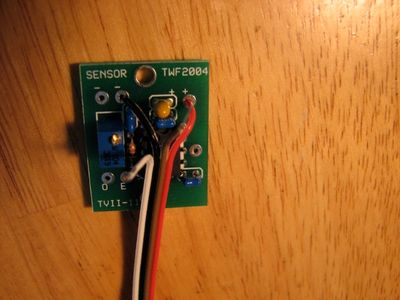

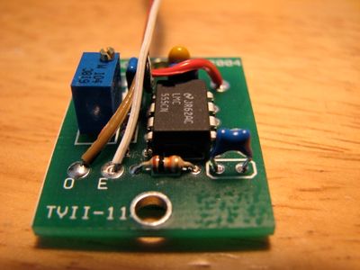

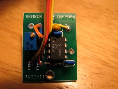

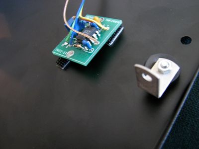

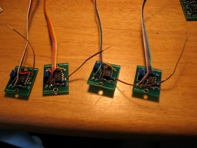

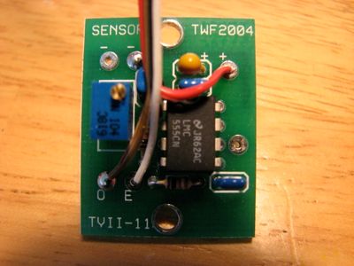

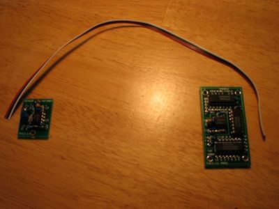

Step 4: Connecting the ThereminVision Sensor Modules

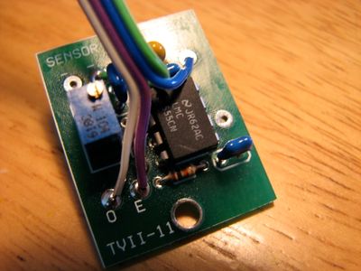

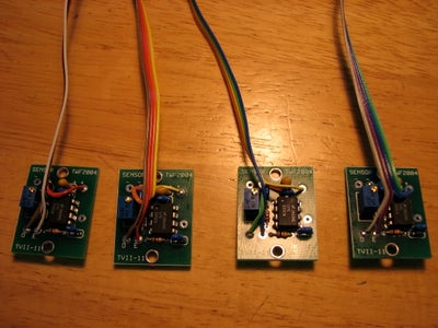

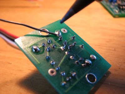

Connecting the ThereminVision "sensor" modules (555 timer circuits) to the ThereminVision "processor" module is also discussed in more detail in the ThereminVision II manual, but here are a few pics of the process...

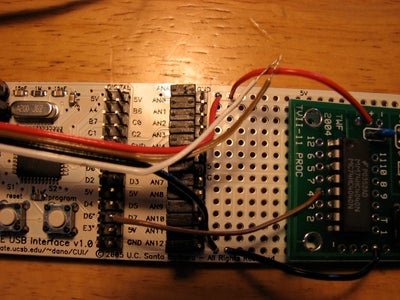

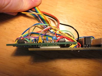

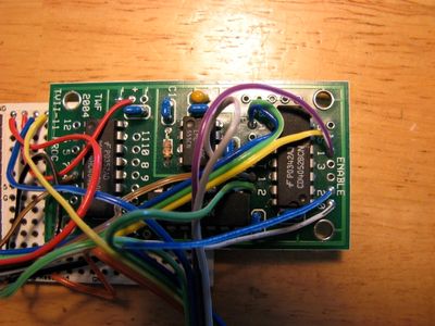

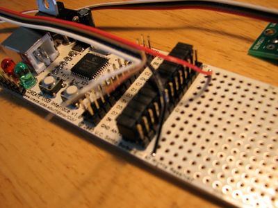

Step 5: Connecting the ThereminVision to the CREATE USB Interface

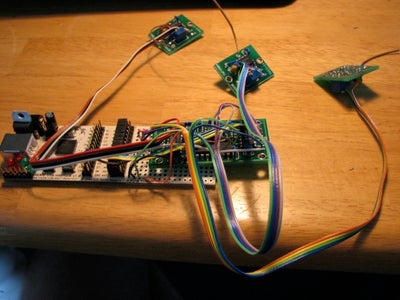

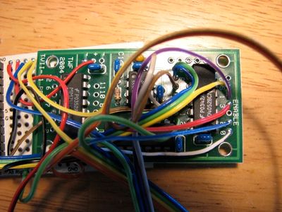

As we saw in the last step, there are 4 wires connecting each of the sensor modules to the ThereminVision processor module. There are also 6 wires connecting the ThereminVision processor module to the CREATE USB Interface - they are Power, Ground, Sensor Output, Sensor Select A, Sensor Select B, and Sensor Stop.
Since the ThereminVision II will get it's power from the CREATE USB Interface (which in turn gets its power from USB), I decided to connect the power for each of the ThereminVision sensor modules directly to the CREATE USB Interface - this makes it a bit less of a bird's nest on the wiring since there are already a lot of wires going onto the TherminVision processor board.
Connect "+" on the ThereminVision to "5V" on the CUI
Connect "-" on the ThereminVision to "GND" on the CUI
Connect "4" (the divide by 4 output) on the ThereminVision to "D7" on the CUI
Connect "SEL B" on the ThereminVision to "D5" on the CUI
connect "SEL A" on the ThereminVision to "D4" on the CUI
Connect "S" on the ThereminVision to "D6" on the CUI

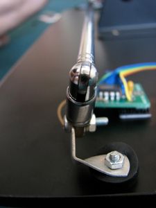

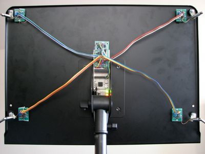

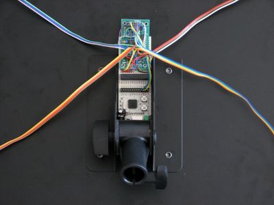

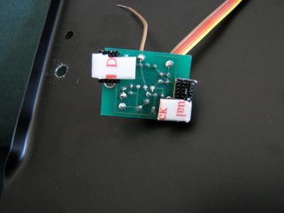

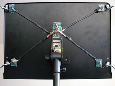

Step 6: Mounting Everything to the Stand

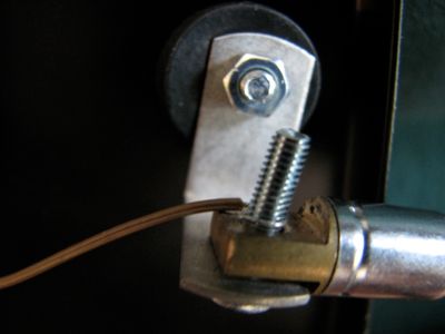

So the electronics is done, now just mounting it to the stand - there are many methods for doing this, and you may want to put your electronics in a protective box, etc....
Here are some photos of some of the simplest mounting methods.

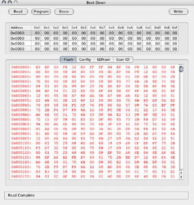

The screenshot below shows the OS X program Boot Down by Craig Schimmel - a Macintosh bootloading utility for the CUI. If you are on windows, the easiest thing is to use Microchip's own tool, PDFSUSB.exe that is downloadable from their website, or included in this example code for the CREATE USB Interface.
To put the CUI in "bootloader mode", hold down the program button and hit the reset button (or just plug in the USB cable while holding the program button down). The CUI's status LED will blink continuously indicating that it is in bootloader mode. Now you can use Boot Down to send the CUIEfieldBootDown.hex file to the CREATE USB Interface.
If you ever want to change the firmware for the CREATE USB Interface back to the original, it is here, and there are other examples of firmware for the CUI here as well.

We use a simple firewire camera (webcam style) mounted on the top of the music stand for optical recognition of physical gestures and gaze detection - If you are interested in the computer vision or audio analysis and synthesis aspects of our group's research, please see the papers at the Multimodal Music Stand website.
