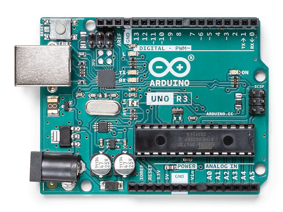

Step 1: Make Custom Circuit Boards
First you are going to need to make the folowing electronic schematic. It would be best to solder it to a pcb, to make it more durable than on a breadboard. Because it needs to be in a table where people are hitting realy hard.
For the pcb it would be best to make the following boards:
  • - power delivery board
  • -board where hall sensors connect to the 3 ADCs
  • -Main motherboard with connectors to lcd, arduino, raspberry pi, gyroscope and all the conectors to the other boards
