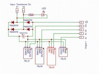

To make this circuit, we use bridge power supply circuit formula, liner voltage regulator and a 12v (3 amp) transformer.

Step 5: Schematics and PCB Design
The schematics of PCBs can be seen above.
Step 6: Circuit Connection – Step 1
To make this SMT multiple power supply circuit, 1st we make a bridge connection with these 4 diode. Then connect diode positive leg with capacitor positive leg and connect diode negative leg with capacitor negative leg.
With this power supply, we also can use a power indicator led light. When the circuit receive power signal, then the led light glow.
We utilize JLCPCB https://jlcpcb.com/RTA to printout our PCB.
Step 7: Circuit Connection – Step 2
Since it is a multiple power supply circuit, for this we need to use liner voltage regulator IC. We connect all liner voltage regulator IC “GND” leg with capacitor negative leg and all Liner voltage regulator “IN” leg with capacitor positive leg.
Now, we just need output voltage.
Step 8: Circuit Connection – Step 3
Now we just add 5 sockets with this circuit. In this 5 sockets, 1 socket will contain “GND” voltage and other sockets will contain DC 3, 5, 9 and 12 volt.
Our circuit is now, completely ready for use. Just plug-in transformer with input leg of PCB and use your needed voltage from this circuit.
