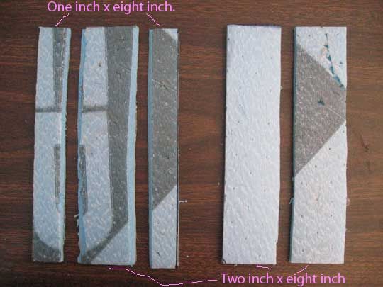

Cut two 1 inch by 8 pieces of foam.
Then cut three 2 inch by 8 pieces.
The 1 inch by 8 pieces of foam are used to hold together the vertical structure.
The 2 inch by 8 pieces are used for the vertical structure they also hold the motor.

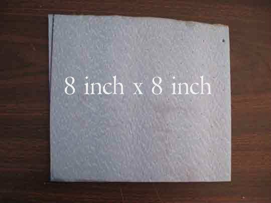

Cut one 8 inch by 8 inch piece of foam. this will be used for the base.

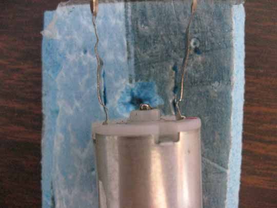

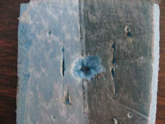

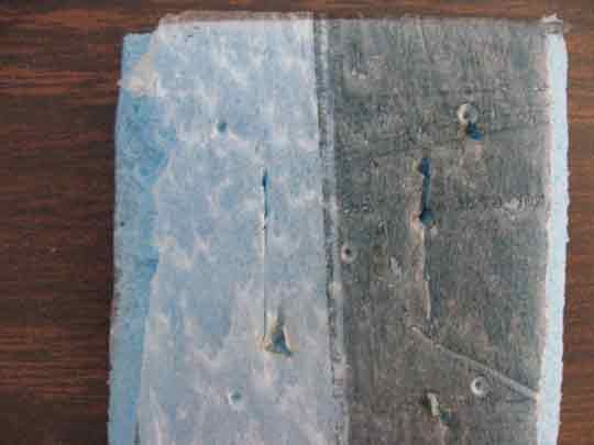

1: Prep The First Layer.

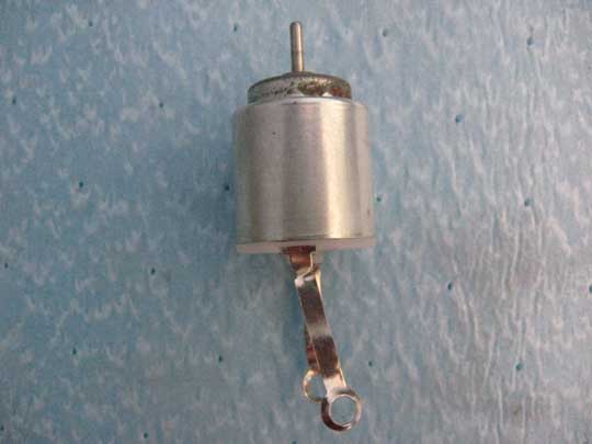

Take a two inch by eight inch piece of foam and cut two slots the same distance apart as the leads on the motor and one and a half inches from the end of the foam.
Then cut a hole in between the two slots to accommodate the shaft of the motor.

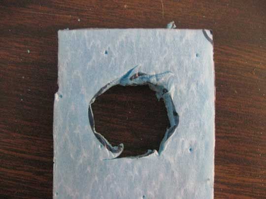

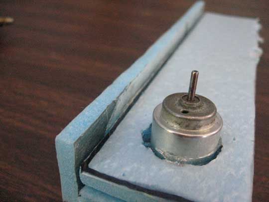

2: Prep The Secant Layer.

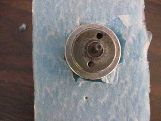

Take a two inch by eight inch piece of foam and cut a hole one and a half inches from the end of the foam and a diameter slightly larger then that of the motor.
3: Prep The Third Layer.
The third layer is exactly like the secant layer.

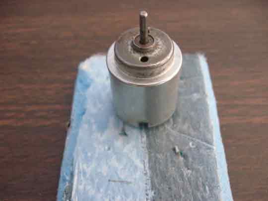

4: Installing The Motor.

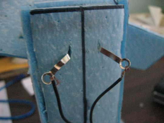

Slip the leads of the motor threw the slots made in 1 and glue the motor in place.

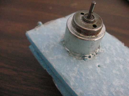

5: Installing The Secant And Third Layers
Apply glue to one side of the secant layer and place it on the first layer remembering to place the hole in the foam over the motor
The next layer is the same.
After this apply glue around the motor
6: Gluing The Side Struts In Place.
Glue the struts on to the sides of the three layers
This raps up the motor assembly.

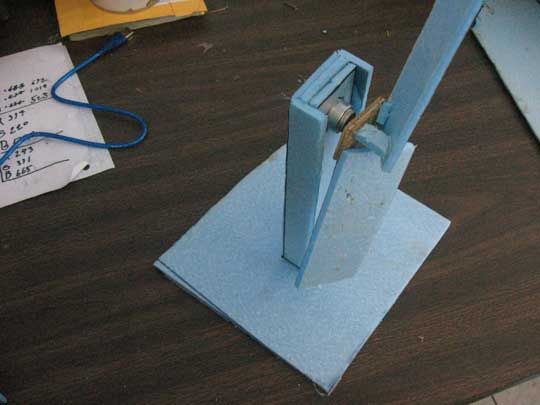

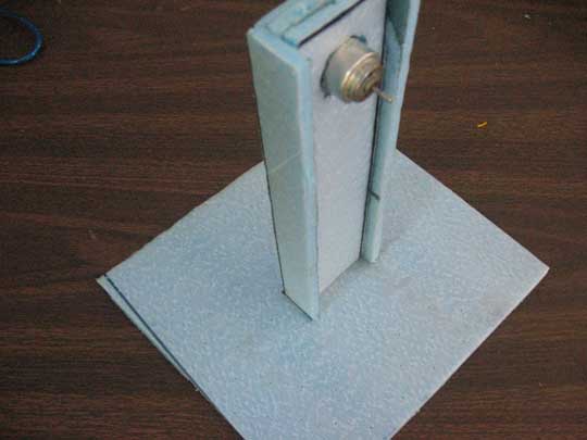

7: Glue The Motor Assembly To The base.
Glue the motor assembly to the center of the base

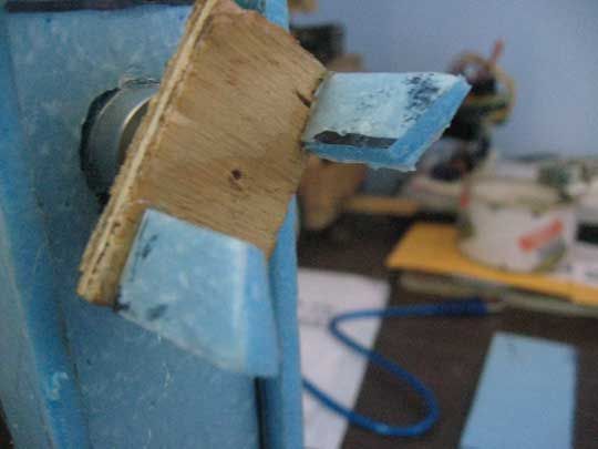

Step 3: Making the Fan
The fan consist of a ply wood mounting and foam blades. now let's built it!

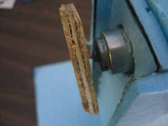

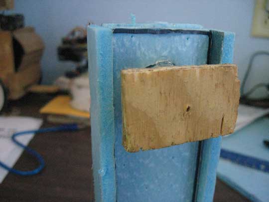

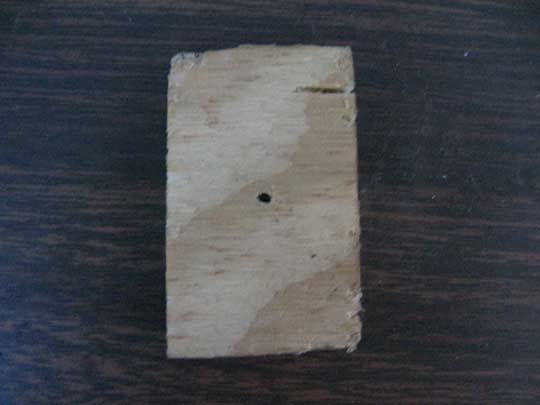

1: The Plywood Backing
Cut a piece of plywood one inch wide by two inches high
Then use the finishing nail and hammer to punch a hole in the center of the plywood
Push the hole in the plywood over the motor shaft.

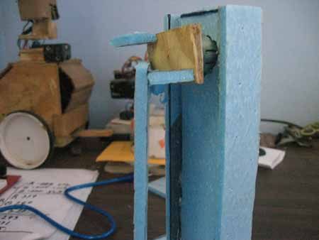

2: Cutting The Blades And Blade Supports

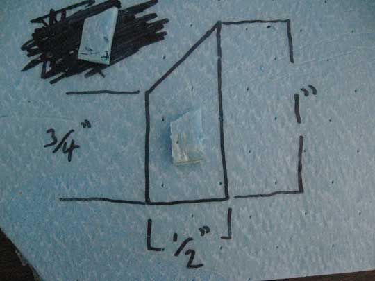

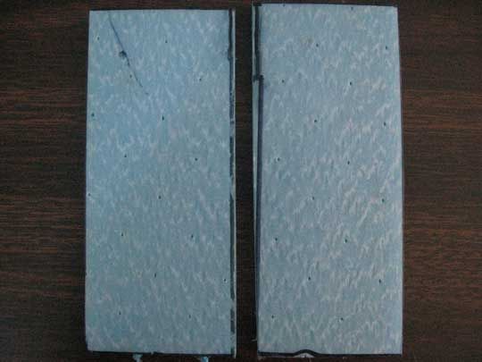

Cut two, two inch by five inch pieces of foam these will be the blades.

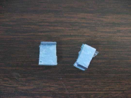

Then cut two small 1/4 inch squares of foam.
Last cut a piece of foam as described in the photo below these are used to support the fan blades at a angle .
3: Assembling The Fan
Glue the support pieces you made in the last secession to the plywood backing refer to the photo below.
Glue the blades on to the support pieces and the plywood backing as in the photos below.
Repeat with the other blade.
Next apply glue to the small pieces of foam you cut erlere and wedge them in between the plywood and the fan blade like in the photo above.
that's it for the fan!

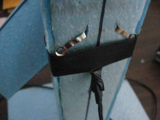

1: Cutting The Connecter Off The Wall Wart.
Cut the connecter off the wall wart and strip the wires
2: Connecting The Wall Wart To The Motor.
Rap the wall warts wires around the wires on the motor. then test the motor with the fan on. If the fan turns in the wrong direction then swop the wires on the motor.
3: Raping The Wires In Tape.
Rap the wires in tape as in the photo below.

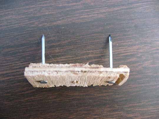

Step 5: Making the Rotary Art Attachment
Now we are going to make a attachment.

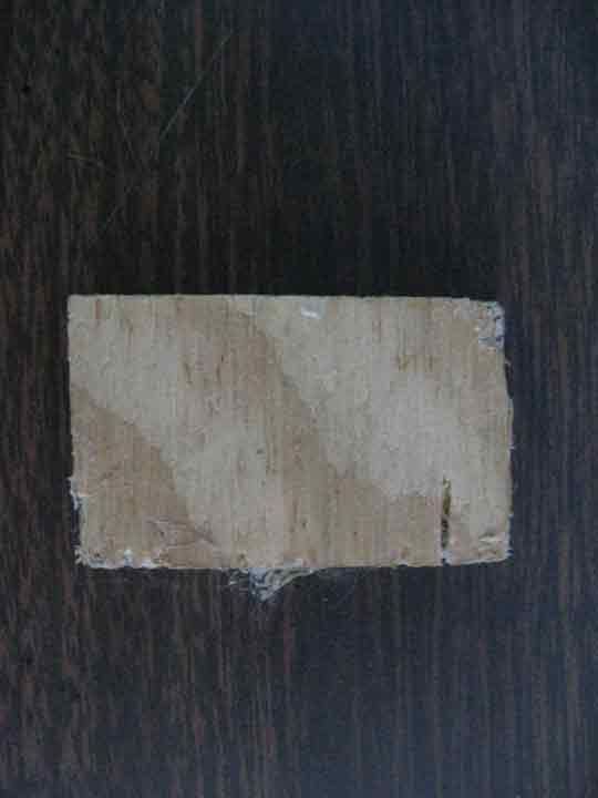

1: Cutting The Plywood Backing
Cut a piece of plywood 2 inches by 1/2 inch. Then use a finishing nail to make a hole in the center of the plywood by pounding the nail in then pulling it back out.
2: Adding Nail's To The Plywood Backing.
Using the hamer drive two finishing nial's into the plywood backing as in the photograph below.
And that is how to make the rotary art attachment.
3: Using The Rotary Art Attachment
Press the art attachment on to the motor shaft.
Cut a round piece of foam and stab it on to the nails. then plug the wall wart in and using a sharpie marker draw on the foam then try using cardboard and other materials! Experiment!
