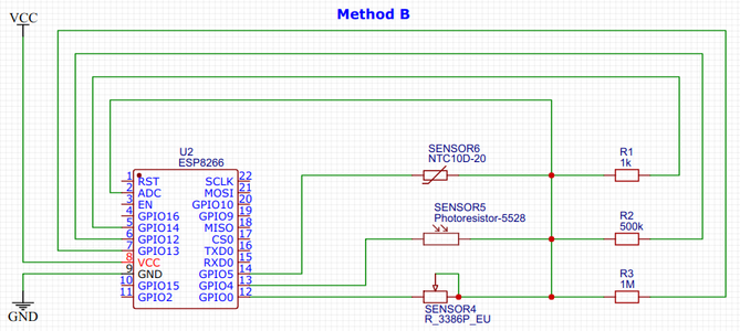

Unlike ESP32, ESP8266 has only one A0 analog input port, so is it possible to read analog input from multiple resistive sensor probes? The answer is YES. @breagan22 has provided a workable solution by adding diodes for current isolation. However, that method requires additional electronic components. In this tutorial, we claim that under the condition that all sensor probes are resistive in nature and are not too far away from the common range of 10K-300K, it is possible to use a more elegant solution without using any additional electronic components (Method A), not even the voltage-divider resistor that is connected in series to each sensor probe.

Step 5: Limitation and Conclusion
In Method A, since A0 is directly connected to the 1st pin of all sensor probes, the effective voltage-divider resistor that is connected in series to all sensors, is the same as the INPUT_PULLUP internal resistance (that is 30K-100K). Since different chips, different ports have different INPUT_PULLUP internal resistance, you need to calibrate every sensor output value on each device. In conclusion, using this way of multiplexing, you need (N+2) ports (including A0) for N sensors in total.
In the application scenario where different sensor probes requires very different voltage-divider resistor (or far away from the 10K-300K resistance range), then you have to adopt Method B, where you need (N*2+1) ports (including A0) for N sensors in total. The principle is the same except that you need to respectively digitalWrite(HIGH) and pinMode(OUTPUT_OPEN_DRAIN) for the sensor you select and set all other ports as INPUT, each time you access one specific sensor. Method B also requires less calibration because all sensor probes and voltage-divider resistors have fixed and known resistance.
