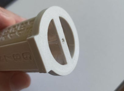

Gently bend the contacts into the hook shape of the LED strip and insert it into the lock.
Step 3:
Insert the lock into the top lid.
Step 4:
Check the operation of the LED strip.
Step 5:
Connect the top lid, table and multiplier bar.
Step 6:
At the bottom, hook the LED ribbon with a hook.
Step 7:
Thread the hook through the bottom lid and join everything together, you can drop a little glue if necessary. After that, cut off the excess part of the hook.
