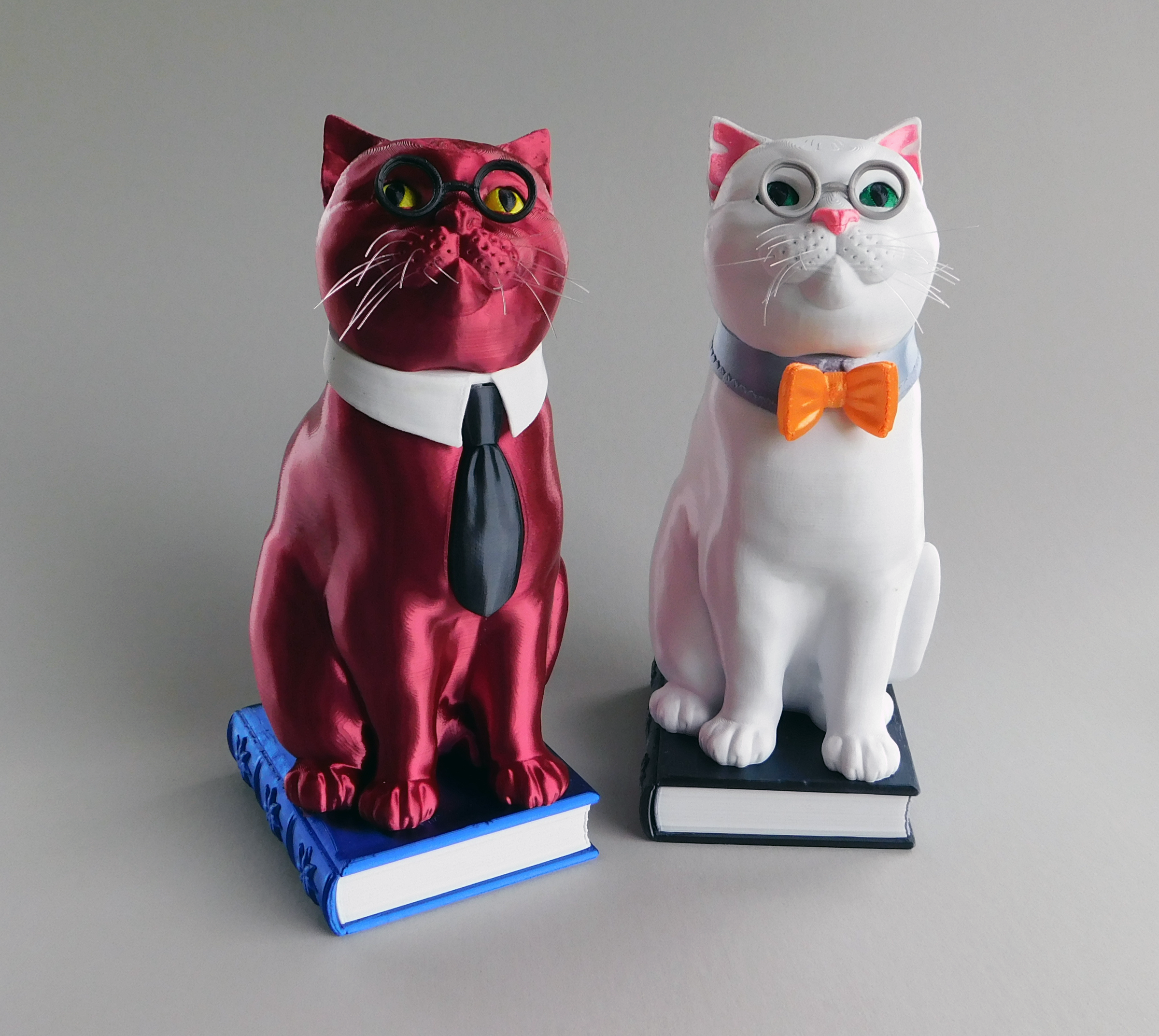

Introduction: Murphy the Library Cat (with Secret Book Box) Assembly Instructions
Murphy the Library Cat is a derivative of my original 3D printed cat model "Shrodinky: British Shorthair in a box":
Unlike the Schrodinky models, Murphy is not a money box. Instead, he sits on a book which happens to be a secret box: it's lid held in place by magnets. He also wears a pair of spectacles (printed in Flex filament) and wears a shirt collar and tie. Originally, Murphy was not published and was used by me as a gift for friends and family only. However, when I took him to MRRF(Midwest Rerap Festival ), he proved very popular with many requests to make him available to the public, so I decided to do just that. Incidentally, that is where his name comes from: MRRF = Murphy.
Murphy has a choice of a plain shirt collar and standard British style school tie or a fancy collar with a bow tie. Due to the way these are designed, the collars and ties are not interchangeable.

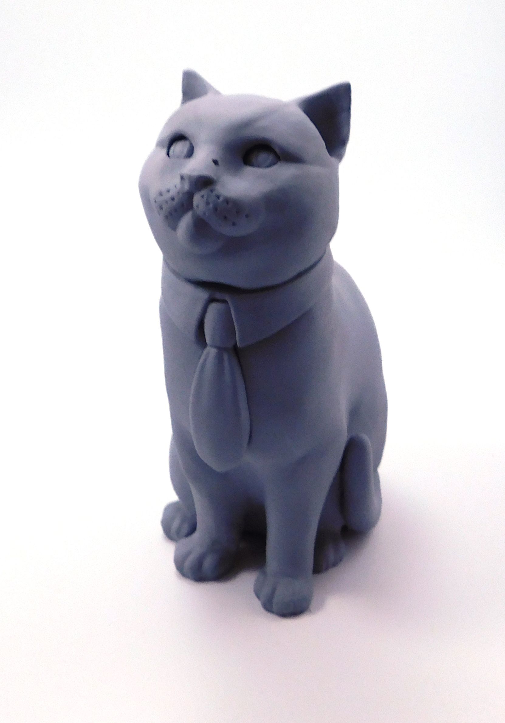

Murphy is available in both single and multi material versions. this way, nobody has to miss out

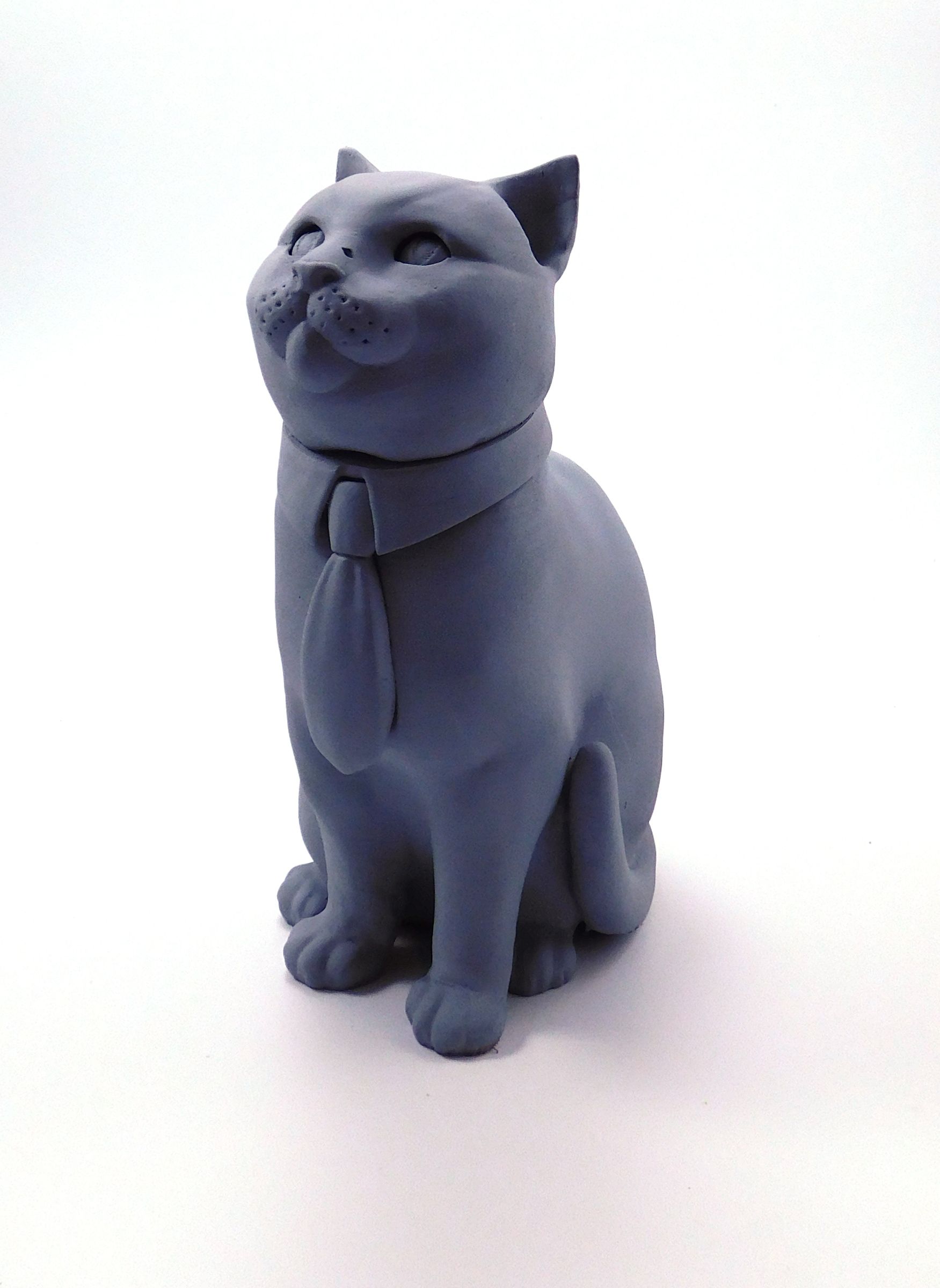

Fully assembled, he is 250mm tall
The largest model in the Murphy assembly is the cat body, the dimensions are:
length: 109mm, width: 138mm, height: 160mm
If your printer can accommodate this then you are good to go!

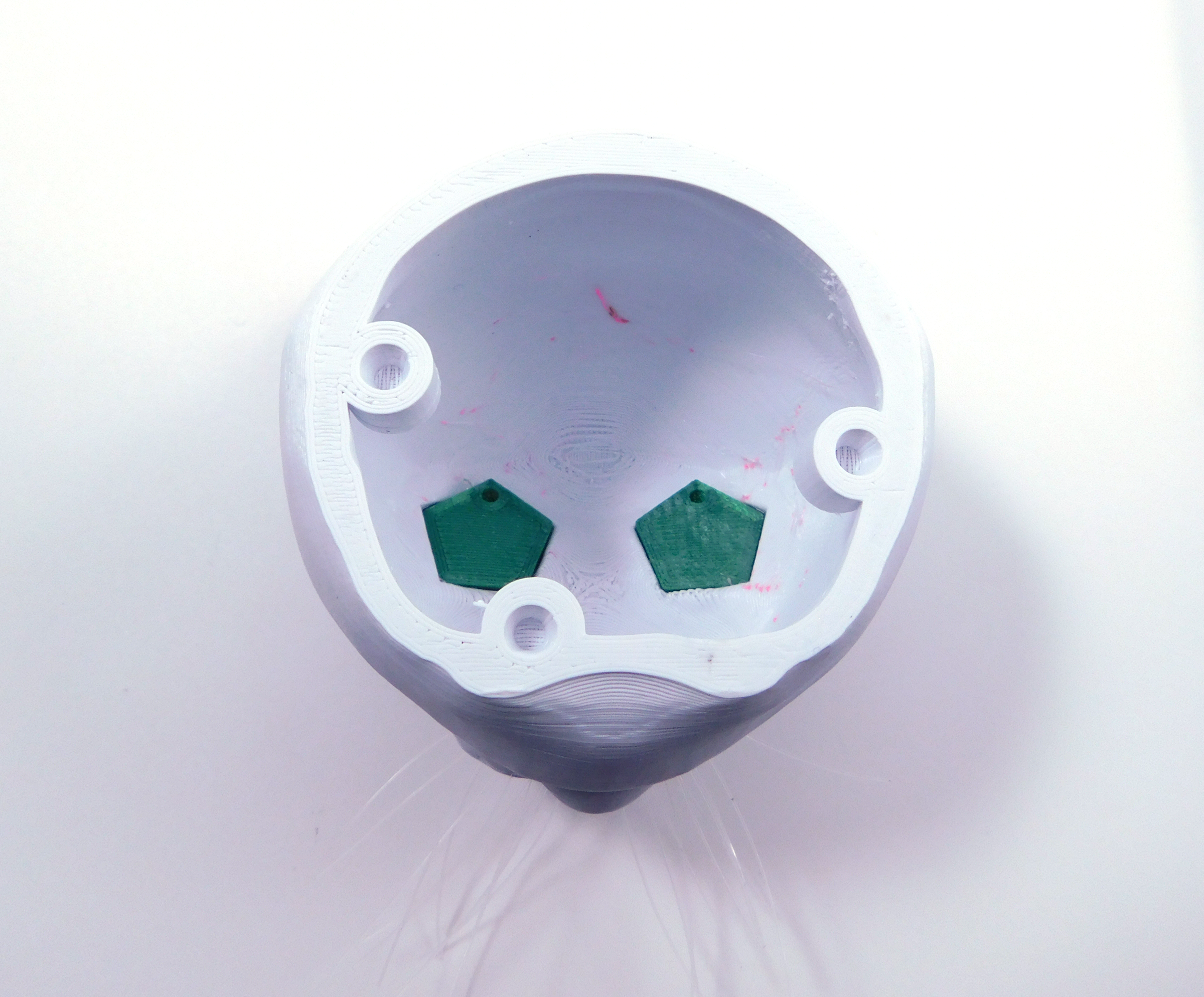

Step 3: Model Assembly: Fitting the Eyes
This is pretty much lifted from my other cat document but I thought it more convenient if I just fold it in here..
You will need printed:
- 2 x eye models
- 1 x cat head model
- Glue

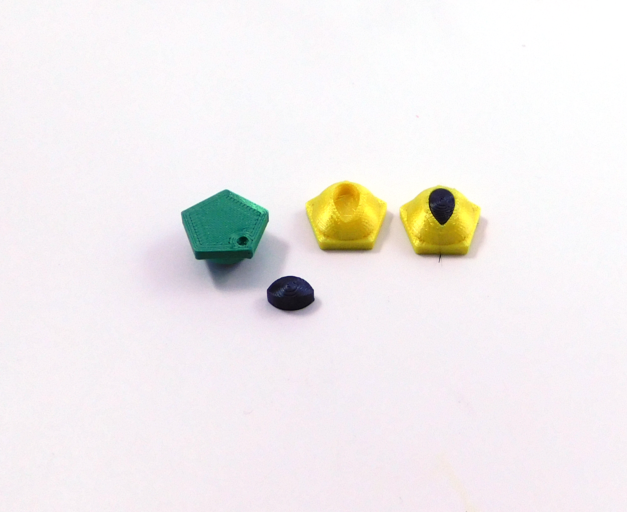

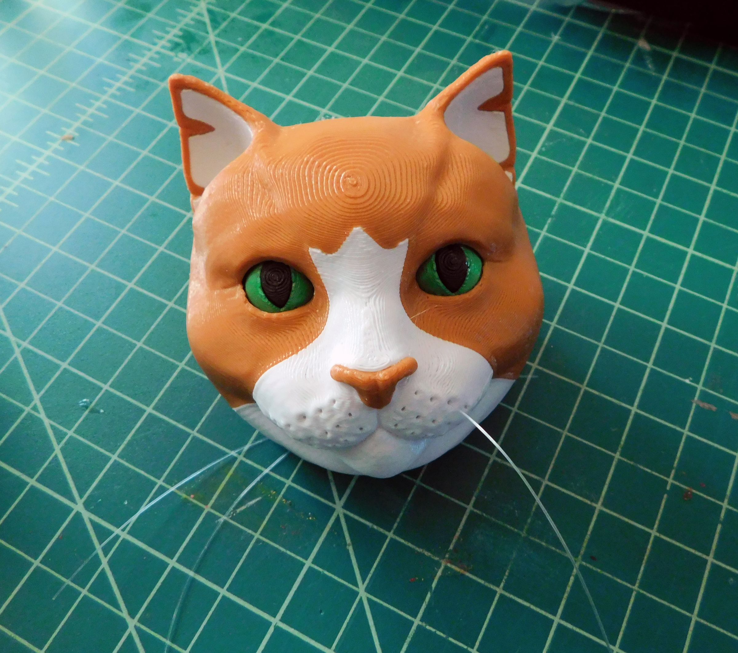

(If you are using the single extrusion eye models, you will need to snap the pupil into the eye. It should fit snugly, but if not, use a little glue).
- Put a little glue in the eye sockets and then fit the eyes into the head.
- Each eye has a pentagon backing which fits into a corresponding socket in the head. To further ensure correct orientation, there is a dot at the top which indicates direction.

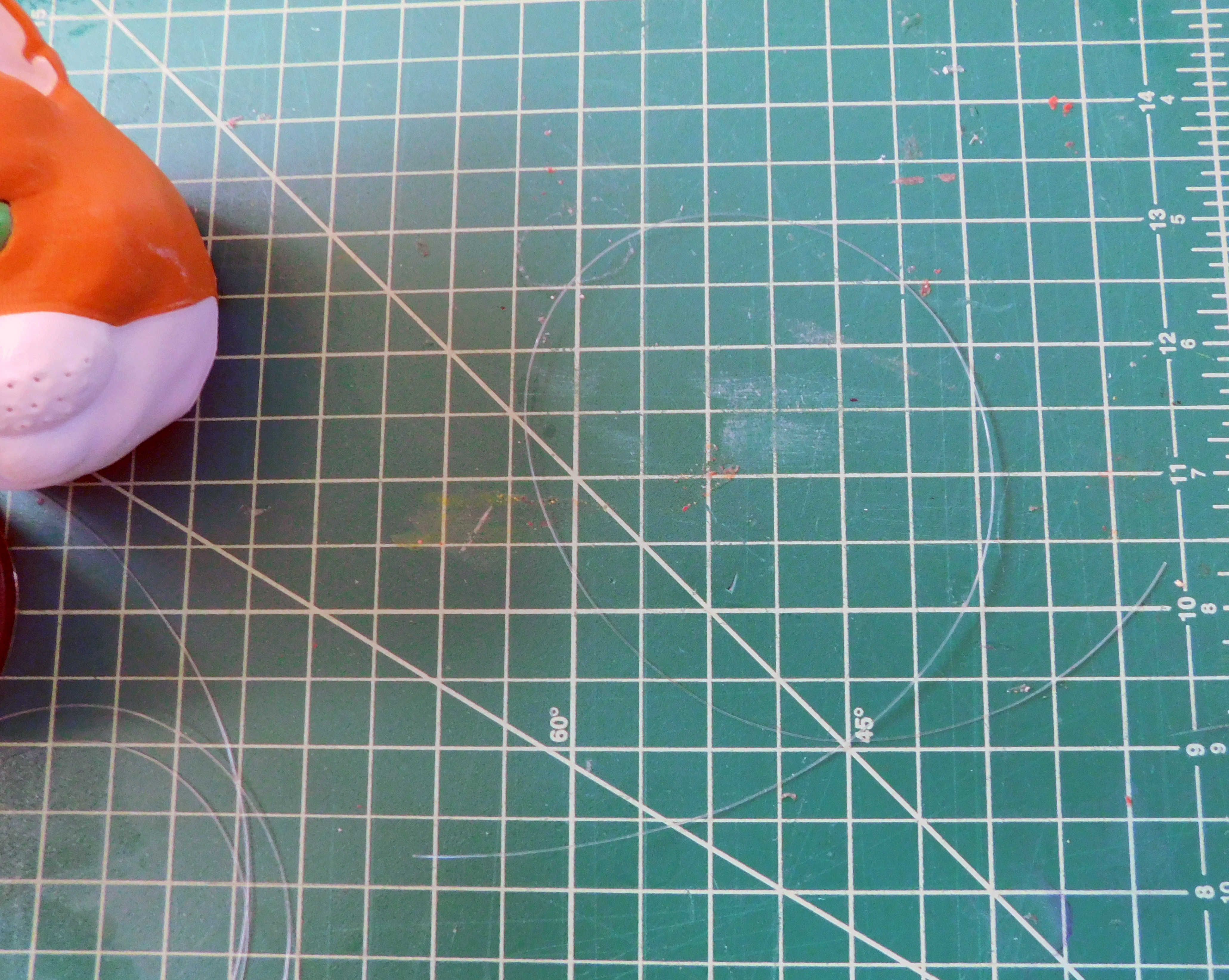

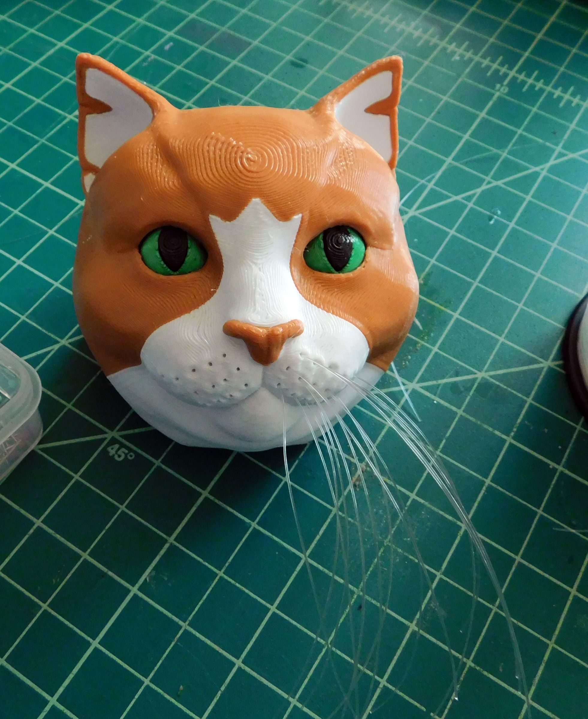

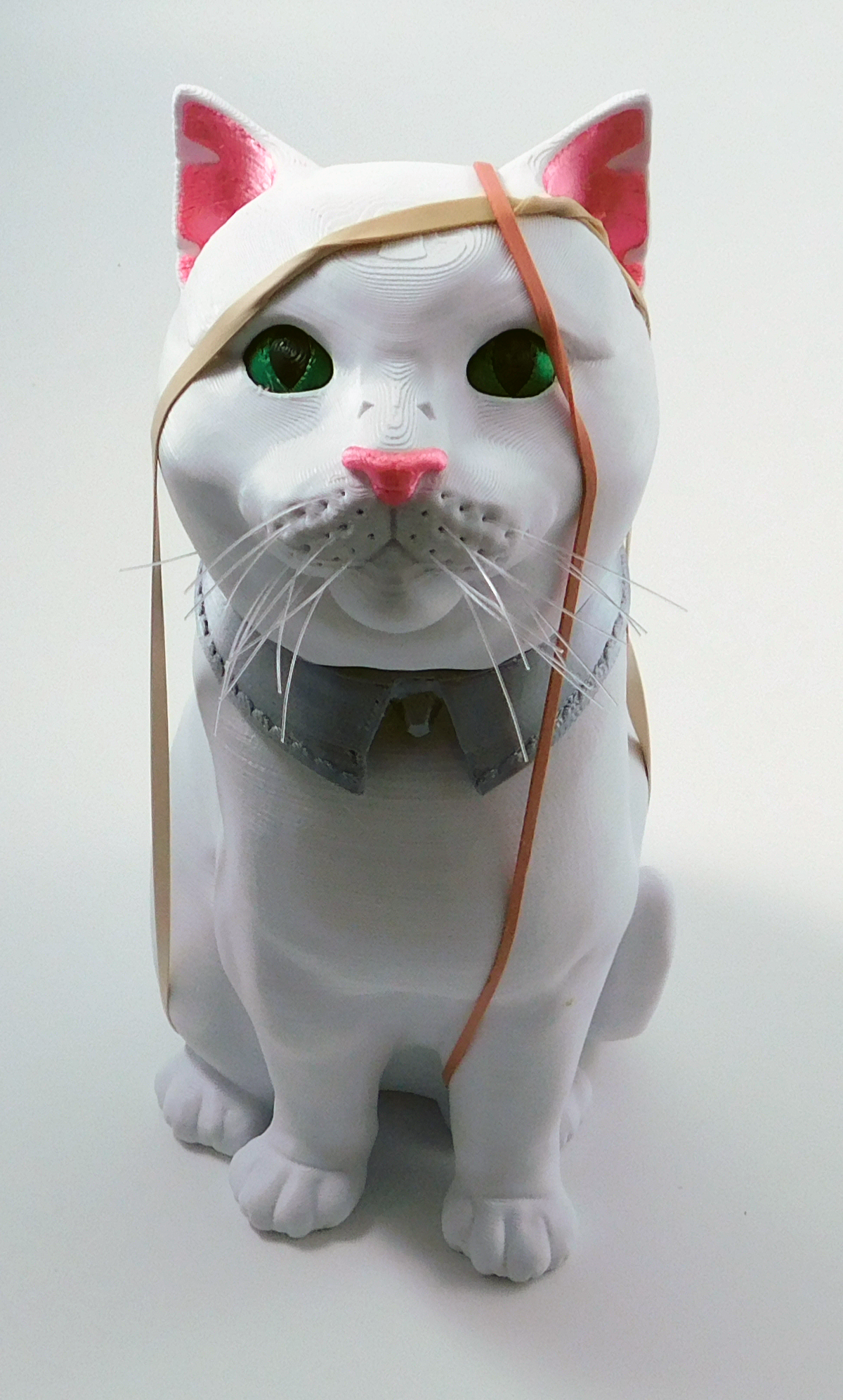

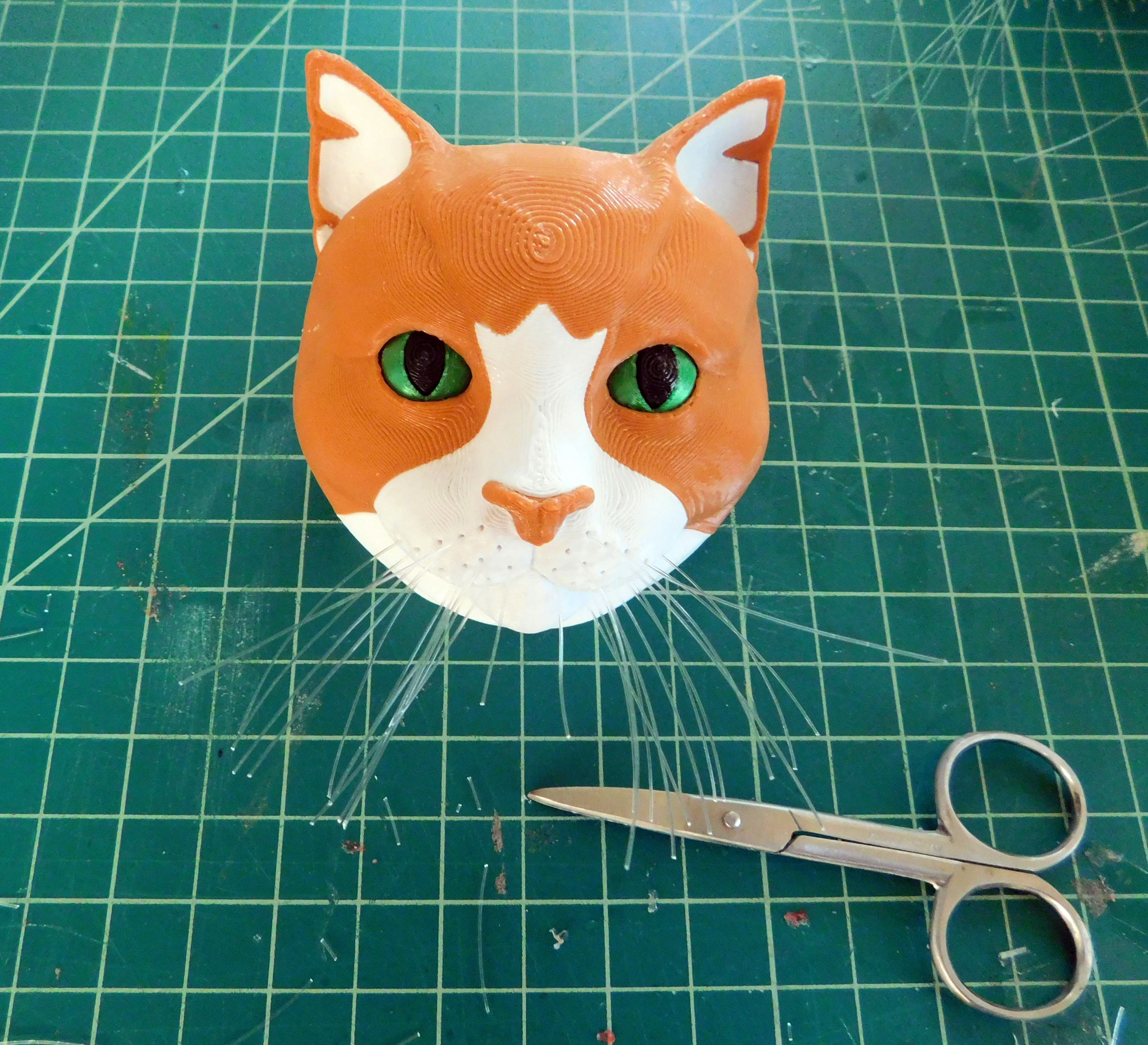

Step 4: Model Assembly: Whiskers
This is pretty much lifted from my other cat document but I thought it more convenient if I just fold it in here..the cat featured here is taken from my other cat models - sorry I was too lazy to repeat taking the pictures...

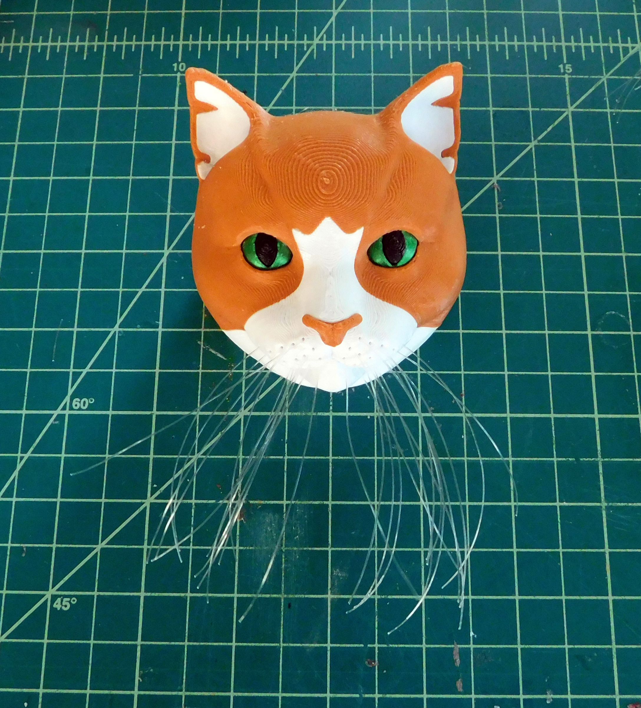

A cat is not a cat without a fine set of whiskers. Many people had wanted to add whiskers to my original Schrodinky models so for this version, I looked to find a solution using materials that were inexpensive, easy to find and effective. After a bit of thinking and testing, I decided upon 12lb fishing line which scales in perfectly. Get the cheapest you can find it will work just as well as more expensive brands. Unfortunately, though I am very happy with the final results, I would be lying if I said this isn't a tedious job but I think it's worth the effort. If you print the cat larger or smaller you may need to use a different diameter of line.
You will need:
- 1 x 3D printed cat head with fitted eyes
- 12lb clear fishing line
- Quick and clear drying glue which can bond the materials you are using
- Small scissors capable of cutting fishing line (I used nail scissors)
- A sewing needle (in case some of the whisker holes are not completely open)
- Cut a piece of fishing longer than the desired whisker length.
- Feed the line through a whisker hole in the front of model's face and tie a knot at the end inside
- Snip any excess line after the knot and then pull the line through from the front of the cat's head until it is stopped by the knot.
- Repeat until you have completed all the whiskers on one side.
- Pull all the whiskers taunt from the front of the model's face with one hand and apply glue to the knots in the inside. Leave to dry.
- Repeat with other side
- Once the whiskers are secure and dry, you can trim them.
If you are not sure how to do this, then look at pictures of cats (the internet has plenty). Cat whiskers are never uniform in length and are often shorter nearer the mouth and the top of the whisker pads.
I recommend using a small pair of scissors because it will be much easier to trim individual whiskers.

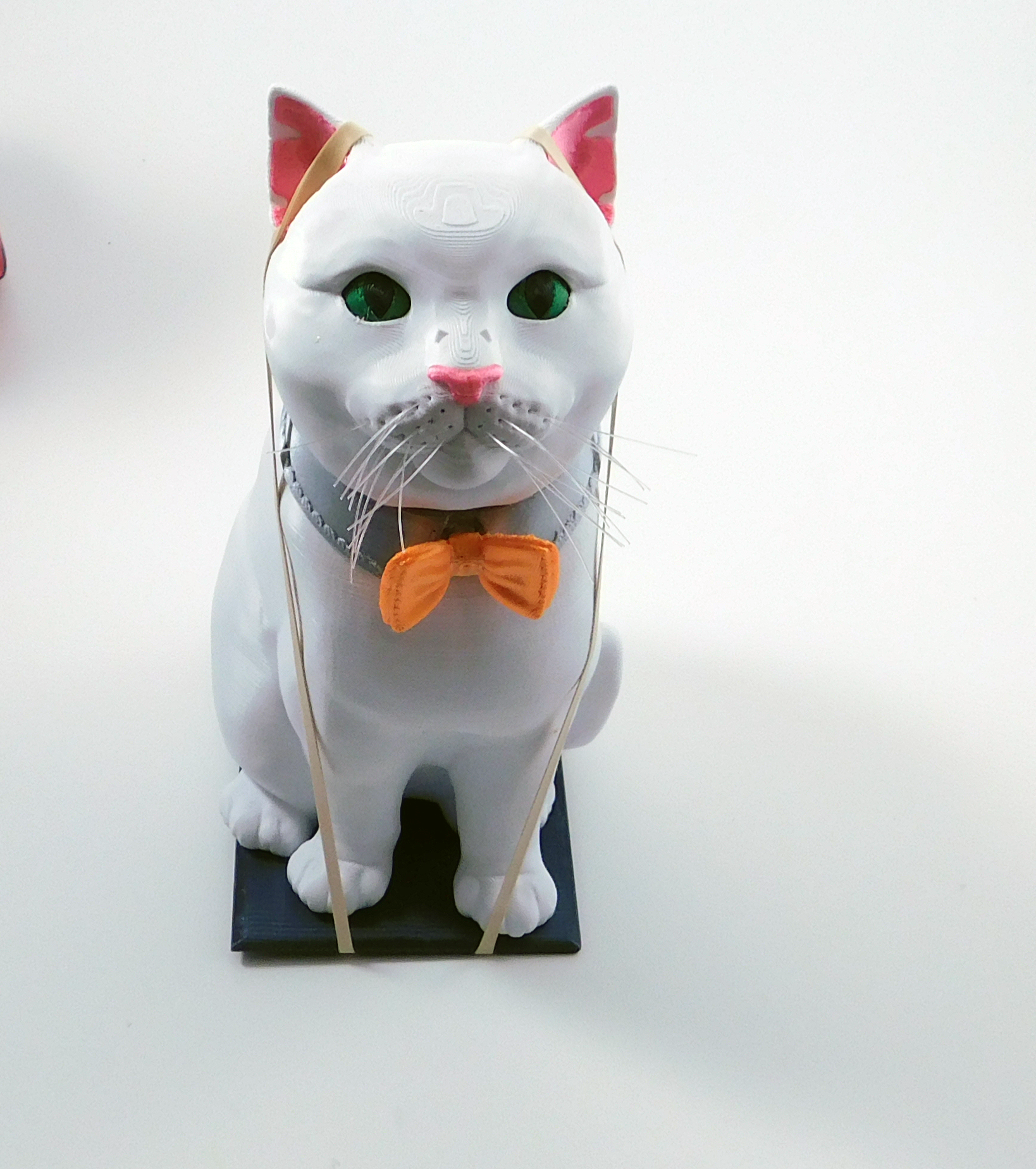

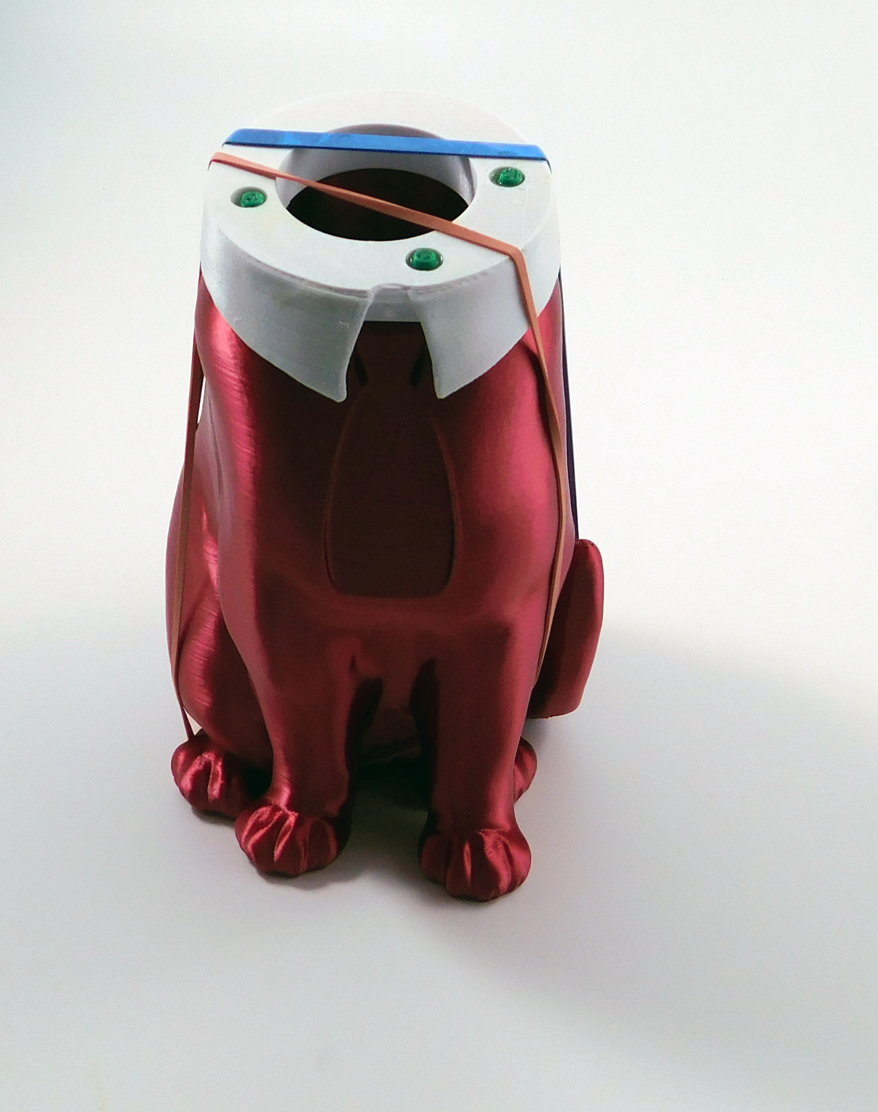

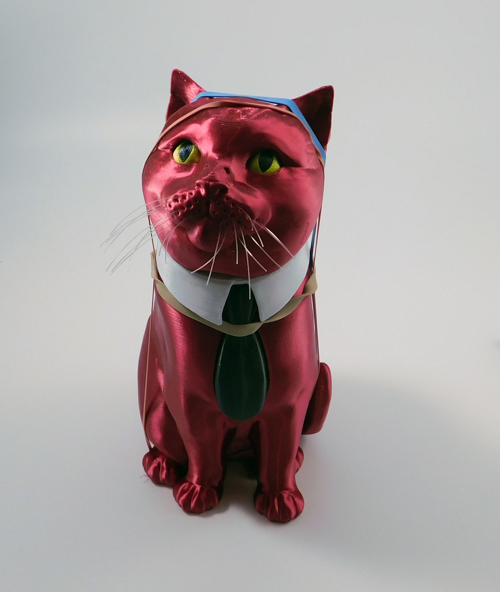

Step 5: Model Assembly: the Cat
You will need:
- 1 x printed cat head fitted eyes and (if desired) whiskers
- 1 x cat body which matches the tie of your choice
- 3 x neck pegs
- 1 x shirt collar which matches the tie and body type
- 1 x tie matching the collar and body type
- Clear drying glue which bonds the materials used
- Elastic bands

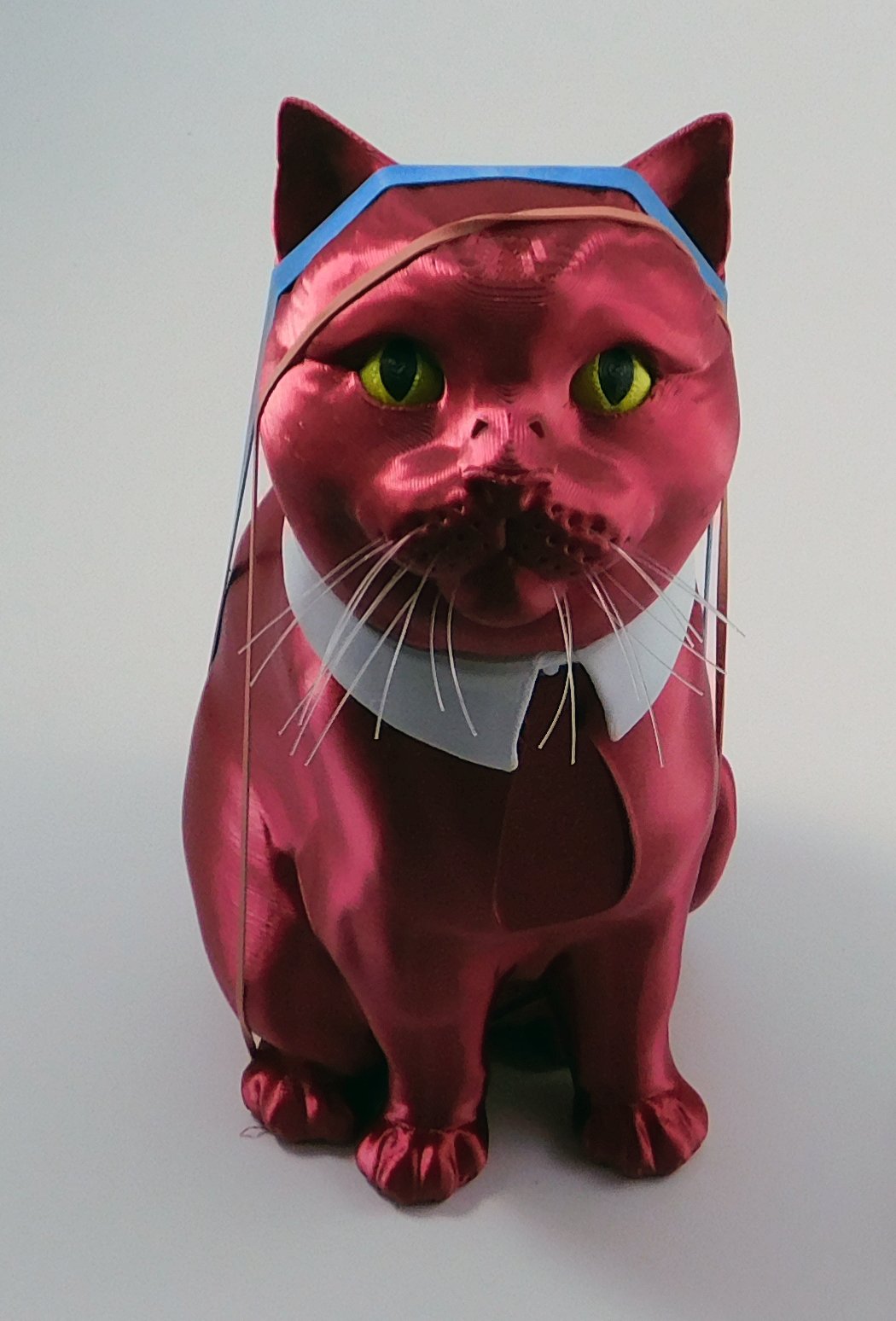

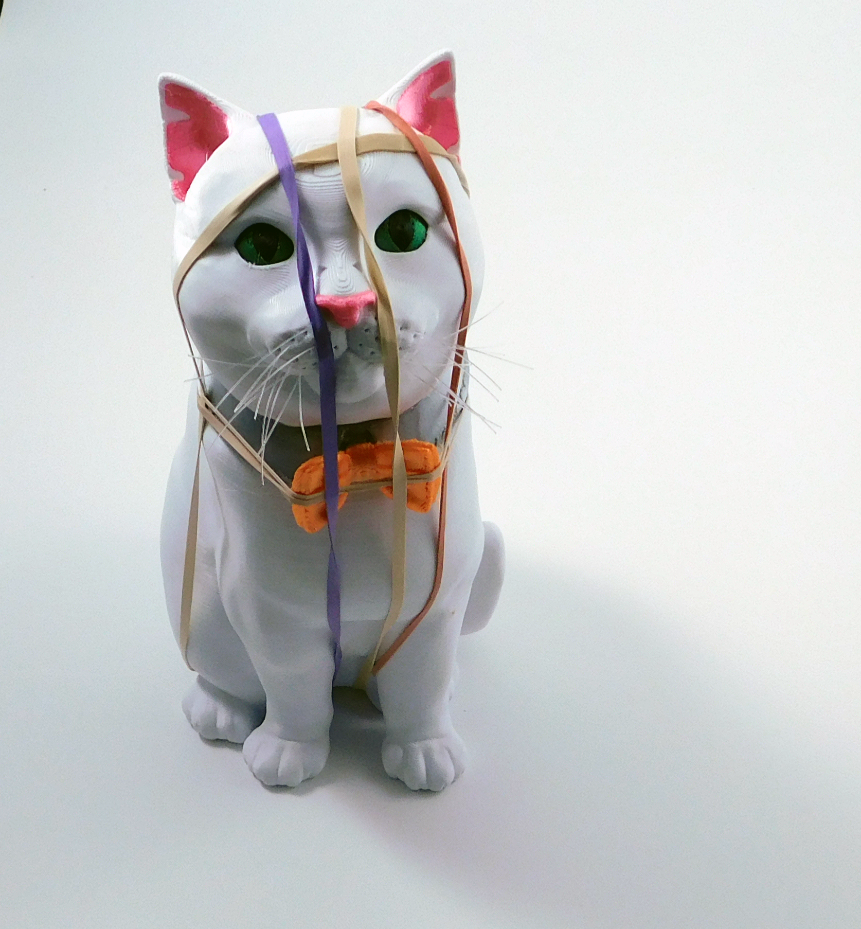

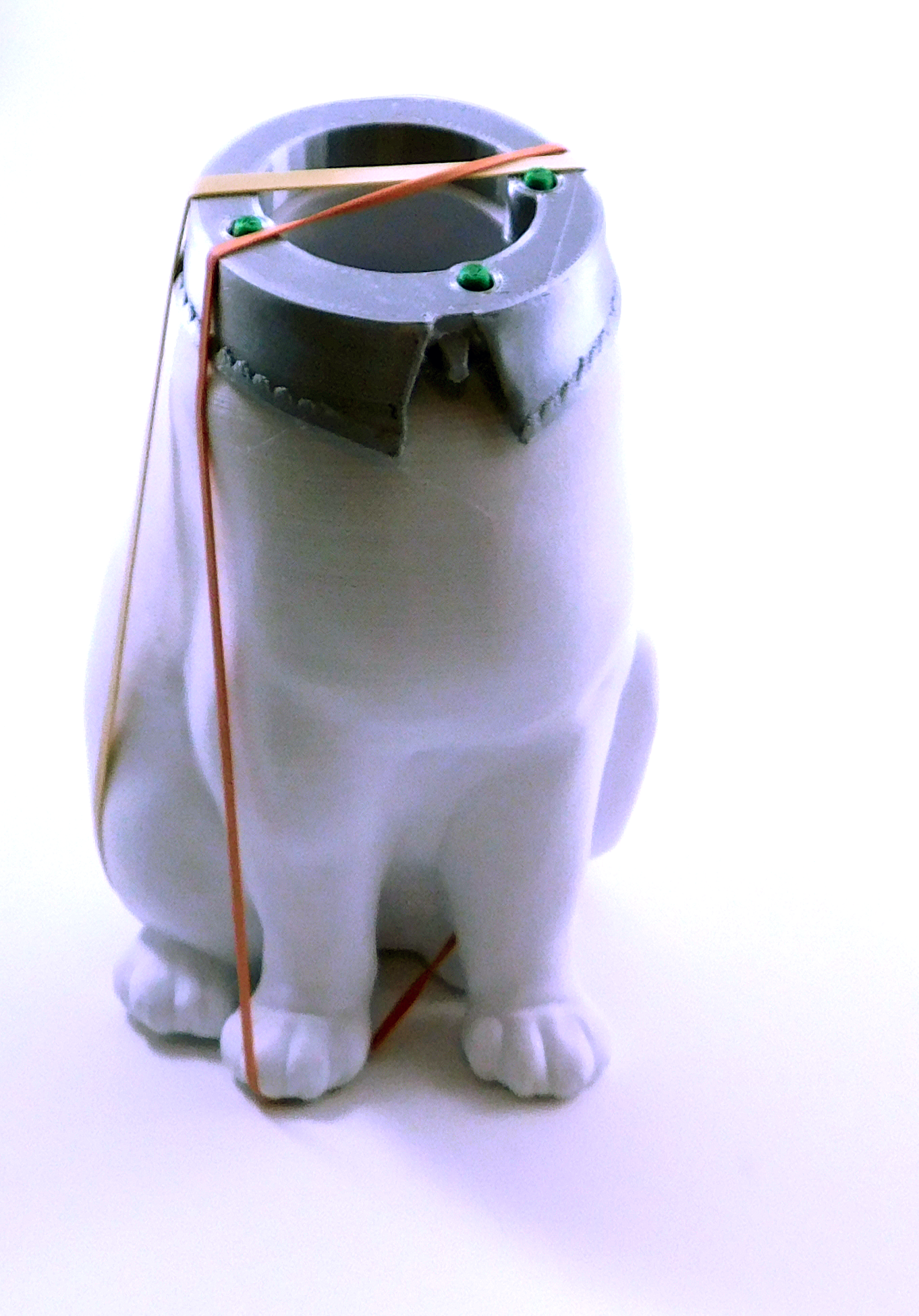

- Take the printed collar and fit the pegs into the holes as shown. These will act as registers to ensure your cat head fits in place.
- Glue the collar to the body (there are pegs already in the cat body neck for you to use that match holes in the base of the collar. Use elastic bands to hold everything in place to dry. I have provided pictures of both body and collar types:
Wait until it has dried - Use the registers in the neck to position and glue your cat head. This can be varied somewhat as shown. Use bands to hold the head in place whilst it dries:
Once the head has been sitting in place for a while, the tie can be added on and secured with bands in addition:
Once the glue has had time to dry well. Remove the bands.

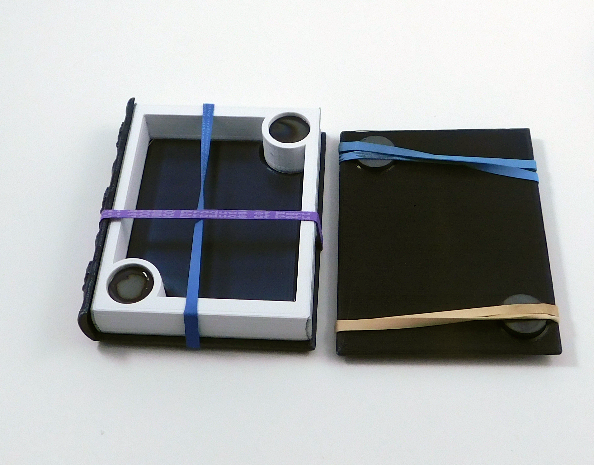

Step 6: Model Assembly: Book and Cat
You will need:
- Book pages
- Book base and spine
- Book cover
- 4 x magnets
- Glue
- Elastic bands

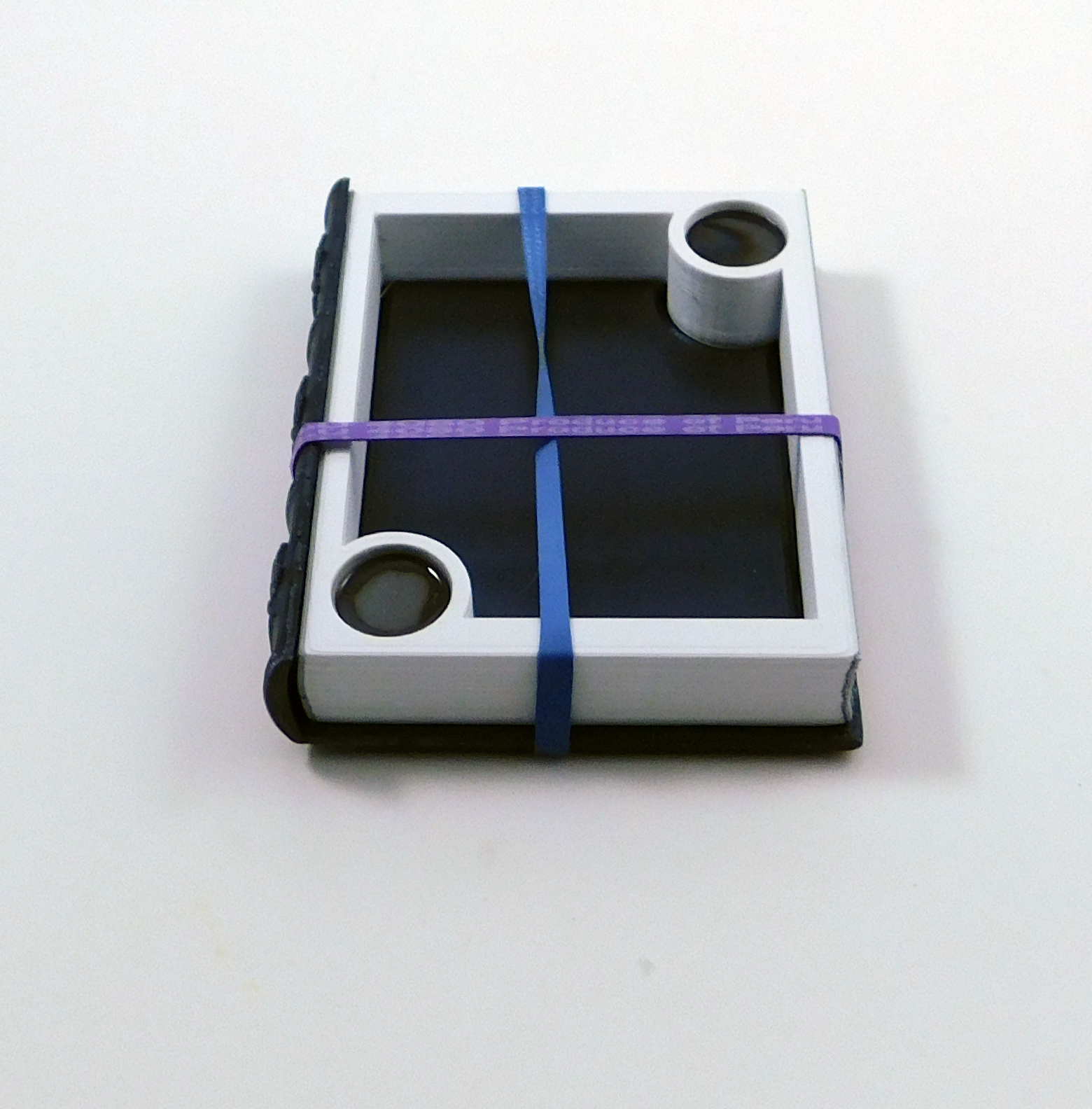

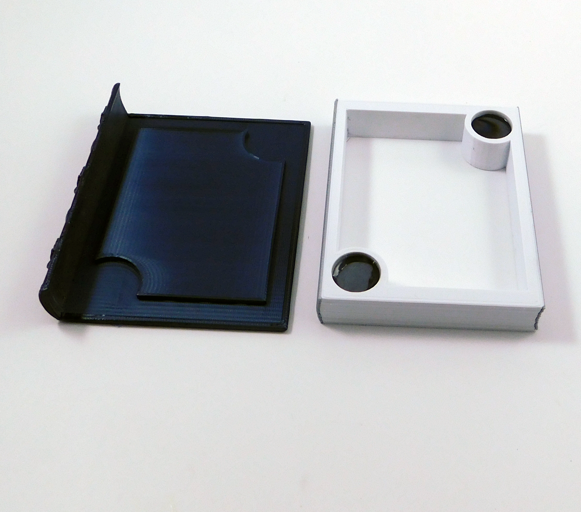

- Arrange the magnets in matched pairs. Glue one of each pair of magnets into the holes in the pages of the book
- Glue the pages into the Book base and secure with bands and wait for it to dry.
- Glue the remaining magnets into the matching sockets on the book cover and secure with bands until they are firmly dried in place

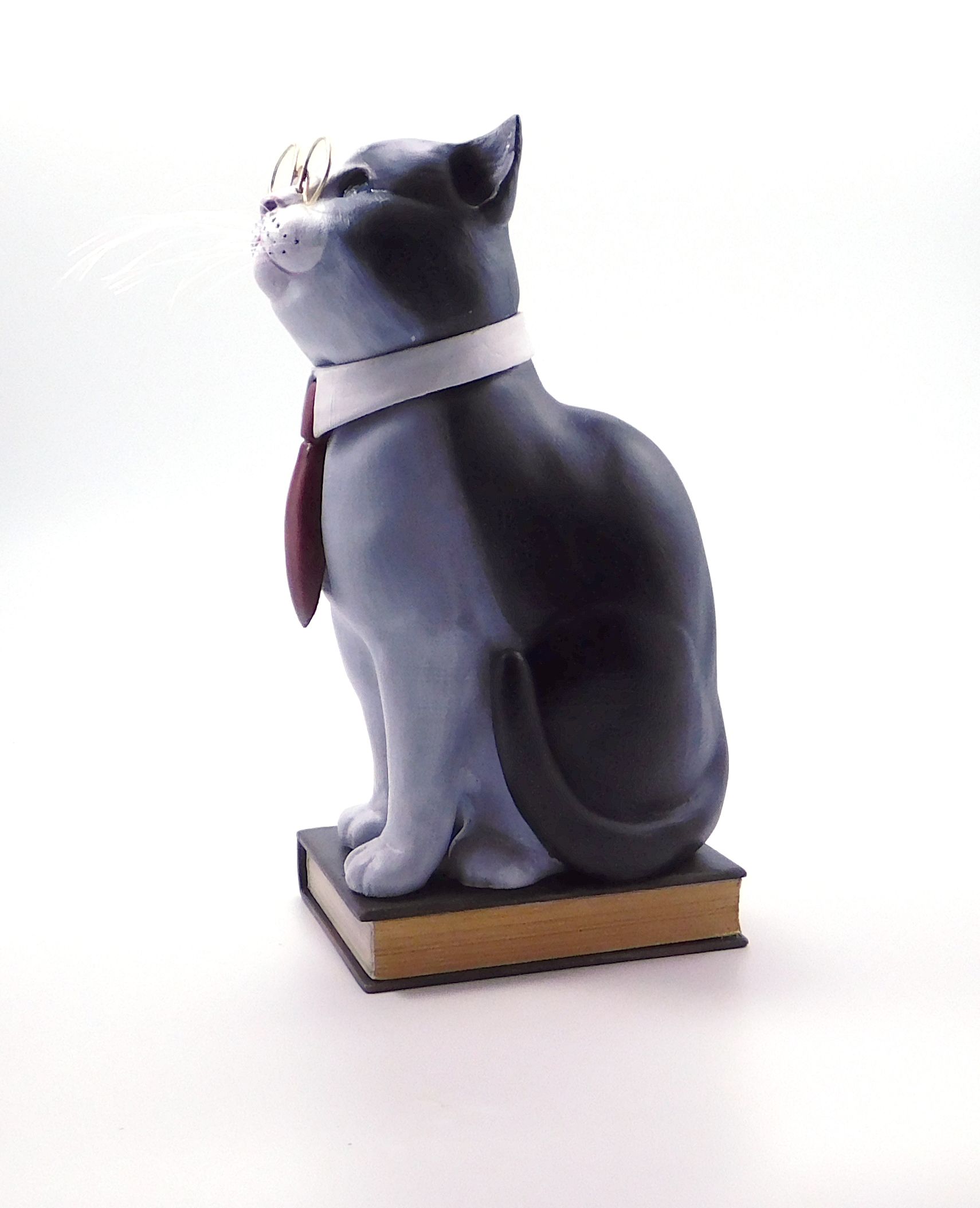

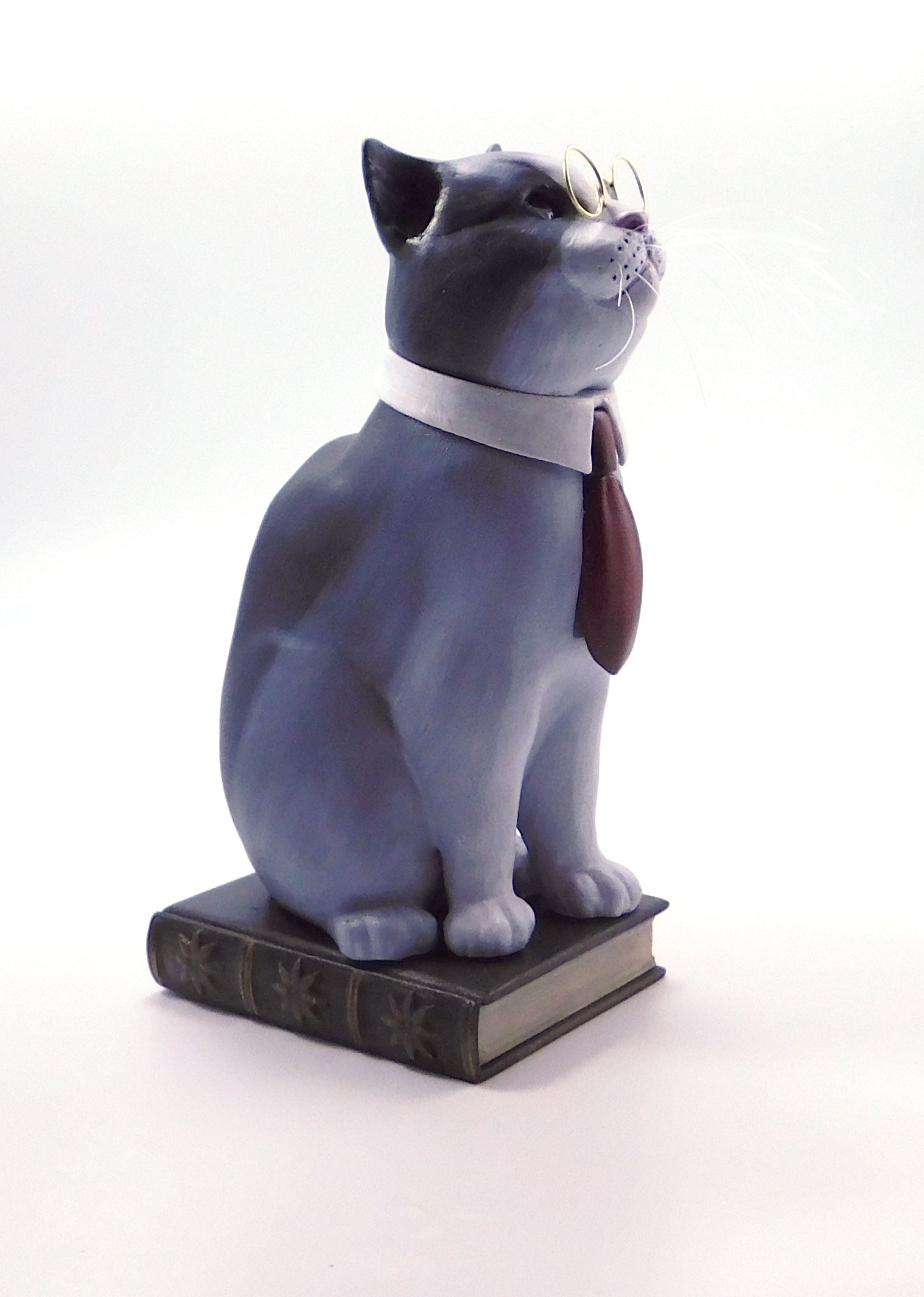

- Take the cat model and glue it to the cover using the holes in the cat's feet and the registers on the book cover. Use bands to hold the model together whilst it dries:
- Fix the glasses on his nose (do not glue - they will pinch into place) and put it all together. You've finished!!!
