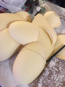

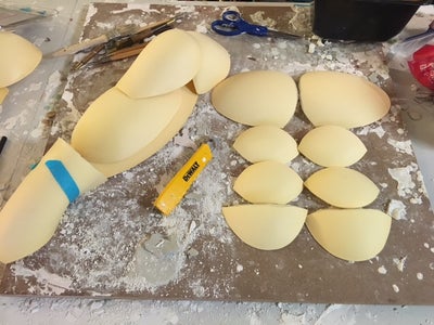

Step 1: Fabulous Fit and Sculpting Muscle
I decided to not start completely from scratch. There's a company called Fabulous Fit that creates padding for sewing forms. I purchased one of these and modified the pads to fit my needs.
I used the four bra inserts as abs.
I used the two hip pads, cutting them to look like pectoral muscles and bottom abdominals.
I used the butt pads to form the biceps.
I used the shoulder pads layered to create forearm and upper arm muscles.
I used the back pads to cut and shape into enlarged back muscles.
I assembled them on a table to map out where I would place them.

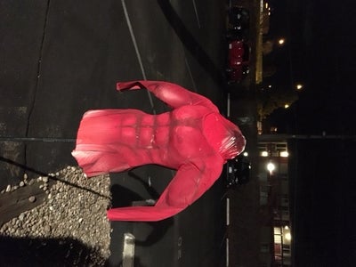

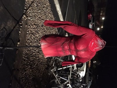

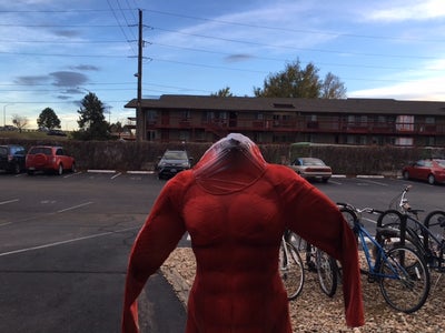

Step 6: Painting the Suit
I let the foam pads dry thoroughly. I turned the suit inside out. I sprayed the suit with aerosol red fabric paint I purchased at Joann's. I then took black and white fabric paint with a brush and highlighted the muscles and shaded in between. I used another layer of red aerosol fabric paint to blend the look together.

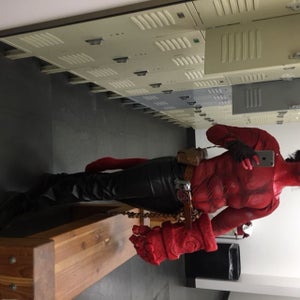

Step 7: Completing Your Look
I used silicone psycho paint from Smooth-On to paint the skin exposed from the suit red. The suit was incredibly comfortable and didn't get too hot.
