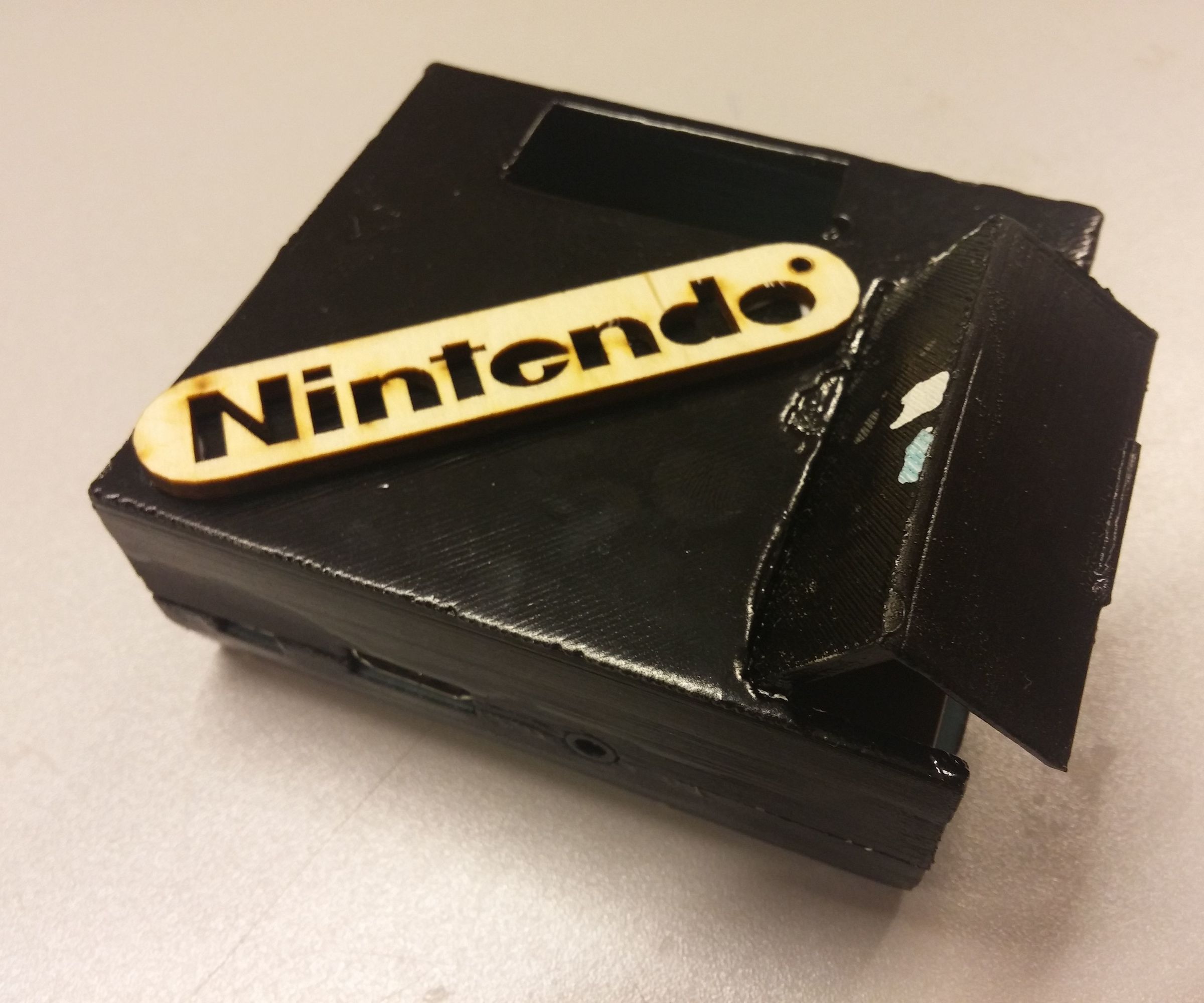

The hardware prototype is based on a Raspberry Pi 3 Model B in a 3D printed enclosure that is running a NodeJS server with a REACT frontend that synchronizes the pulses from the users' muscles.

Step 4: 3D Printing
All of the casings that were designed for this prototype are available in STL format and have been printed on an Ultimaker 2+ and Ultimaker 2Go in high detail.
There are 4 STL files:
  • Main case
  • Main case lid
  • Sensor case
  • Sensor case lid
