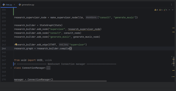

Step 6: Backend: Agents
All agents are implemented via Chaingraph, and the model I used in this case is DeepSeek.
There are three agents to manage different tasks. uperviso_agent is the "manager" note, responsible for dynamically allocating tasks to different agents (consult_agent or generate_music_agent) according to the current state of conversation (like whether detected emotion, or whether generated music). Furthermore, consult_agent is used to detect emotion and music preference using the capability of Deepseek, and generate_music_agent is used to generate the musical contents used later. Once sufficient data is obtained, the backend will generate the planet's parameters based on the respective preset and push that data back to the frontend.
To manage the communication between the agents, we used StateGraph, and we used the Command object to transfer the states between the agents to decide the next action, allowing multi-agent cooperation.
