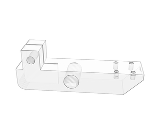

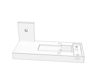

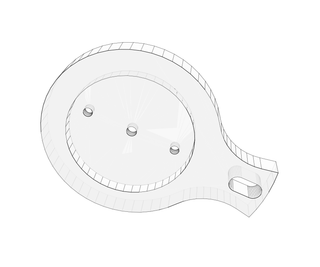

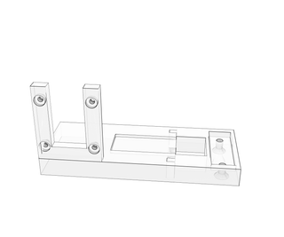

3D Print (in italics) or order the following printed parts:
- 1 Motor Holder Base Assembly - Active
- 1 Motor Holder Base Assembly - Passive
- 1 Pick Cart
- 2 Dowel Servo Motor Connectors
- 2 Belt Rectangles
Step 4: Assembling the Passive Side
- Attach the pulley to the protruding wall of plastic of the 3D-printed Motor Holder Base Assembly - Passive using the partially threaded screw and an M4 nut. The head of the screw and the pulley itself should face away from the base.
- Screw one of the 3D-printed Dowel Servo Motor Connectors onto one of the servo motors using 2 M1 screws and nuts.
- Screw the servo motor into the base of the Motor Holder Base Assembly - Passive using 2 M3 screws. Then reinforce this connection to the Assembly base by hot gluing around the base of the servo.
- Use 2 Flat Head Socket Cap Screws, M4, 60 mm Length to secure a Linear Rail Shaft Guide/Supports, 8mm diameter to the base. Secure using M4 nuts.
- Adhere the spiky side of velcro to the bottom of the 3D-printed Motor Holder Base Assembly.
Step 5: Assembling the Active Side
- Affix the pulley to the stepper motor's rotating rod; there is a tightening screw on the pulley itself (see the first image).
- Attach the stepper motor to the 2 posts of plastic on the 3D-printed Motor Holder Base Assembly - Active using 4 M3 screws.
- It may be necessary to add two small pieces of felt between the motor and the posts to reduce unwanted noise during strumming. If so, unscrew the M3s and cut out a small piece of felt. Then place it in between the motor and the post and re-screw the motor to the post
- Screw one of the 3D-printed Dowel Servo Motor Connectors onto the other servo motor using 2 M1 screws. Make sure that the two connectors are mirroring one another.
- Screw the servo motor into the base of the Motor Holder Base Assembly - Active using 2 M3 screws. Then reinforce this connection to the Assembly base by hot gluing around the base of the servo.
- Use 2 Flat Head Socket Cap Screws, M4, 60 mm Length to attach one of the Linear Rail Shaft Guide/Supports, 8mm diameter to the base.
Step 6: Build the Pick Cart
- Place the 8 mm bearings into either side of the large hole in the center of the 3D-printed Pick Cart. Secure with a small amount of hot glue around the outside diameter of the flange.
- Place the 1/8 in. bearings into either side of the small hole in the protruding rectangle of the 3D-printed Pick Cart. Secure with a small amount of hot glue around the outside diameter of the flange.
- Secure the pick into the slot in the cart on the side opposite to the protruding rectangle.
- Depending on the thickness of the pick you are using, you may or may not need to use a small amount of hot glue or felt to secure it in place.
