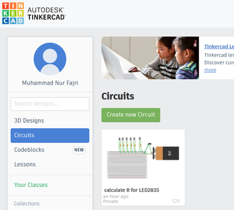

Open your browser, and log in to your Tinkercad account. Then, choose Circuit on menu, and then click on the Create new circuit button.

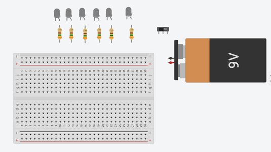

Step 2: Prepare the Components
Prepare your components on the workspace like Breadboard mini, resistors, LED, Battery 9v, and switch. You can browse all those components in the Search box.

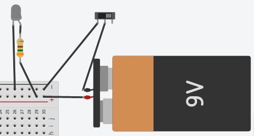

LED is diode, it means that It allows the current to flow easily in one direction, but severely restricts current from flowing in the opposite direction. so you must know the positive and negative part of the LED. If the positive part of LED paired with negative part of the battery, the LED would not turn on. The LED have different shape of lead. The you can differentiate it by clicking the cursor of your computer on the lead of the LED (see the picture). Anode on LED is a positive part, thus you must joint the anode from the LED to positive part of the battery.

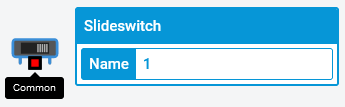

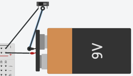

Switch is a tool to connect and disconnect electricity from the battery to the other components. There are three feet of the switch, and the middle feet is "common", meaning you have to paired this feet to the battery (positive or negative part, up to you). Then you need to paired the other feet from the switch to the component (see the picture).
Step 6: Wiring
In this step I paired the switch to the negative part of the battery and place the resistor before the positive part of the LED (anode). I connect the negative part from LED to the negative part of the battery. Based on the simulation, my mushroom lamp can run succesfully.
