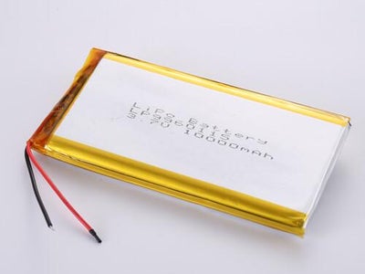

  4. LipoBattery 2000 mah $2

There is minimal wiring in this project and is easy enough to do with kids for a fun project. The Xiao has a charging circuit built in and the pads for attaching the battery are on the back. These pads should be tined first to make attaching the battery to it easier. The switch is wired to the positive battery terminal and then to the Plus terminal on the back of the Xiao. The ground is connected straight through. The power for the LED chain is drawn from the 3 volts on the Xiao board connected to the LED strip. The LED strip (Eight lights) is cut from a regular long strip of NEOPIXEL LEDS. The ground from the lights is connected to the board ground and the control wire is soldered to D9.
