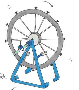

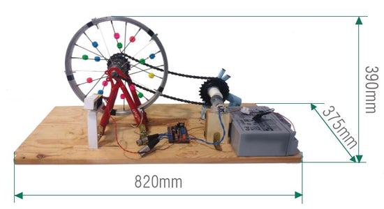

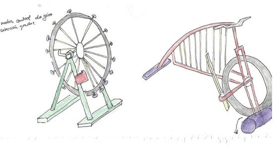

Step 2: Make the Idea Possible

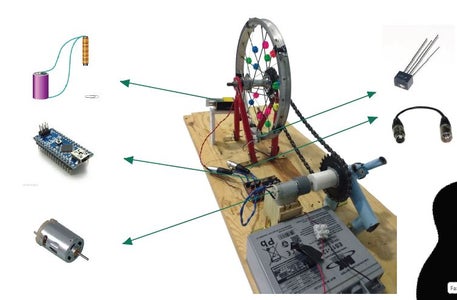

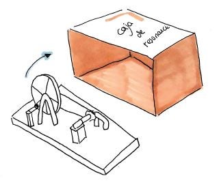

The idea was cool, but we needed a more detailed schema before starting.
Our key elements in this case were far more detailed:
  1. Resonance box: If we want to hear the sound with the motor spinning, we have to amplify the sound from the string.
  2. Motor system: The wheel will have to spin at a relatively slow speed (1 cycle per second approximately)
  3. Pick system: We intend to use a solenoid to interact with the string, but it has to be fast and precise
  4. Motor adapter: So we can attach the motor to the pedal axis

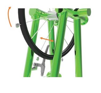

  5. Vision sensor: This way we can detect the exact position of the wheel while it is spinning

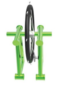

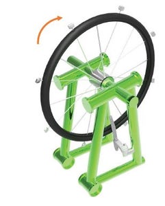

Step 3: Model Your Idea Into Something Tangible
Next, we decided to 3D model our idea, because it is really helpful when landing an innovative solution.This way we could work in all aspects of the project at the same time, because we were aligned on how the final Musibike would work.

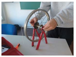

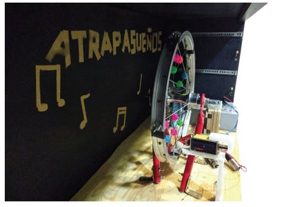

Step 4: Start Building
We used a lot of recycled materials. An old bike from my sister, a wooden closet from the bin, etc.
From there we started attaching all the mechanical parts to the base. You can see that we had to design a small 3D printed part so we could attach the motor to the pedals side of the Musibike.

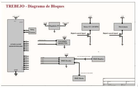

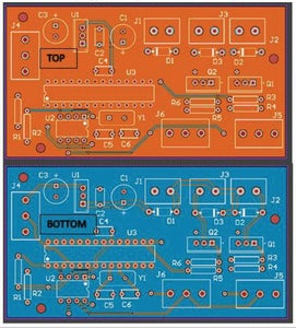

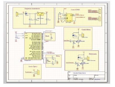

Step 5: Electronics
Here are a few recommendations when developing electronics projects with custom designs and PCB:
  1. Create your block diagram schema
  2. Transform the block diagram into your schematic with details on the component side
  3. Create your PCB with an easy-to-use tool (I used Circuitmaker because it was a collaborative project).
You can see that every aspect of the Musibike was electronically controlled, and timing was crucial.

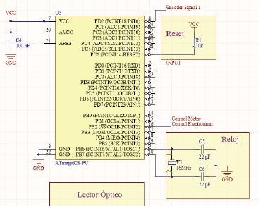

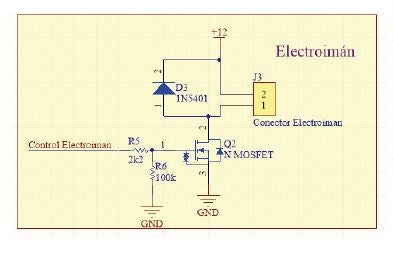

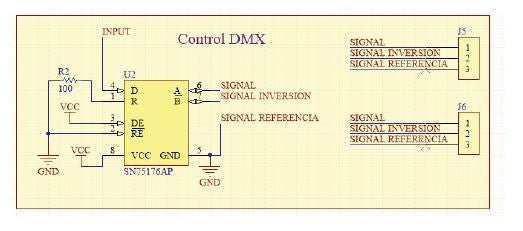

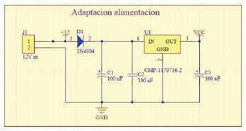

Step 6: Detailed Electronics: Schematic
Here I wanted to share with you the detailed schematic that we created for the Musibike.
As you can see, there are a lot of connectors because the devices were far away from the PCB.
List of parts:
  • Motor system
  • Optic sensor
  • Microcontroller
  • Solenoid
  • DMX controller
  • Power wiring

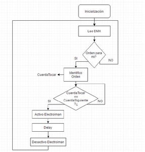

Step 8: Detailed Electronics: Firmware

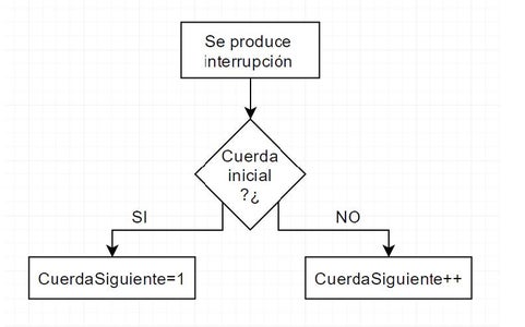

The firmware is pretty simple. We have 2 main loops going on (one is interruption-based).
1. Main loop: It reads the DMX channel to receive the string to be played. When the nextString equals the stringToPlay, we activate the solenoid for a certain amount of time to play the tone. Then we start over again.
2. Interruption loop. Each time the vision sensor detects a new string passing through, it counts the nextString. We know there are 5 strings, so we start over again when the count is 6. This way we always know which one is going to be the next string.
Attached is the full program

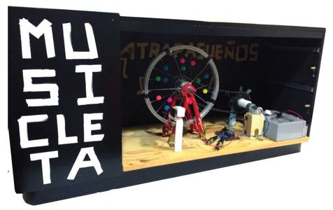

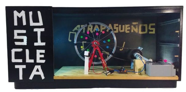

Step 9: Final Result
Here you can check out the final result.
