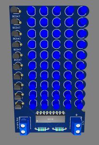

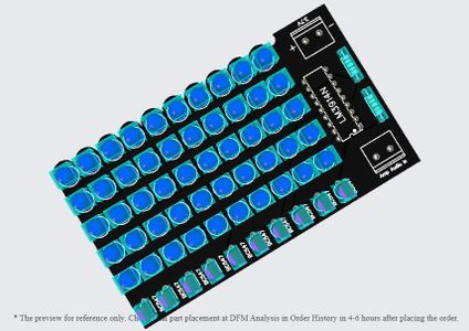

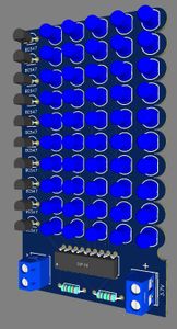

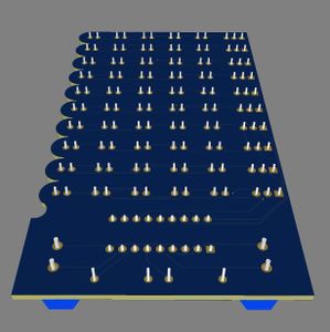

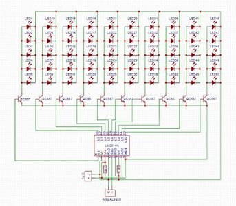

Step 7: Schematics and PCB Design
The schematics of PCBs can be seen above.
Step 8: Circuit Connection – Step 1
To make this music activated light circuit, 1st we connect CD4017 IC with PCB board. We connect 2no, 4no and 8no leg of IC and connect 3no and 9no leg of IC.
Then we connect 33 KΩ resistor with 3 no leg of IC and then connect its other terminal with 6no leg of IC.
Now we connect 1.5 KΩ resistor with 7no leg of IC and then connect its other terminal with 8no leg of IC.
 We utilize JLCPCB https://jlcpcb.com/RTA to printout our PCB.
Step 9: Circuit Connection – Step 2
To make this circuit we are using 50 pieces LED light. We divide this led by 10 and then each side got 5 led. We make parallel connection in this 10 side led and connect all LED negative legs with 8no leg of IC.
We connect all transistor emitter leg and connect this emitter leg with 9no leg of IC.
Step 10: Circuit Connection – Step 3
If we count this transistor in 1 to 10, then we connect its 1no transistor “Base” leg with 1no leg of IC, 2no transistor “Base” leg with 18no leg of IC, 3no transistor “Base” leg with 17no leg of IC, 4no transistor “Base” leg with 16no leg of IC, 5no transistor “Base” leg with 15no leg of IC, 6no transistor “Base” leg with 14no leg of IC, 7no transistor “Base” leg with 13no leg of IC, 8no transistor “Base” leg with 12no leg of IC, 9no transistor “Base” leg with 11no leg of IC and 10no transistor “Base” leg with 10no leg of IC.
Thanks to JLCPCB for offering us, this SMT PCB circuit.
Step 11: Circuit Connection – Step 4
Now we just need to connect audio cable and power source cable with the PCBs. We connect audio “G” cable with 4no leg of IC and connect “L” cable with 5no leg of IC.
Just need to connect power source with the circuit. Connect DC positive cable with 3no leg of IC and connect DC negative cable with 2no leg of IC.

Neat and perfect soldering is an important part of all kind of PCBs. Since soldering, you should remember that, there should not be any kind of short circuit. After soldering all leg, we cut-off the extra leg of all electronics component.
