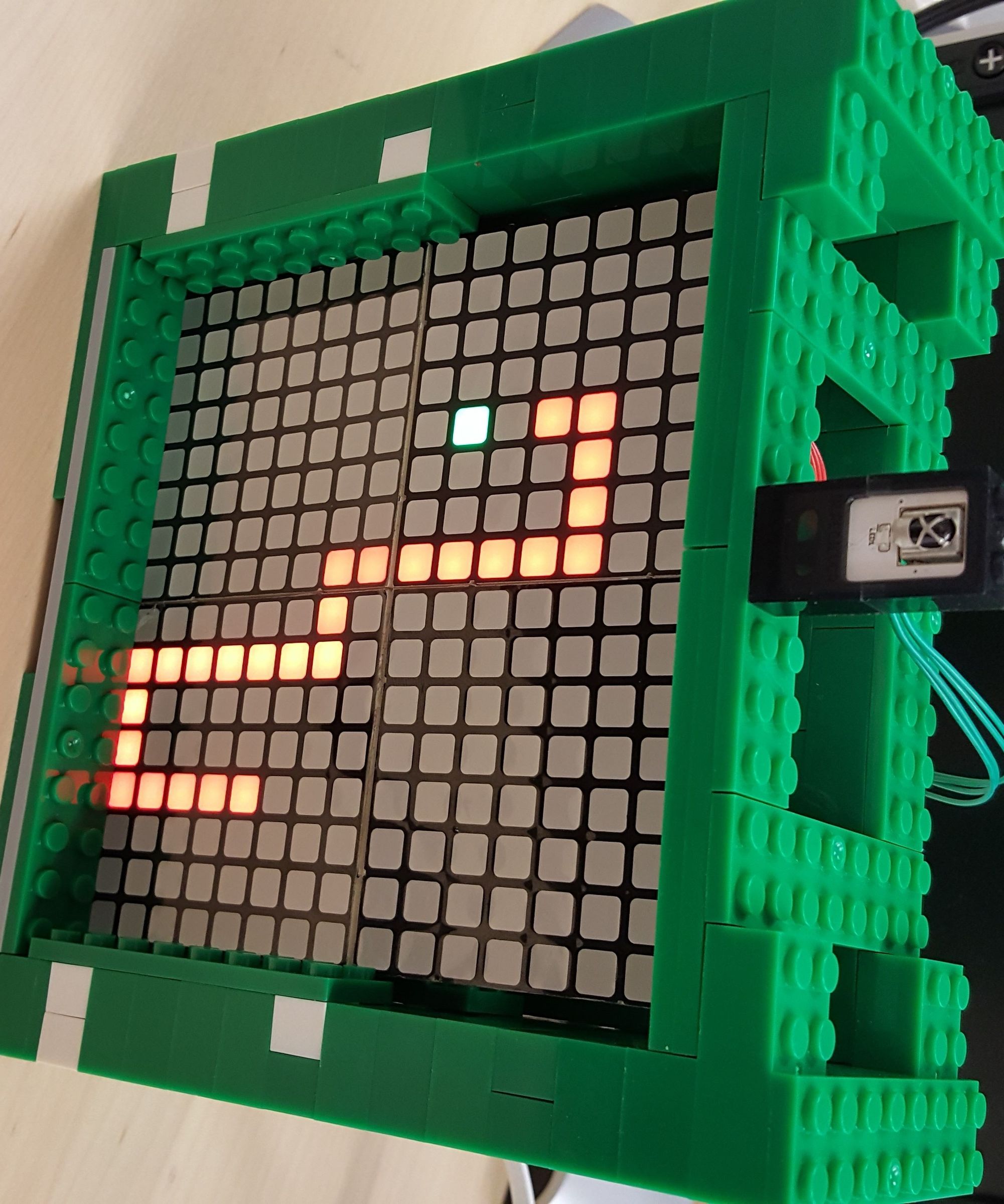

Hey everyone, I'm back with another project. This one's basically a boom-box that can play, pause increase/decrease volume and skip songs. I made it using some Legos and a Microduino 302 kit although I think the 202 has the parts as well. My only issue is adding tracks to the device must be done in the code otherwise it works great (big sound quality improvement over the 301 kit).
I also added a fun feature which is a link between the microphone and LED matrix which changes intensity based on the analog output from the mic. When paired with music it makes for a pretty cool and simple visualizer!

The image above is the entire box with the base and Microduino parts removed. It's mostly made of 1x4 blocks with the 'roof' made of the remaining plate pieces.
I started the construction by building the walls next to the speakers and then focused on creating the opening for the LED matrix. This proved a bit tricky as there are only 2 attachment points on top of the modules but attaching the pieces to the roof worked pretty well. The hole for the LED matrix is 2 blocks deep and 3x3 in width and length. I used the 1x6 blocks to connect the modules to the two side walls.
