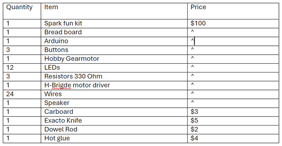

We made a music box using the Sparkfun kit. This music box can compete in the 4H Robotics Competition.
The Sparkfun kit, carboard, hot glue, dowel rods, and an exacto knife were used in the construction of the project.
