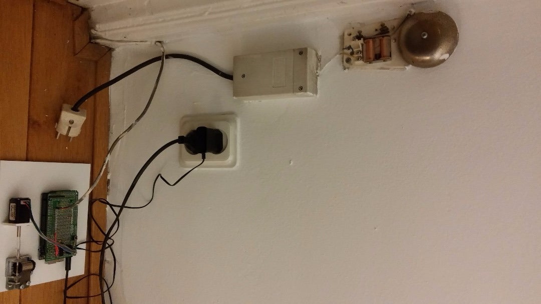

My apartment in Amsterdam has a very old and extremely loud doorbell. I decided to make a new one, because I was tired of being startled every time someone rang the doorbell. I had a music box sitting around, and an arduino mega, and I have a few prototype shields for the Mega that I designed a while back. I decided to use these things to come up with a working prototype.

To start with I put the H-Bridge on the prototype board, and then connected the ground pins to the ground bars on the prototype board. I then connected the H-Bridge input pins and enable pins to digital pins on the Arduino. The power pins are connected to Vin, and finally the H-Bridge output pins are connected to a 4 pin female header that the stepper motor plugs into.
The next bit is to wire up the doorbell, I used a 10kOhm pull down resistor on the input side of the button, and a 0.1uF ceramic capacitor to debounce the button. Just connect one wire of the button to the resistor/capacitor/arduino digital input, and the other wire to 5v. Then when the button is pressed the digital input will go from low to high. I also used a digital input that is capable of triggering an interrupt so I don’t have to constantly read the state of the input.
With all of the electronics taken care of, I needed something to amplify the sound, and also serve as a mount for everything, I decided to use Formulor to have a small piece of laser cut plastic made with mounting holes for the music box and arduino. I used inkscape to design the plastic, and sent it off. Then about 2 weeks later I had the plastic in hand. I also had them laser cut a motor mount, and a small slot to slide the motor mount into. I just used some epoxy to secure the motor mount in place and some clear plastic tubing to couple the motor to the music box.

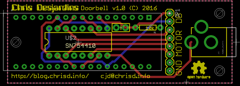

Step 3: Next Steps
I think in the coming weeks I will have a custom PCB built that works with an Arduino micro. I have already designed the PCB, I just need to have it built. Then I will just replace the Mega, with a Micro and everything will be much more tidy.
