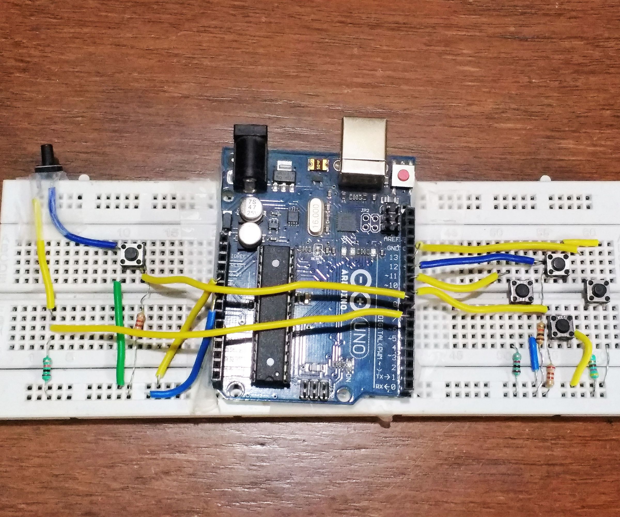

Create the circuit as shown in the fritzing image above. Make sure you wire the SD card reader correctly as you don't want to risk damaging your SD card. Here are all the SD card connections. (You don't need to worry about these if you are using a SD shield, but if you are using a module you need to wire it up.)
| SD module | Arduino (UNO) | +-----------+---------------------------------+ | Gnd | Gnd | | 3.3v | 3.3v | | 5v | 5v | | CS | pin 4 (Pin 53 on Arduino Mega) | | MOSI | pin 11 (Pin 51 on Arduino Mega) | | SCK | pin 13 (Pin 52 on Arduino Mega) | | MISO | pin 12 (Pin 50 on Arduino Mega) | | Gnd | Gnd | +-----------+---------------------------------+
Additionally, the speaker connection should be as follows:
- Speaker - Pin 9 (Pin 11 on Arduino Mega) (This is required for TMRpcm library that is used with this code)
The switches should be connected to pin 5, 6, 7 (Respectively - Rewind to first file, Play, Next File).

Plug in your SD card into the reader and connect your Arduino to your PC/Comp. Click on Serial Monitor and after a few seconds the first music file's name on your SD card will appear. To move to the next file press the push button connected to pin 7. To go to the first file press the button connected pin 5. To play a file press the button connected to pin 6. And that's it, enjoy!!!
Please note that I used only 3 controls (Go to first file, Next file, Play), but you can obviously use more controls as you wish. Of course, you would need to modify the program accordingly.
