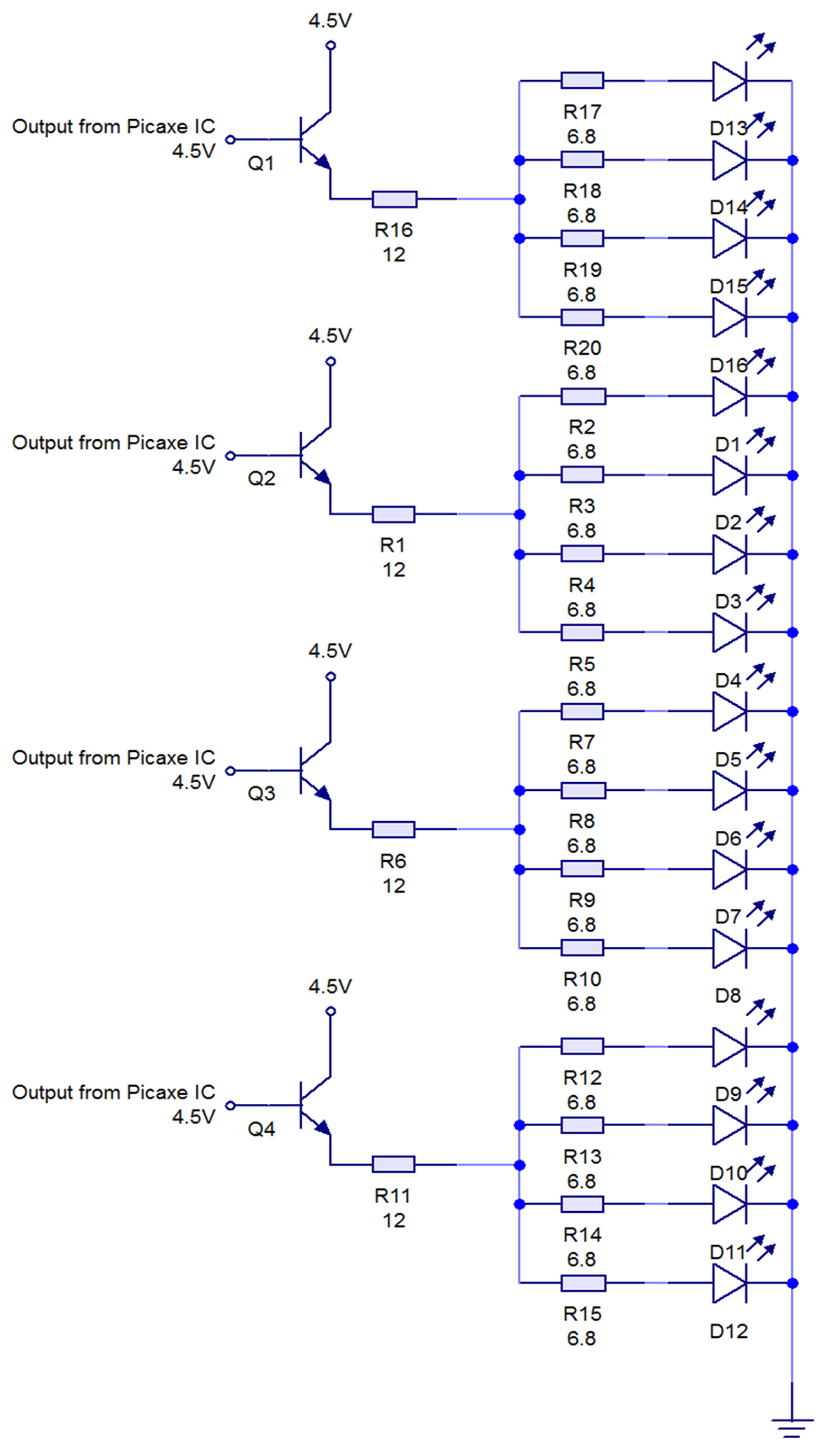

Step 2: Electronics - Design
The hardware within this circuit involved a Picaxe 18M2 IC which is the programmable micro-controller in my design which can be programmed using a PC, a TDA2003V IC is also used in the circuit which is used as an audio amplifier to amplify the audio signal coming from a music player connected through a 3.5mm audio jack. There are also many off board components such as an LCD Display module and 3 potentiometers connected to the circuit board using flying leads. This circuit was designed in software called 'Easy PC' first as a schematic diagram then as a PCB layout, this was a long process to design the circuit as compactly as possible without needing any jumper wires in the design but I believe the design ended as compactly as possible without the need of additional jumper wires.
