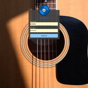

  2. A "User Friendly" Server: connecting Navidrome, an UI fully fledged by somebody else, to my ingestion server, so I could listen to my music easily, with an experience very similar to using a streaming service.

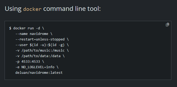

  5. Flask
  6. Navidrome

In my case, I installed ubuntu and chose to use Flask, a Python framework to implement the server.
To work in an organized way, it's recommended to create a folder for the project and a virtual enviroment so that there are no problems with external libraries, dependencies or files in general.

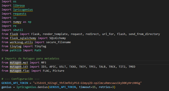

Step 4: Libraries and Genius API
The most important libraries are:
  1. flask: is the centerpiece of the server, creates the app and defines the routes of the server.
  2. werkzeug: used for secure_filename(), very important for security when uploading files.
  3. flask_sqlalchemy: translates python into SQL so we can create a database and store, delete and search songs in the database.

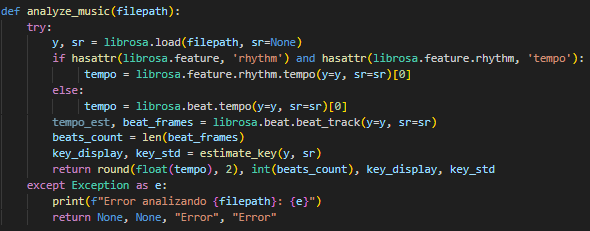

  4. librosa: this is the server AI, it analyzes the files and gives us the tempo, beats and key.
  5. mutagen: handles metadata, it writes the results of the analysis in the song's metadata.
  6. tinytag: does a quick read of the metadata from every song.
  7. lyricsgenius: a wrapper for the Genius API, search automatically in Genius' lyrics database the uploaded song(s), using its metadata.
  8. requests: for HTTP requests. Downloads the covers of the albums from TheAudioDB URL with fetch_album_art()
Also, we have to create a Genius Account, create an API Client for our app filling a form and then generate an Access Token (all of this is completely free!).

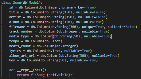

Step 5: The Database
This maybe the most important part of the server: without database we can't store, organize and search files. Our database isn't too complex, but it does the job.
It stores an id for every song, title, artist and album. Also, it stores a filename (different from what we see in the player), a track number if the song belongs to an album and there are other songs, the media type where it comes from: a Vinyl, CD, SACD, Digital File..., the tempo and number of beats we get from analyze_music(), lyrics from fetch_lyrics(), the url of the album cover we get with fetch_album_art() and the key of the song that estimate_key() gives us.

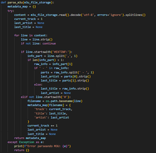

Step 6: Parse_m3u()
This function will read a .m3u file that is extracted from a cd. It gives very useful informatio: the duration, name of the artist and name of the song; it's some kind of map that tells us that track01.flac is name of artist - name of song.flac.

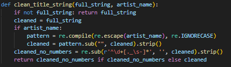

Step 7: Clean_title_string()
It cleans the title of a song, but what is cleaning? Well, if it is in slug format (for example 01_artist_name_song_title), it converts it into a clean string and erases the track number so in the database and in the player the names will look clean and professional.

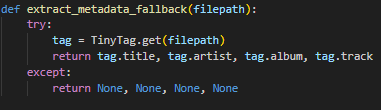

Step 8: Extract_metadata_fallback()
It uses the TinyTag library to extract the existing metadata in the file, it's very useful in case the AI system fails or there are no data in the internet on that specific file.

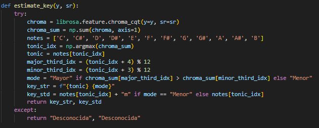

Step 9: Estimate_key()
Using signal processing and maths (librosa and numpy), it gets the key of the song. First it generates a chromatogram, then looks for the tonic note (the strongest or more frequent), compares the energy between major third and minor third of the tonic, and whether one or another ir stronger, the key will be major or minor respectively.
Step 10: Analyze_music()
Using librosa once again, this function is in charge of the audio analysis. It loads the audio file into RAM as an array of numbers, it calculates the tempo counting the rhythmic beats and gets the key from estimate_key().
This function is like an AI coordinator in the server.

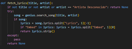

Step 11: Fetch_lyrics()
This function searches for the lyrics in Genius, using the lyricsgenius module.

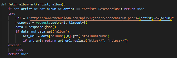

Step 12: Fetch_album_art()
This function is very similar to the former one. It looks in theaudiodb (a database of music releases) and gets the cover of the album of the uploaded song.

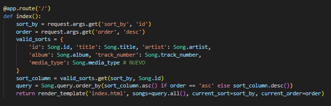

Step 14: Routes
Flask works similarly to a web developing tool; we define the routes, URL of our server and then, we can define what happens in every section of the web. For example, '/' is the homepage, there's the title, the form to upload songs an a summary of every recent upload; '/upload' proceses the upload form and does everything that is in the flow chart... We have GET routes (display, for the user), POST routes (action, for the ingestion, management and streaming).

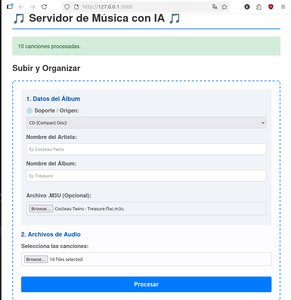

Step 15: HTML
All that we have done to this point is very useful, but we also need an interface so an user can upload songs easily, that's where the HTML's come into play. We have two, one for the index, the page where we upload songs, and other for every song, so we can see the lyrics, bpm, key, play the song, change its cover art or delete it.
Step 16: Index.html

<h2>Subir y Organizar</h2>
<form action="{{ url_for('upload_file') }}" method="POST" enctype="multipart/form-data">
<div style="background: #f0f4f8; padding: 15px; border-radius: 5px; margin-bottom: 15px;">
<h3 style="margin-top:0; color: #0056b3;">1. Datos del Álbum</h3>
<label for="media_type">💿 Soporte / Origen:</label>
<select id="media_type" name="media_type">
<option value="CD">CD (Compact Disc)</option>
<option value="DIG">Digital / Web</option>
<option value="VINYL">Vinilo / LP</option>
<option value="CASSETTE">Cassette</option>
<option value="SACD">SACD (Super Audio CD)</option>
<option value="DAT">DAT (Digital Audio Tape)</option>
</select>
<label for="force_artist">Nombre del Artista:</label>
<input type="text" id="force_artist" name="force_artist" placeholder="Ej: Cocteau Twins">
<label for="force_album">Nombre del Álbum:</label>
<input type="text" id="force_album" name="force_album" placeholder="Ej: Treasure">
<label for="m3u_file" style="margin-top: 15px; display:block;">Archivo .M3U (Opcional):</label>
<input type="file" id="m3u_file" name="m3u_file" accept=".m3u,.m3u8">
</div>
<div>
<h3 style="margin-top:0; color: #0056b3;">2. Archivos de Audio</h3>
<label for="file">Selecciona las canciones:</label>
<input type="file" id="file" name="file" accept="audio/*" required multiple>
</div>
<button type="submit">Procesar</button>
</form>

Step 19: Uploading Songs
To upload one or more songs, we can optionally fill a form manually with the artist and album name (for cases such as a compilation album with many artists) and the medium from which the files was extracted, we can select a m3u if we are uploading a cd rip, and then, we can select one or more songs and upload them.
In the process, we will see some status updates in the terminal, showing us which song is being processed and the step of that processing.
Once the songs are uploaded, they will appear in the uploads folder, inside our 'myproject' directory.
Step 20: Integration With Navidrome
The server right now is very good for uploading, getting metadata and storing songs, but not for playing actual music: the interface isn't very atractive, is a little slow and doesn't give many options for the user (for example, features like creating playlists). That's why we'll integrate navidrome into our server.
Navidrome isn't connected directly to our server, it just checks our uploads folder and takes what's inside and presents it in a more attractive way, with an interface similar to apps like spotify. So we can say our ingestion server makes the dirty work, organizing music and embeding its metadata so it is read properly by navidrome.
To do the integration we just have to run a docker command in the terminal and then we can use navidrome as our streaming server.
Then, we'll have to run http://localhost:4533 and the login page of navidrome will welcome us. Now, you jsut have to create a username and a password, and from now on, you have your own music streaming server, congrats!
