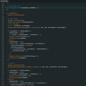

Step 7: Uploading the Arduino Code
Now it’s time to finally upload our code!
First, download the sketch at the bottom of the step, and open it up in Arduino IDE.
Before we can upload it, however, we need to make sure that we’ve installed the required Arduino libraries. These libraries handle the OLED display and graphics rendering.
To install these libraries in the Arduino IDE,
First, open the Arduino IDE.
Then go to Sketch > Include Library > Manage Libraries….
Search for and install:
  1. Adafruit GFX Library
  2. Adafruit SSD1306 Library
Once they’ve installed, plug your Arduino Nano into your PC via USB-C.
Then, in the Arduino IDE, select the Arduino Nano board and the correct COM port.
Finally, hit upload and you’ll be done!
Now your Nano should be able to handle button presses, the rotary encoder, and updating the OLED display.

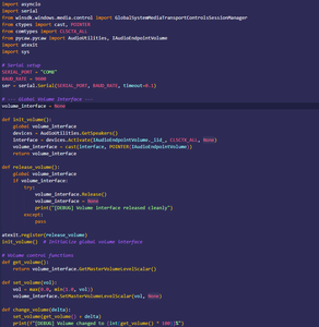

Step 8: Setting Up the Python Script
Now we need to set up the Python script. The Python side acts like a bridge between the Arduino and Windows itself. Make sure you download it from the step and place it into an empty folder.
Once you’ve done that, first head into that blank folder and create a virtual environment in PowerShell with:
python -m venv venv
Then activate the virtual environment with:
.\venv\Scripts\Activate
Now we can begin installing the required libraries. With your virtual environment active, install them via:
pip install pyserial winsdk comtypes pycaw
Once everything is installed, simply run:
python status_player.py
to verify that everything is installed and it works.

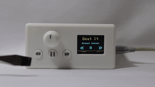

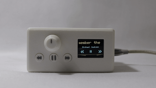

Step 9: Enjoy!
And that’s it!
Your Status Player should now be complete!
To use it, connect your Arduino Nano via USB. Then run the Python script and wait around 5 seconds for it to sync up. Then open your favourite app like Spotify, YouTube, or anything else and play something.
It should then appear on the display, and you’ll be granted full control over it, such as rewinding, pausing, skipping and adjusting volume!
I found this project extremely useful since I no longer had to change tabs or fiddle with keybinds whenever a song I didn’t like came up; all I had to do was press a physical button!
I hope you enjoyed building this project and that it finds a permanent place on your desk.
