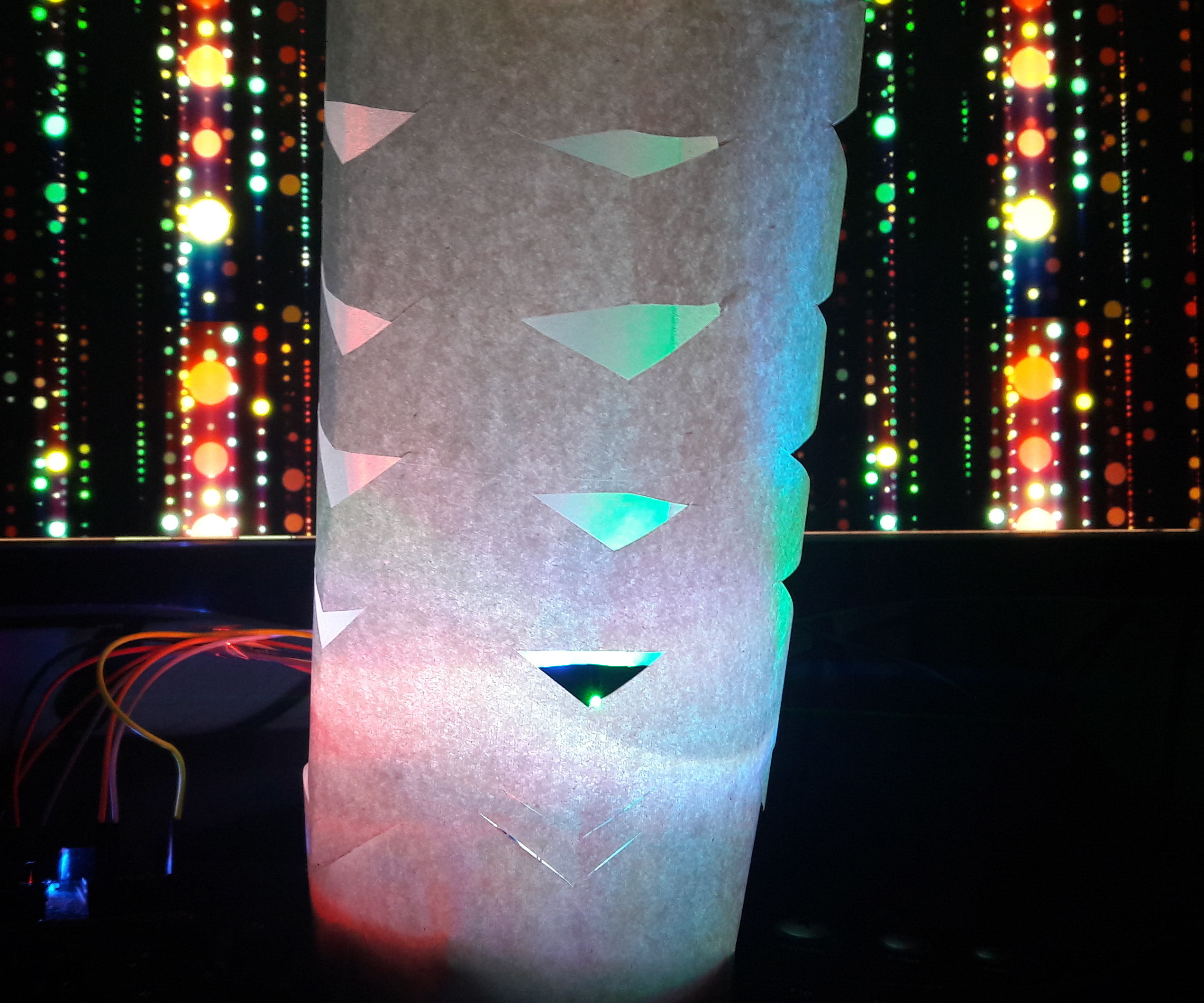

Introduction: Music Synced LED Lamp (using Arduino and Sound Sensor)
The Music Synced LED Lamp blinks the LEDs according to the beats of the music.

Step 2: Make the Following Connections
- Connect LEDs onto breadboard.
- The Negative of LEDs should be grounded using the 100 ohm or 220 ohm resistors
(Negatife of LED -> Resistor -> GND) - The Positive of LED should be connected to the digital pins of the Arduino board.
- Connect Ground of breadboard to GND on Arduino board.
Sound Sensor connections:
- GND pin of Sound Sensor to GND pin on Arduino board.
- VCC pin of Sound Sensor to VCC pin on Arduino board.
- OUT pin of Sound Sensor to digital pin 2 on Arduino board.
