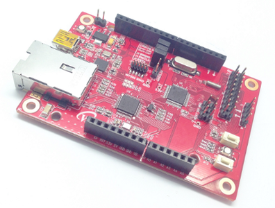

Step 1: Prepare Meterials
We need a several meterials.
  • 1. WIZwiki-W7500 board buy now
  • 2. Easy Module Shield x3 buy now (Used only Buzzer because It can be replaced by any buzzer)
  • 3. Some cables(some jumper cables, LAN cable, mini B-type USB cable)
They are all... for this project.
Step 2: Hardware Connection
Hardware connection is very easy.
Just follow picture.
Picture shows us all of we have to connect.
and Please connect an USB cable and LAN cable.

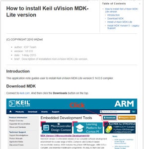

Step 3: Prepare Development Environment
I prepared MDK develpment environment by the following site.
http://wizwiki.net/wiki/doku.php?id=products:w7500:documents:appnote:install_uvision
I installed MDK Keil 5 Tool, Legacy pack.
If you install all tools, you are ready for running this project.
