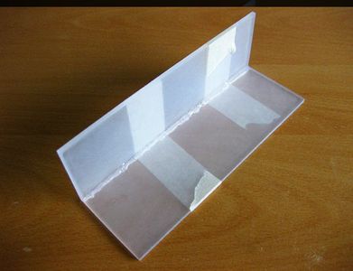

1. After fitting the plates get the glue and glue the first 3 plates together. If you have some trouble holding the plates together before gluing, you can use some tape to hold them together. This way you can put the glue on more relaxed.
After gluing the 3 plates you should have something like photo 2
2. After the glue is dried, it's time to glue in the side plates. First place them and see if they fit nicely.
If not sand the sides a bit so everything fits nice together. Then glue them on their place.
The last (bottom) plate will not be attached yet. We need to put the whole circuit on the bottom plate later and then put it in place.
At this moment you should have something like photo 3 and 4.

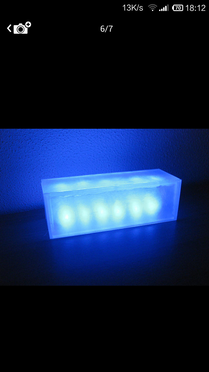

Step 7: Final Finishing
We've now got all the parts we need. All we need to do now is put the bottom part into the cube to make it a whole cube.
1. Use the glue gun again to put the connector for the adapter right behind the hole. Tip: Plug the cable in before gluing. This way the connector will always be on the right spot.
2. Sand the sides of the bottom plate so it fits snugly into the bottom. You just want the bottom plate slightly bigger then the hole it fits in. This way, once you put it in there, it will get stuck and won't let go while moving the cube. We won't glue the bottom, in case we need to open it for some reason. So make sure the bottom fits in tight.
That's it!!
Now plug everything in and put your music on max and enjoy!
You can change this project as much as you like. Use any LED's you want, create the box that fits the best on your desk, etc.
