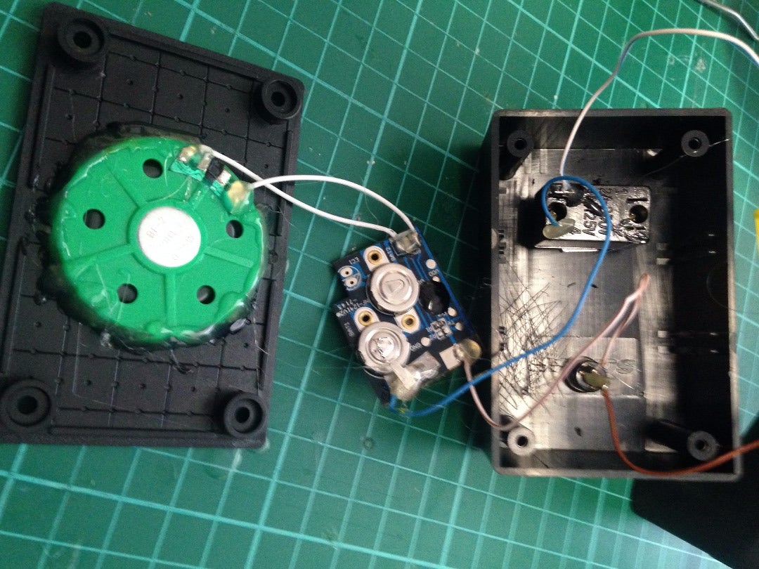

Step 7: Putting Everything in Place
The last stage is to bring everything together in the box and fix everything in place. We bring out the glue gun for this part.
Fix the switches in place:
Mount the switches in the box and ensure they are firmly fastened in place.
Glue the speaker in place:
Use the hot glue gun to fix the speaker in position. Do not worry if it's messy like mine, you wont see it.
Place the main circuit board:
The circuit board had to be placed in the box at an angle due to the bulk of the toggle switch body. I got lucky and was able to fit it in at an angle. I wanted to fix it in place as much as possible so i scored the inside of the box where the board would make contact, this so that the glue had a rough surface to adhere to. Then I placed the board in and dropped a big blob of glue making sure the glue was on the bottom of the board and in contact with the box.
Glue the bare connections:
To prevent any of the bare wire/terminals of any of the components, I decided to put some blobs of glue around the place to help insulate.
Sound Insulation:
I'm not an audiophile by any stretch of the imagination, but, I did notice that the sound from the speaker was heavy and a bit tinny. To try and soften the sound I added some bits of foam into the box before I closed it up. The theory was to dampen the sound to make it sound less harsh. Also, packing it out with foam wil provide some shock absorption should Riley drop the box.
No need to glue in place, just cut and shove into place.
Closing up:
The final step is to fix the base plate to the box and screw together. The box should clip nicely into place and be firmed up once fully screwed in.
Now for the fun of testing!
