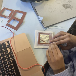

Step 1: Cutting Paper
Assuming everything is cut and ready, we can start layering the correct materials together.
  1. The thick cardboard foam is the base, so we put that on the bottom.
  2. Tape the tin foil in the center of the cardboard foam. If the dimensions are right, there should be a 1-inch margin between the tin foil and the cardboard foam.
  3. On top of the foil, tape the frame/mat board
  4. For the top layer (what we press onto the foam to make the button pressable), tape the remaining four tinfoil cuts onto the four chipboard pieces.

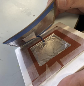

Step 2: The Wiring
Now we want to add wires so that electrical signals can pass between the two foil things when they touch.
  1. Cut two holes on the bottom foam board, make sure one goes through the tinfoil
  2. Feed wire in color 1 through the bottom of the foam board through to the other side of it, then attach it to the chipboard with tin foil by taking it with copper tape
  3. Feed wire in color 2 through the bottom of the foam board under the tin foil that sits on the foam. tape with copper tape.
Step 3: Taping It Together
  1. Tape the chipboard with tin foil onto the foamboard with tinfoil, both foils facing each other.
  2. Don't forget to decorate the chipboard, that's what people will be seeing (but be careful to not make it wet).
