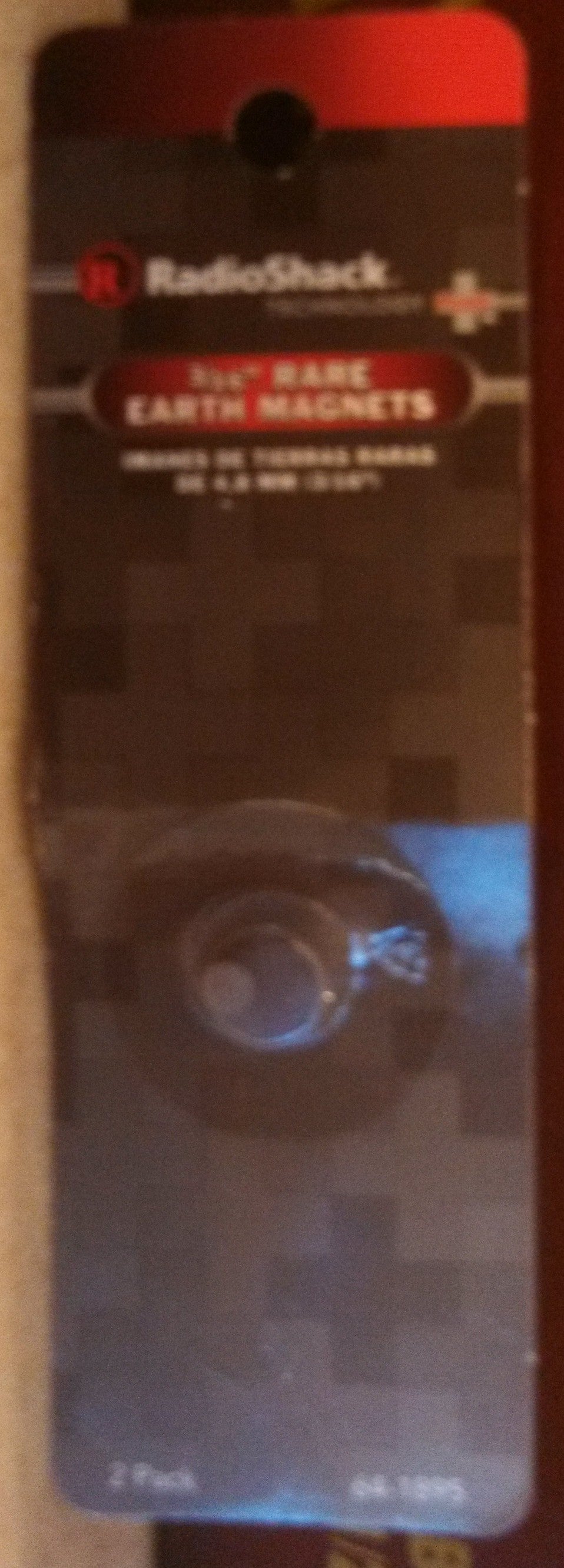

Step 3: The Player
I purchased five of the cheap MP3 players off of Ebay, the extras became gifts.
Materials
- MP3 player
- microSD card
- perf board
- micro tactile push button switches
- wire
- heat shrink
- old head phones
- a pair of speakers, amplified may work better than the speakers I used
- rare earth magnets, I like Radio Shack's 64-1895, a bit overpriced but the size is perfect
- magnetic reed switch, needs to have three leads (SPDT, ON-ON), I used Philmore No. 30-17154
- dowel rod
What I Did
- disassembled the MP3 player
- made a note of which contact went with which function
- removed ridge from the outside of the case, to ease fitting it into the box
- soldered wire to the speaker terminals and the old head phone cable
- soldered wire to the reed switch, I used a continuity tester to pick the correct leads
- cut a notch for the reed switch and glue it in
- drill a hole in the lid and press in both magnets
- remove the clear tape holding the contact springs
- carefully solder wires to replace the switches
Observations
Everything function properly, except when plugged in to charge the battery. Player stops playing as soon as the lid close, as it should. It takes a couple of seconds to start playing when opened, I would rather it started a little faster.
