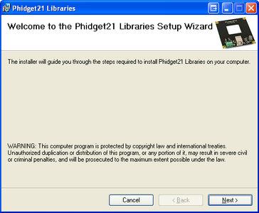

Step 1: Install Phidgets Drivers and Libraries
If you haven't already done so, follow the instructions to install the Phidgets drivers and libraries (direct download link) on your computer. You can get a quick tutorial on using Phidgets in Visual Basic on the Phidgets wiki, but it's not necessary to cover this beforehand.

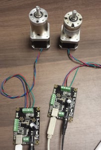

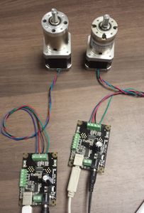

Step 2: Connect the Motors
Connect stepper motors to the computer with the stepper controllers. Connect each controller to a12VDC 5.0A power supply, like the one that comes with the controller.
