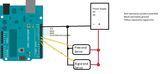

Step 3: Electronics
The picture above is self explanatory you can either make a shield for
the arduino as I have done or a bread board for the circuit.
Here you can see what I meant by pin numbers in the previous step.

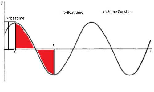

Explanation of the code: trialnew function takes in the audio file and arduino object as input then extracts its beat timings (which cannot be explained here) then estimate its tempo for the first second of the song.
It then constructs an angle trajectory which is a cosine wave such that the bot bangs at the beat time and intensity corresponding to the beat time length. Then it adds the beat time to the timer and estimates the tempo of the next second. Thus constructing the motion of both the servos.
