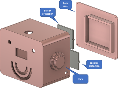

Step 7: Print the Box / Imprimer Le Coffret
The box has been designed using Fusion 360, an excellent modeling tool. Now, time to 3D print the box: please download all the attached files corresponding to the box, the ears, the back panel and other internal elements. I used my Prusa Mk3s+ printer and PrusaSlicer with standard parameters: PLA filament, 0.15mm Quality, Supports everywhere. For the filament color, I chose a very nice silk pink, very girly (gift for my grand-daughter).
Glue the ears on both sides of the box. Spray two layers of varnish with a satin finish on the box and the back panel as well. Wait for 24 hours.
Le coffret a été conçu avec Fusion 360, un super outil de modélisation. Téléchargez les fichiers joints correspondants au coffret, aux oreilles, au panneau arrière et à d'autres pièces internes. J'ai utiliser mon imprimante Prusa Mk3s+ et PrusaSlicer avec les paramètres standards: filament PLA, qualité 0.15mm, supports partout. J'ai choisi un très beau filament brillant de couleur rose, c'était un cadeau pour ma petite fille.
Coller les oreilles des 2 côtés du coffret. Passez 2 couches de vernis satiné sur le coffret et le panneau arrière. Attendez 24h.
Step 8: Final Assembly / Assemblage Final
Start by inserting and fixing the OLED screen in the screen holder with M2 self-tapping screws. Close with the screen protection also fixed with M2 screws. Make sure the wires and connector go through.
For the speaker, you can first insert some protective fabric, then insert the speaker. Close with the speaker protection and fix it with M2 screws. Make sure the cables are not trapped inside.
Then fix the 2 rotary switches and add the buttons.
Insert and screw the ON/OFF button on top of the box.
Fix the main PCB with 4 M2 self-tapping screws on the side supports. Do not forget the micro-SD card.

A few thoughts about possible improvements:
- External reinforcement of the screen with a transparent protection would be good. As it is built it's easy to push the screen inside and break the screw holders.
- Same remark for the speaker: you need to glue the protective fabric inside.
- Replace the USB charger with an induction charger, it's safer for the kids.

J'ai pensé à quelques améliorations possibles:
- le renforcement de l'écran avec une protection transparente serait pas mal. Tel quel, il est facile d'enfoncer l'écran vers l'intérieur et de casser ses fixations
- Même remarque pour le haut-parleur: il faudrait coller le tissu à l'intérieur pour l'empêcher de bouger
- Remplacer le chargeur USB par un chargeur à induction, ce serait plus adapté pour des enfants.
