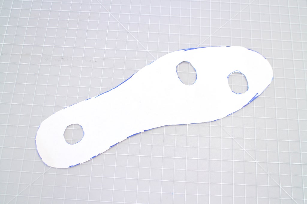

Trace the shoe's sole shape onto a piece of paper. This is your pattern for the neoprene sole you are going to put on the bottom of each shoe. Alternatively, you can print and use or alter the pattern given in the Gather Materials step.
Draw where each foot switch is going to be and what area you want the switch to cover. Cut out each marking and the sole shape.

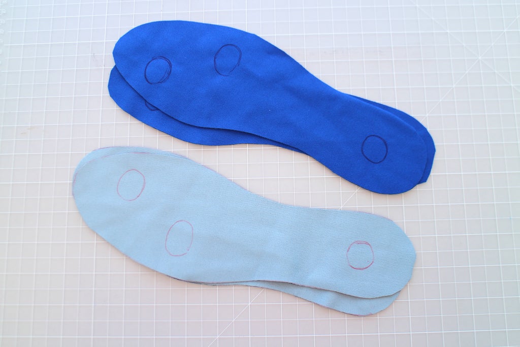

Step 6: Cut Out Sole Sensor Sandwich
This pattern is used to make your sole sensor sandwich. The final layers are stacked in this order.
1/16" neoprene
3/16" neoprene
1/16" neoprene

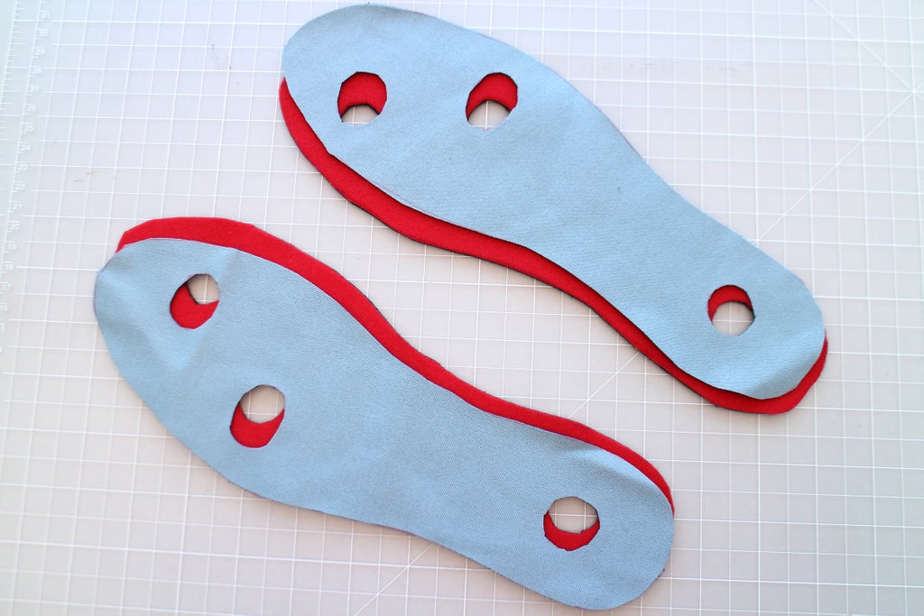

Let's make the center 3/16" layer first. Trace around the outer edge and around each switch on the thicker neoprene. My middle material is a little thinner than 3/16" neoprene so I cut an additional two middle layers from the 1/16" neoprene to stack the two together. Cut out the marked switches creating holes in this middle layer.
Now, on to the top and bottom layers. These layers will have the conductive fabric on them creating the contacts for each switch. Trace around the outer edge and around each hole for the three switches onto the 1/16" thick neoprene. Do not cut out the holes, only cut around the outer edge. My cuts are without the heel extension which I needed to add later. The pattern attached to this 'ible includes it!

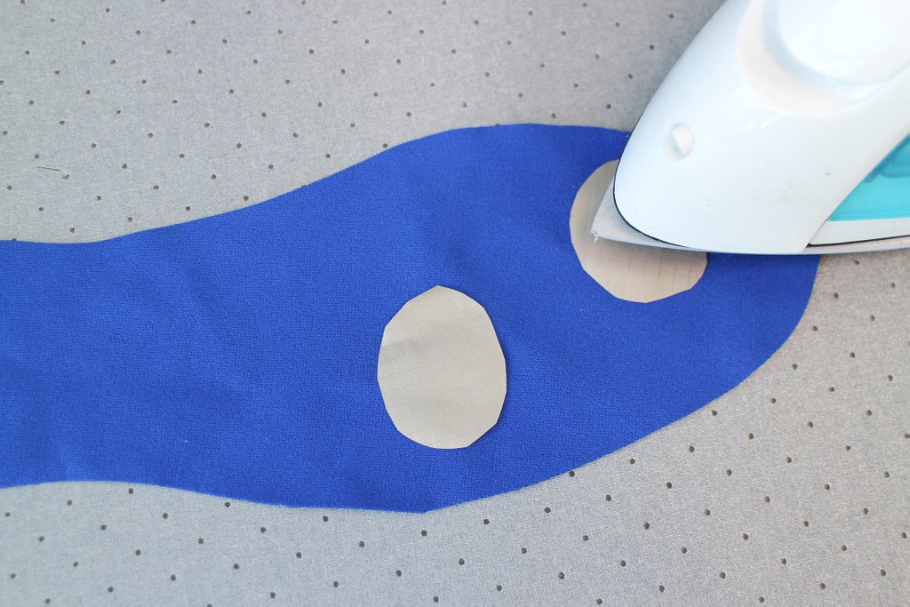

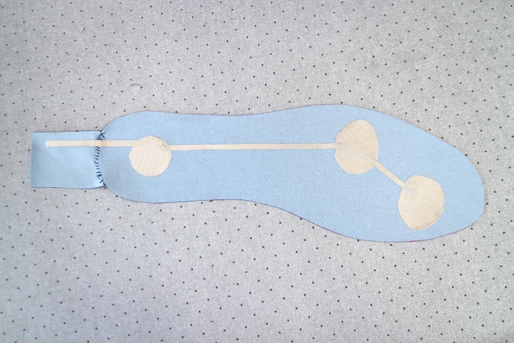

Step 7: Iron on Soft Circuit
Use the holes cut from the paper pattern to trace a switch shape onto the white side of the conductive fabric. Draw a 1/4" border around the shape and cut out. Repeat with each switch cutting two for each switch that mirror each other. With three switches on each shoe, you should have a total of twelve in the end. Iron them on the top and bottom sole pieces over the markings you made.
The switch contacts are now in place! Time for the rest of the circuit. Cut strips of conductive fabric 3/16" wide. Each sole has top and bottom contacts. The bottom contacts all go to ground on the microcontroller so they all get connected. For the top contacts each gets connected to their own digital input pin on the microcontroller so they get their own trace.
First, place the three traces, cut the traces 1/2" from the extension's edge and iron down. Then connect each trace to its own contact.
Leave enough room on one side for the ground trace to lay, remember you do not want any of the traces to touch each other or a short circuit will occur. Connect all three contacts. Repeat for the other sole.
Step 8: Test Soft Circuit

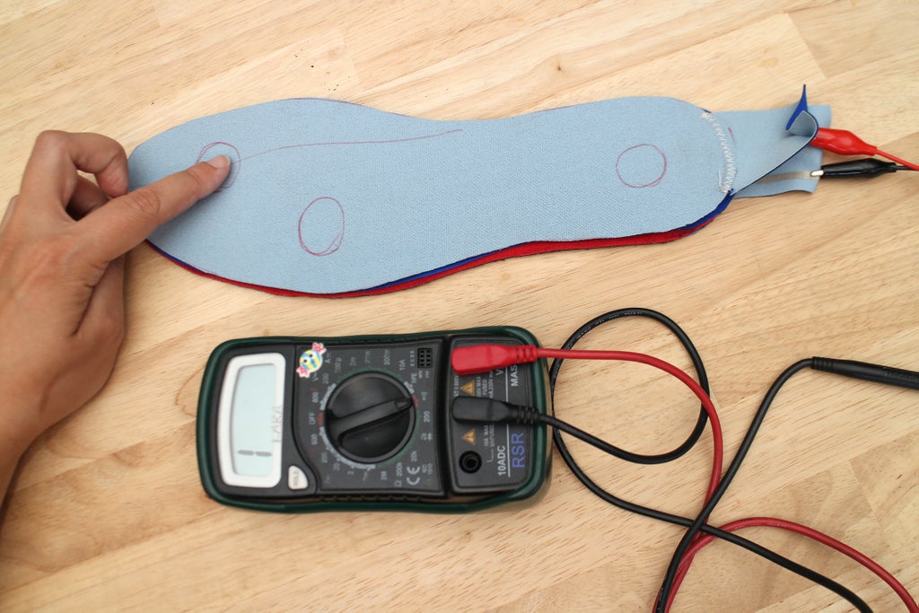

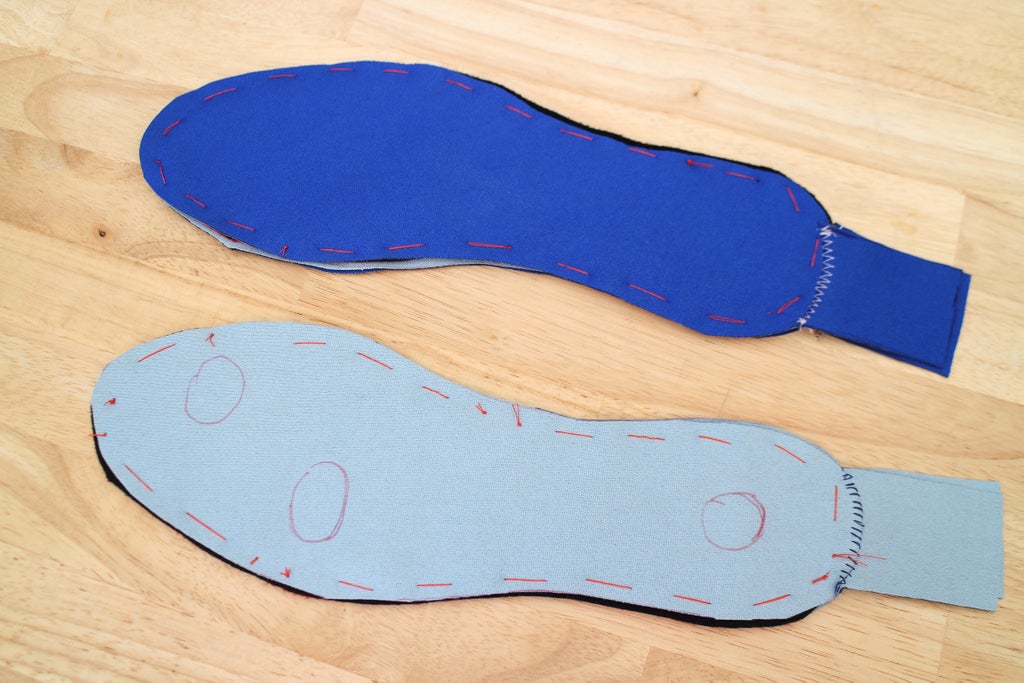

After ironing the circuit check each connection with a multimeter especially all the points where you ironed fabric on top of itself.

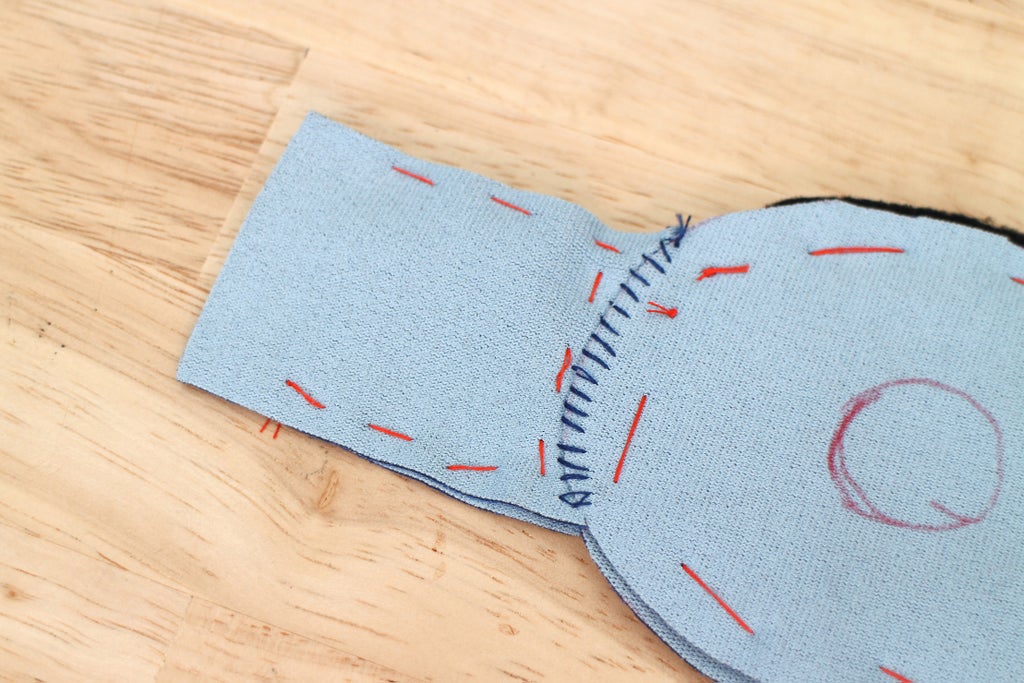

After the connections are checked stack the layers of each sole together to get ready to test each switch. Stitch the layers together using a basting stitch. Clip an alligator lead to the one ground lead and one to one of the switch leads. Press to test, if you hear a beep readily the switch is working! If not, disassemble the layers and check your connections again.
If all the switches are working grab a needle and thread and stitch the layers together around the edge and up the heel extension stopping at the top of the traces. Your soles switches are ready!

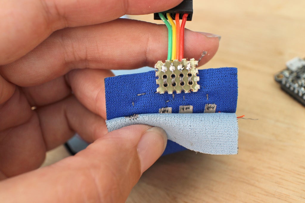

Step 9: Add Female Connector

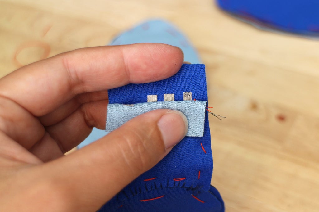

With three switches going to three digital in pins and one common ground, there are four traces in total that you need to connect to the Feather microcontroller. I built two pairs of shoes and needed to use the same two Feather and battery combos for each pair, so I put a connector between the sole circuit and board and battery.
To attach a connector to the sole circuit, cut a small piece of perfboard that is at least 4 rows wide and 3 holes long. Gather female and male crimp pins. Strip off 4 conductors of ribbon cable and cut a short length. Crimp the females pins on and slide them into the connector half with the lock on it. Solder the connector to the perfboard.
Using conductive thread sew each trace to a row on the perfboard.

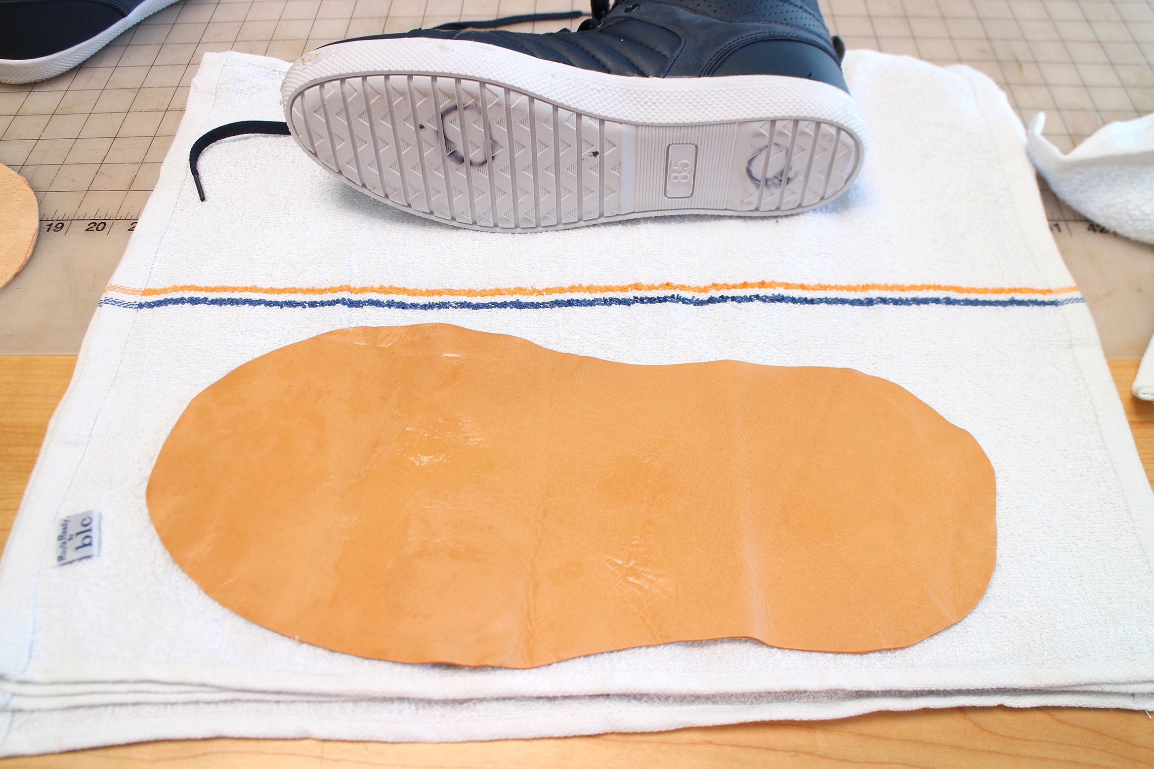

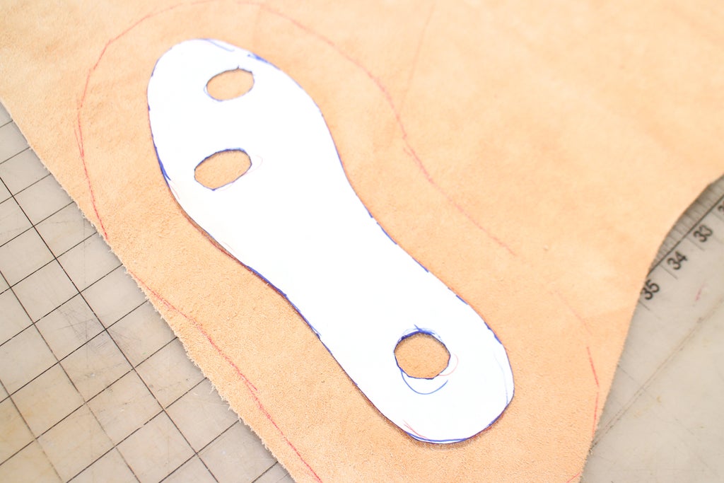

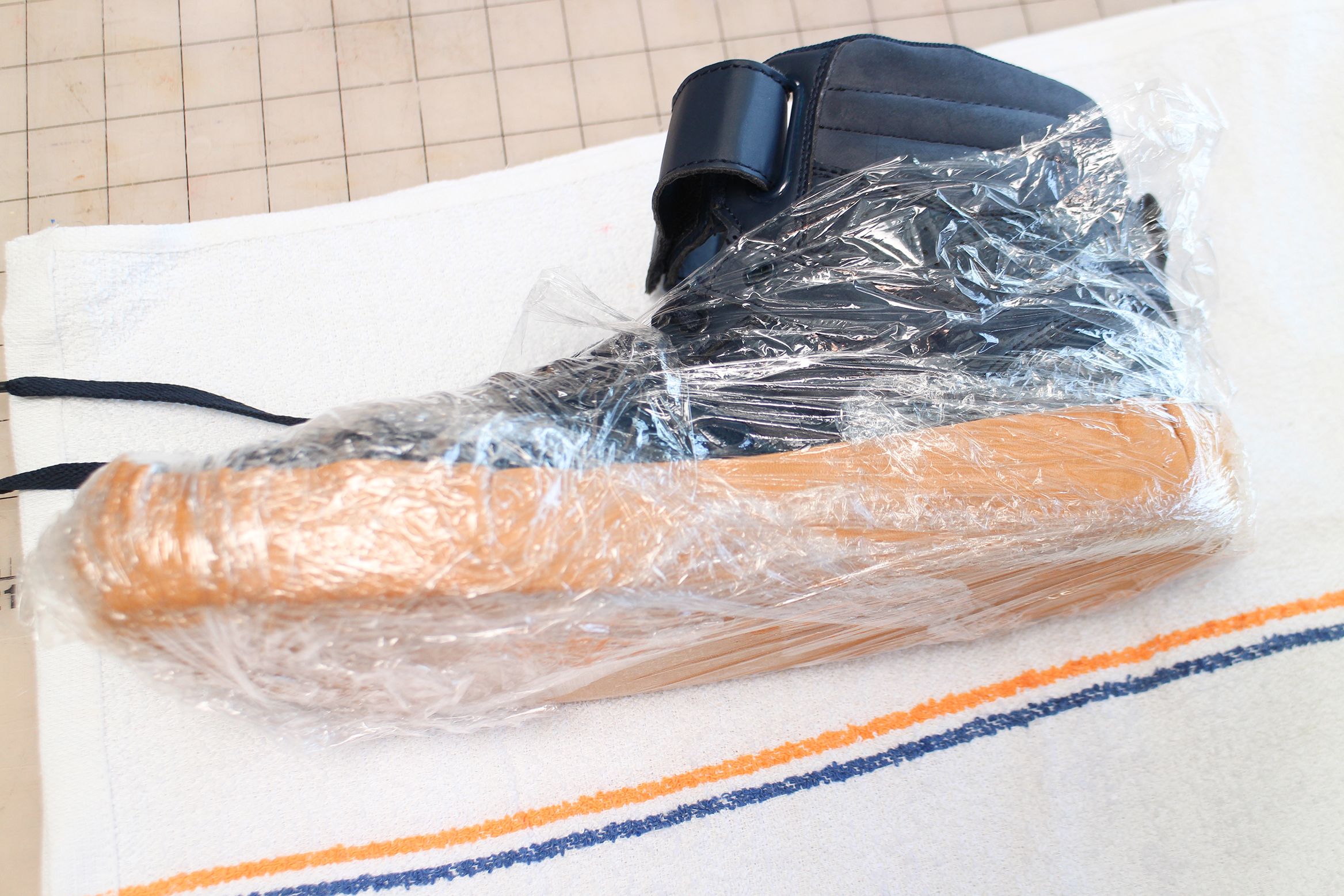

Step 12: Mold Leather
The switch sandwich goes on the outside of the shoe. It was tried on the inside but proved to be too sensitive. It turns out the actual sole of the shoe is a needed barrier between the switches and the force of the foot. This sandwich needs to be attached to the bottom of the shoe and protected. Veg tanned leather is a great material for this because it works well as a sole and can be molded around and up the shoe then sealed in place. Gather these items:
- plastic wrap
- medium sized bowl filled with warm water
- 1 - 2 towels
- veg tanned leather
- cutting tool
- ball-point pen

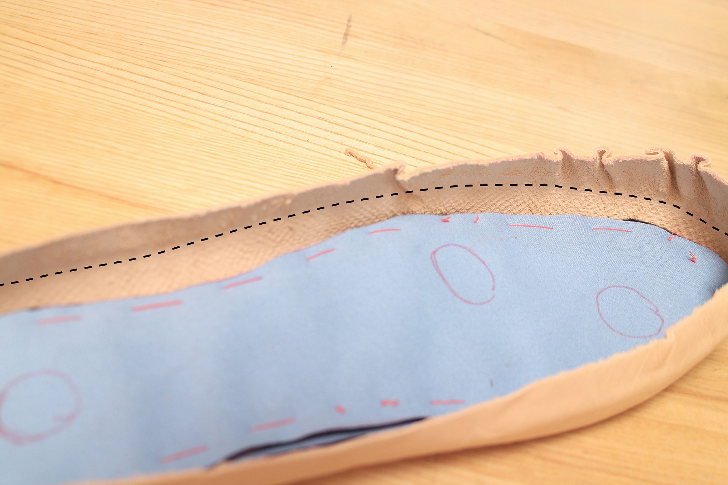

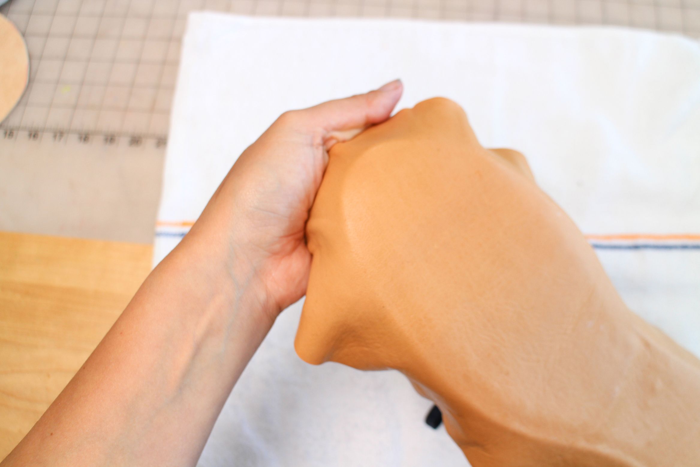

Trace the sole pattern onto the back of the leather then measure and mark a 1.5" - 2" border all around. Cut this piece out, flip it and use it to cut another piece from the leather.

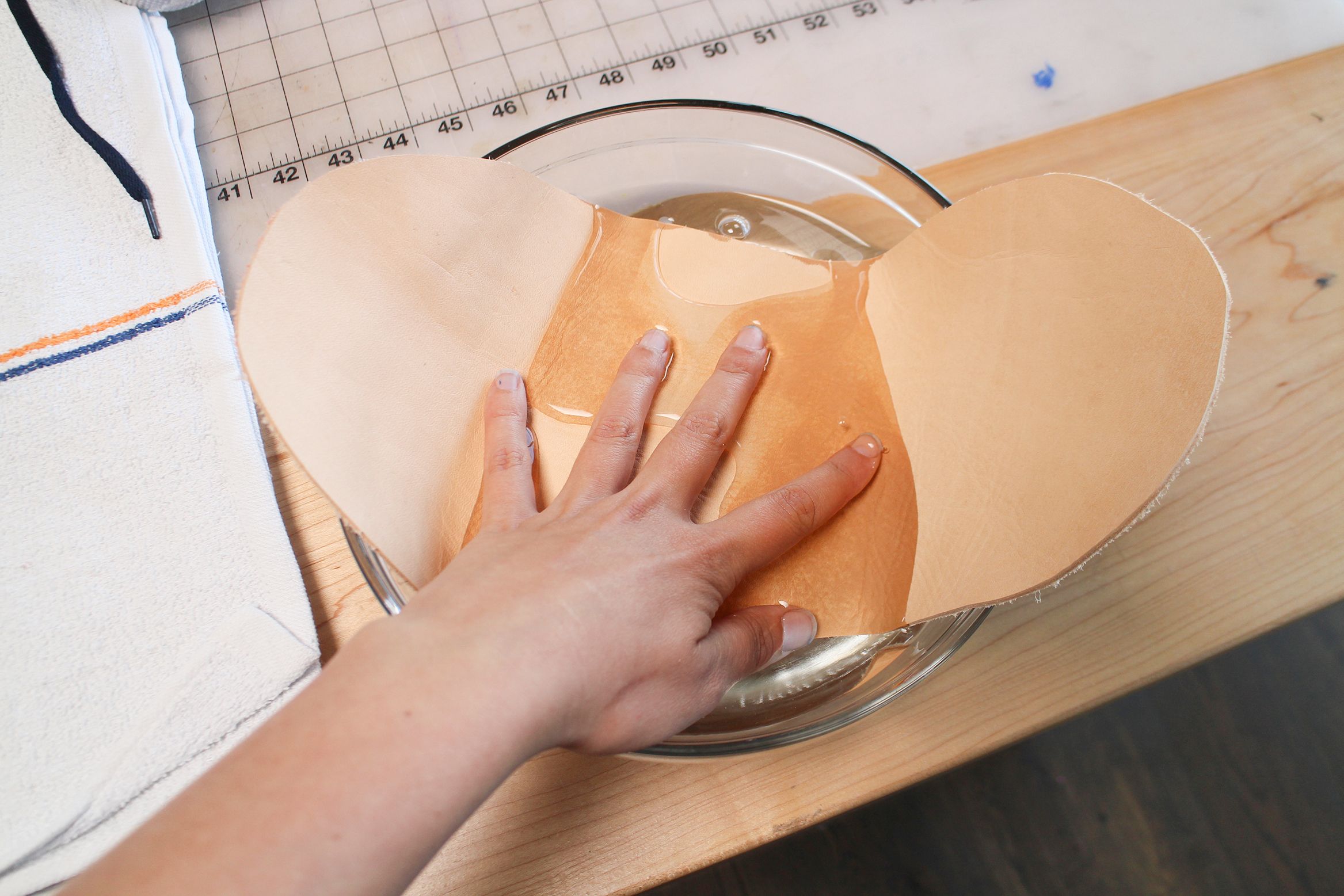

Place the leather pieces in a bowl of warm water and let them soak for a minute. Take a piece out and squeeze out any excess water back into the bowl. Turn the shoe upside down and start to smooth and stretch the leather around the bottom of the shoe. Stretch the leather up and over the sole's edge creating a wall that travels up onto the side of the shoe all around. Smooth out any wrinkles that occur as best as you can, it doesn't have to be perfect. Secure the leather by tightly wrapping Saran Wrap around where the leather bends up the side of the shoe. Let dry overnight.

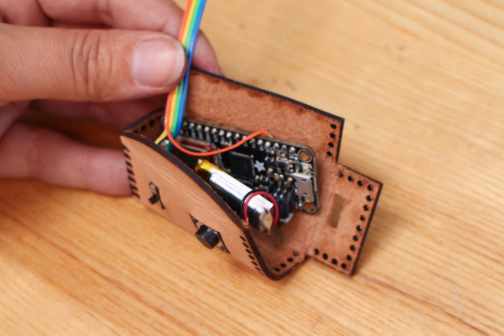

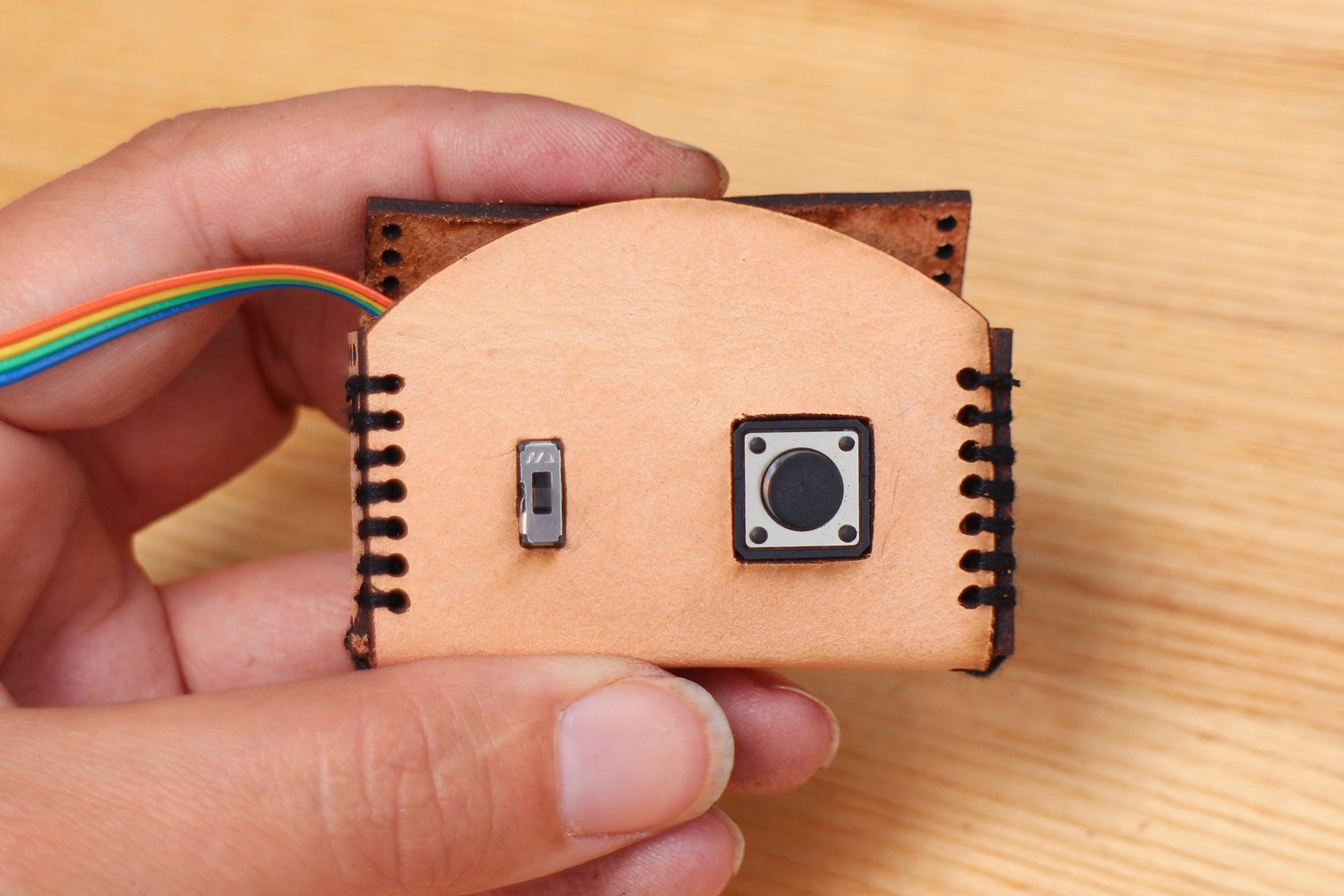

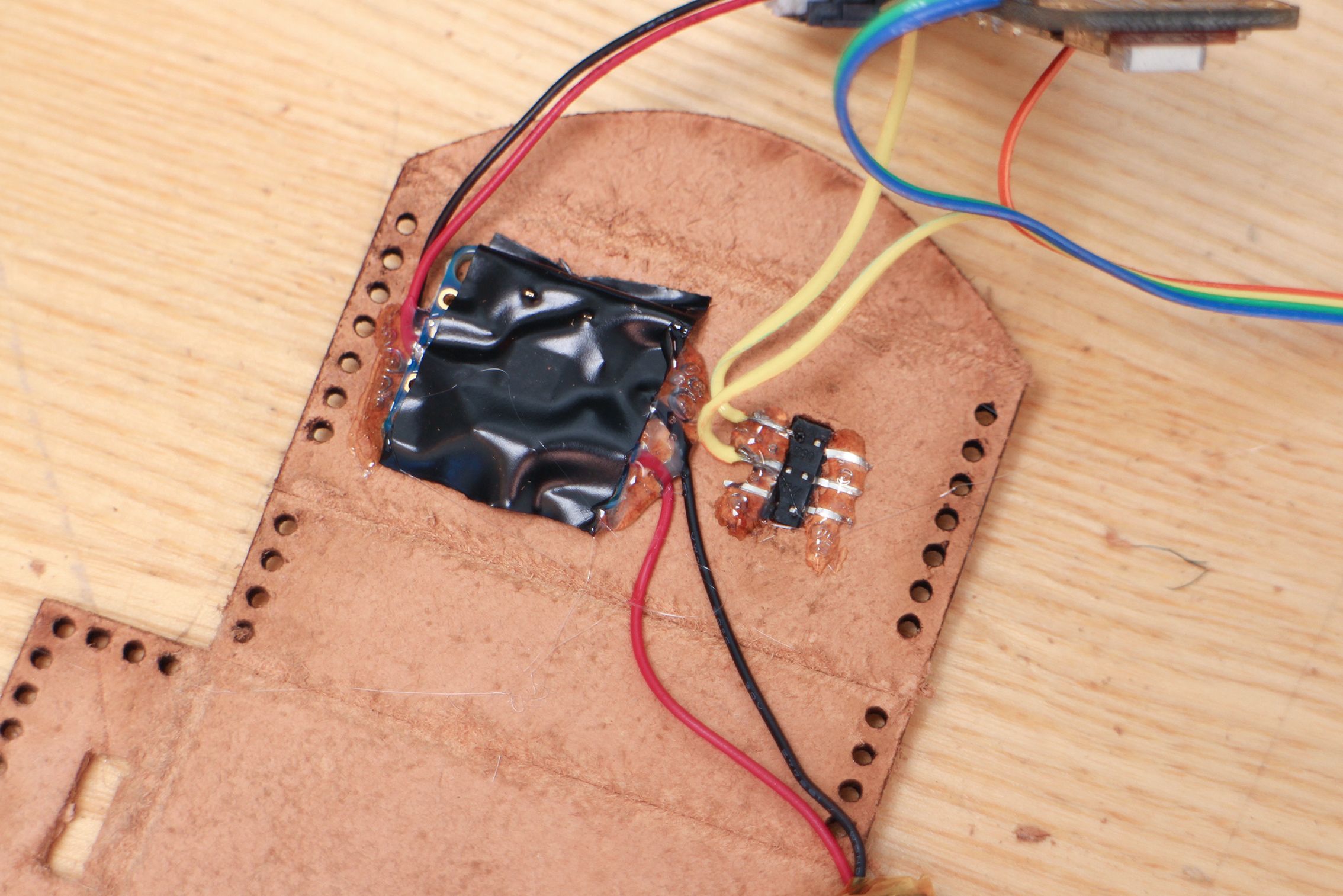

Step 13: Create Cases

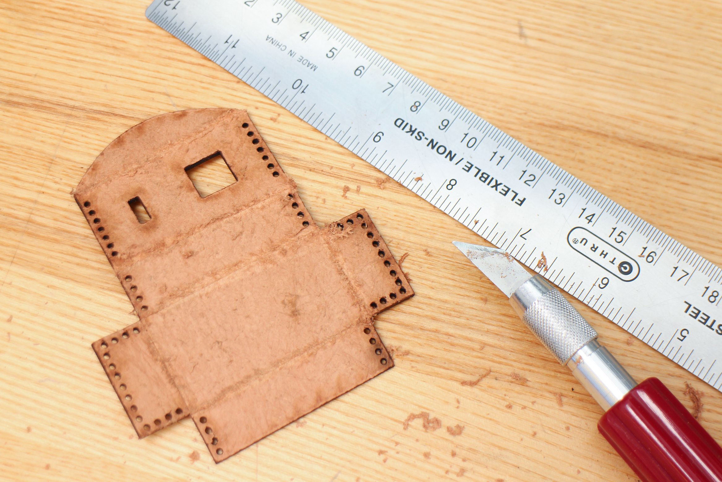

The circuit and battery get tucked into a case which the on/off switch for power and the middle switch also get mounted to. The case can either be laser cut or by hand. To make sewing easier the holes are precut in the leather. I based my design on one made by my awesome leatherworking co-worker Mikaela Holmes. If cutting by hand the holes can be punched using an awl to making sewing a little easier.

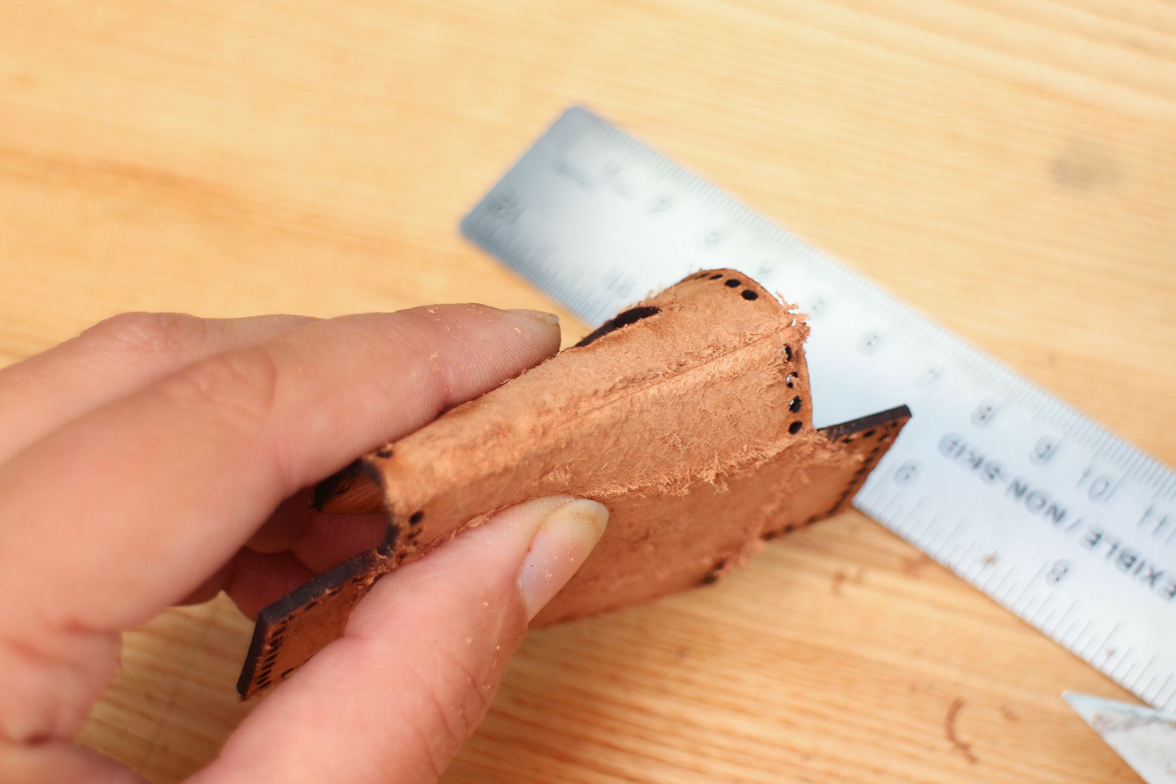

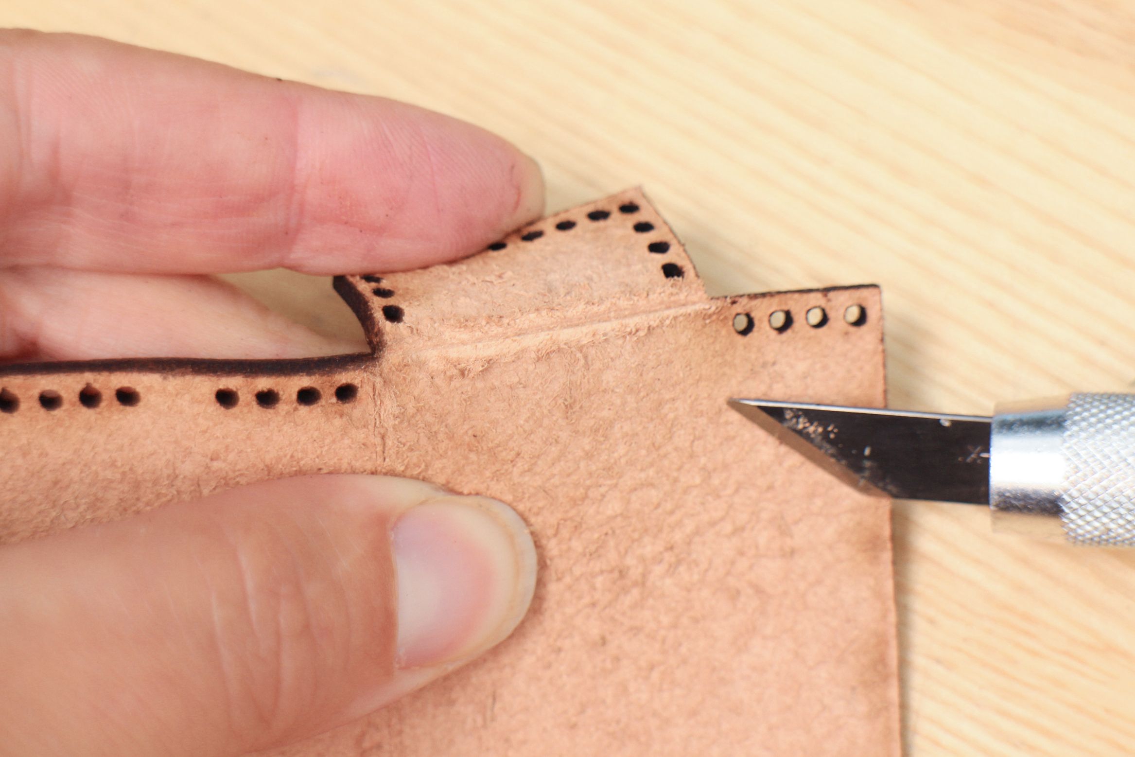

Cut
Use a blade to carefully score where the creases are. Then fold the crease back to open it up and use the blade to shave off the corners of material created by the cut. This creates more room for the material to fold onto itself when bent in the directions it's meant to be. Next, pop in the power pushbutton and slide switch from the back. Press the pin on the slide switch outward so they lay flat. Use hot glue to secure them in place and put some electrical tape over the power switch to cover any exposed metal.

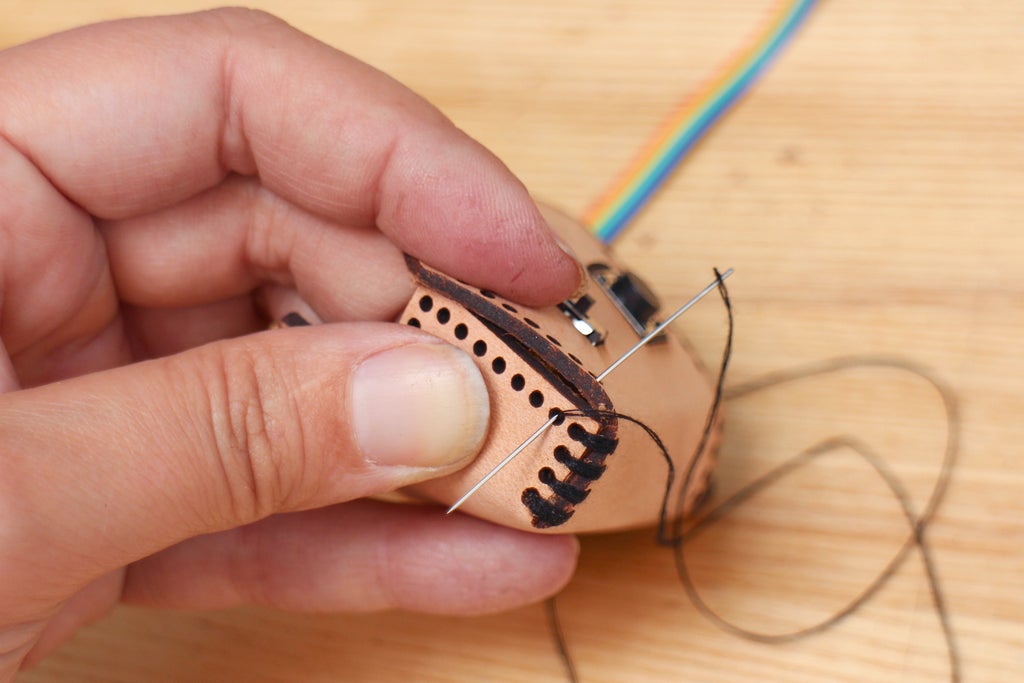

Sew
Double up some thread and knot the end. To begin thread the needle through the first set of holes, grab the end of the thread and make a square knot. Sew together the sides going through each set of holes multiple times. Glue velcro onto the flap so it securely closes over the hardware.

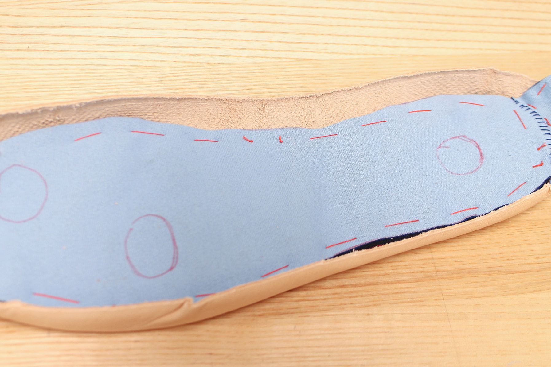

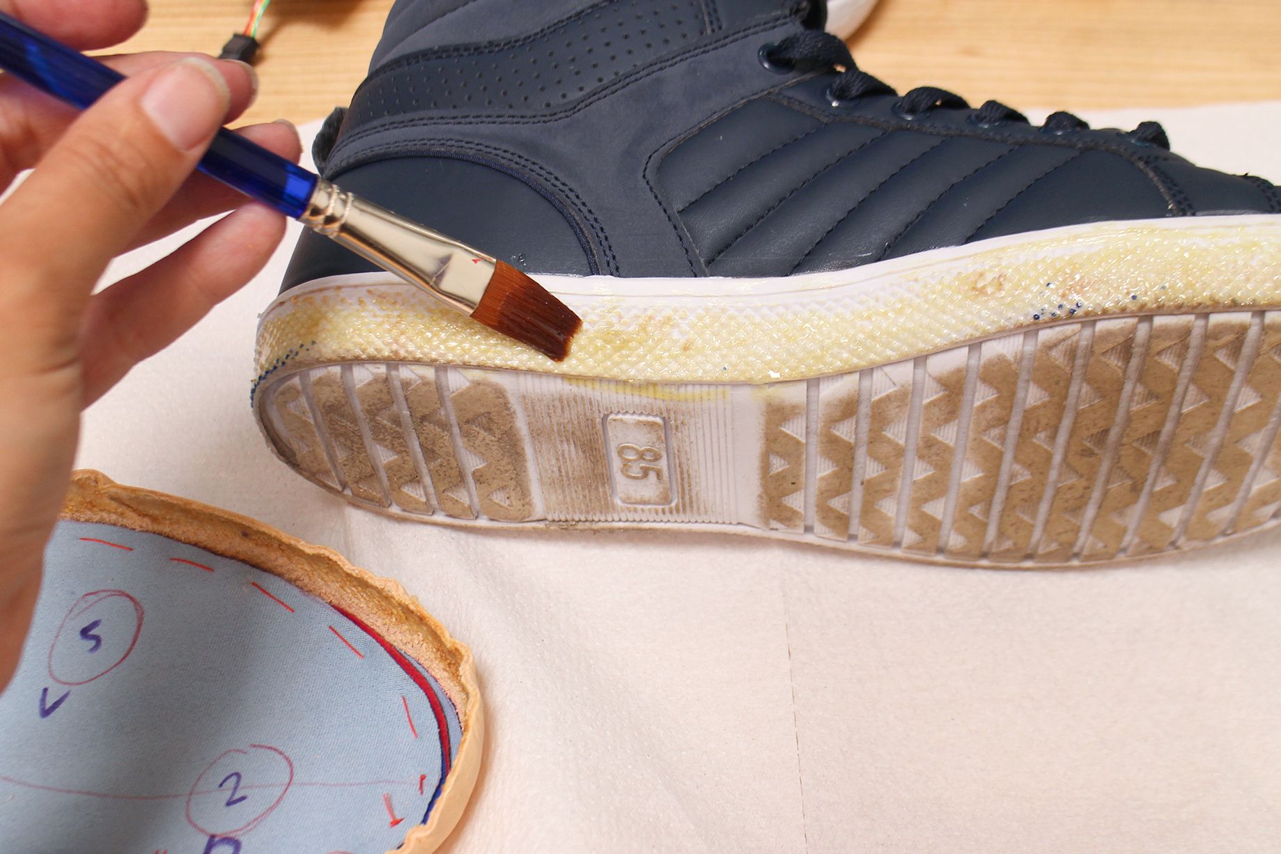

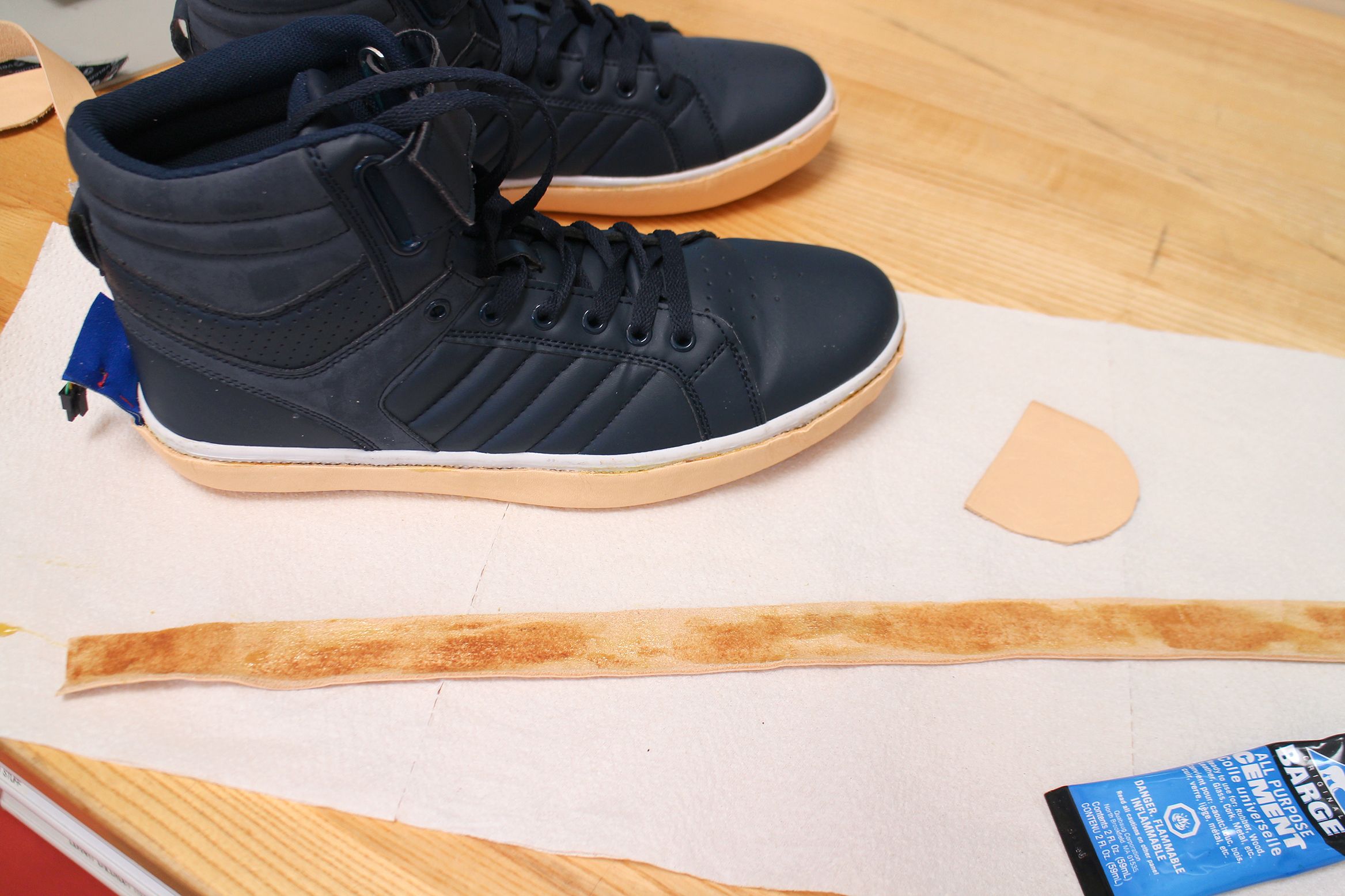

Step 14: Attach Sole Switches

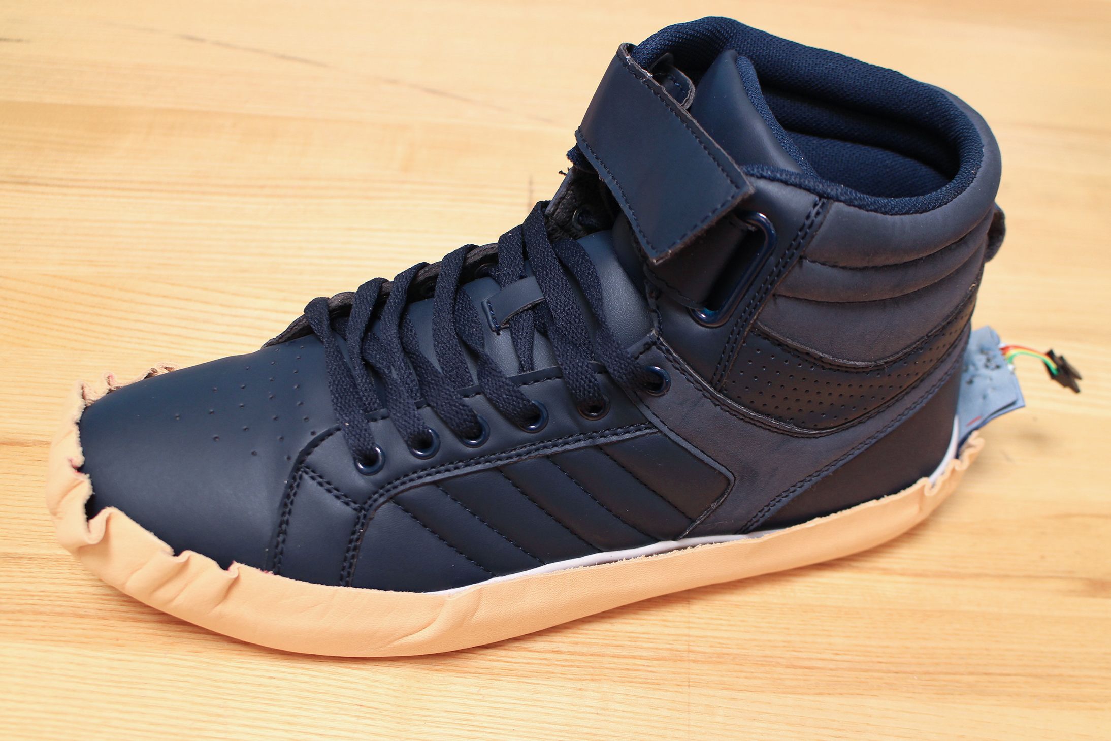

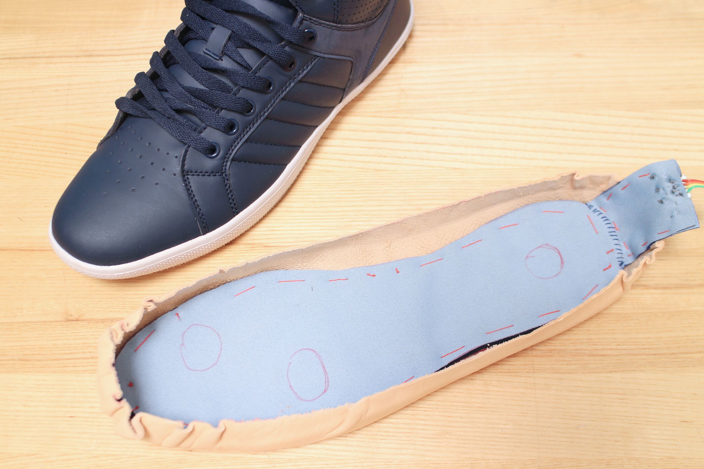

There are three parts to the sole switch case, the molded bottom which you have already made, a strip of leather 1.5" wide and a semi-circle cut out. The strip should be as long as it takes to wrap it around the shoe's circumference where the sole meets and the semi-circle should be cut so it's large enough to cover the heel extension. You can cut out the strip and semi-circle later on.

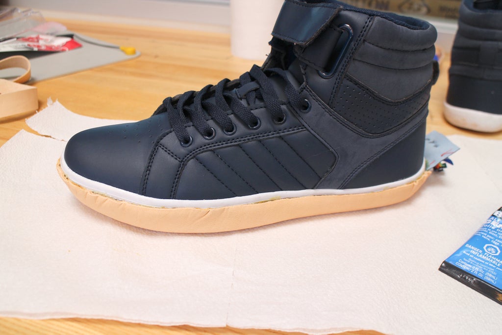

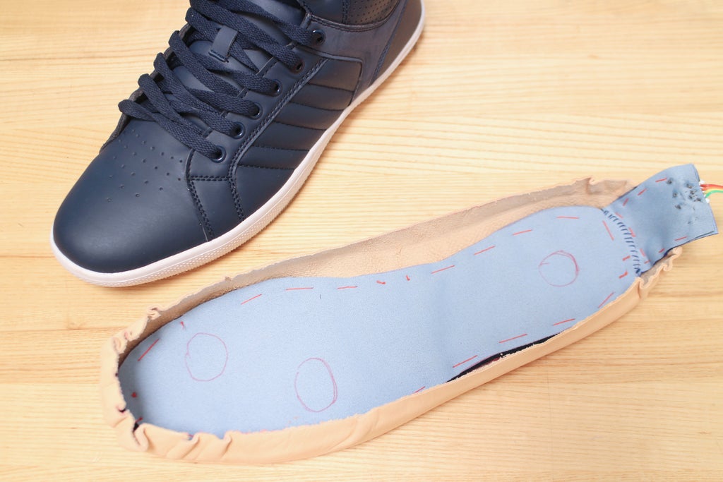

Take the Saran Wrap off and remove the leather soles. Put the sole switches in them and see how they fit. The leather will be folded in some areas, that's ok. They need to be trimmed anyways. Trim the top edge off of the leather soles as much as you can while still leaving about 3/8" above the sole switch. This will clean things up a bit.

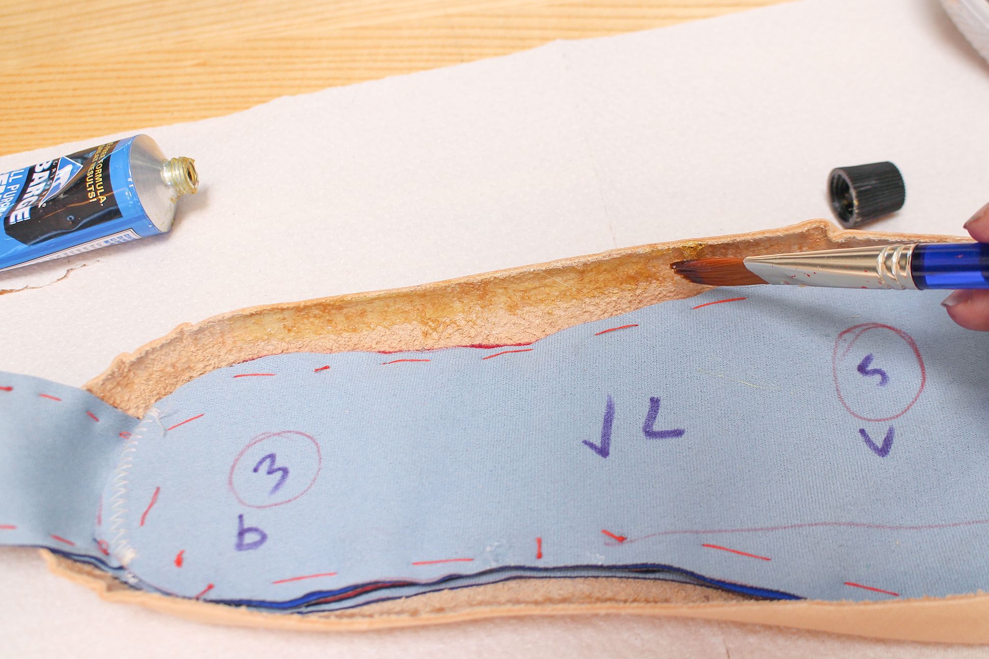

Grab the Barge glue and apply to the inside top edge of the leather sole and on the shoe's side where the sole overlaps. Press the leather sole onto the shoe smoothing out any wrinkles. Apply glue to the leather strip and cover the top edge of the sole with it all the way around to the back. Next, apply glue to the semi-circle and press that over the heel extension to cover it up and secure it to the shoe.

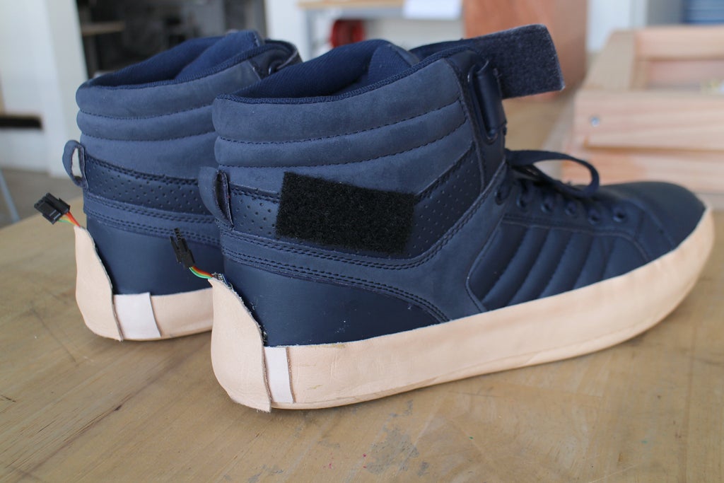

Step 16: Add Case With Circuit to Shoe
Clip the case connector to the one coming from the heel. Stick a length of 1" velcro to the back of the case and on the shoe where you want them to be. I recommend placing them out of the way like on the outer side so they don't get in the way while dancing.
When the battery runs out detach and charge via a micro USB cable using the charging circuit on the Feather
