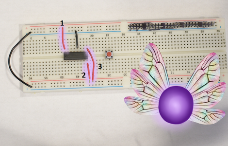

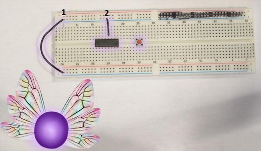

Step 1: Place Your First Wires
Start by putting motor driver IC and pushbutton across the middle dip in the breadboard as shown. Ensure the little dot on the IC is to the right. Additionally make 2 black wires for 1 and 2 labeled in the picture. Tina reminds you that the location of the wires are VERY important and if it is not followed exactly, the circuit could malfunction. The final circuit should look like the second picture.
Step 2: Begin to Expand Wiring
Cut, strip, and bend 3 pieces of wire as shown for wires 1, 2, and 3. Wires 2 and 3 will be 5V coming from the Arduino, where wire 1 will be 5V coming from the power supply to drive the motor.
Step 3: Pushbutton Wiring
Add another wire for the pushbutton ground. Tina always tests her push buttons by pressing it before wiring, to ensure once wired you can press down without issue.

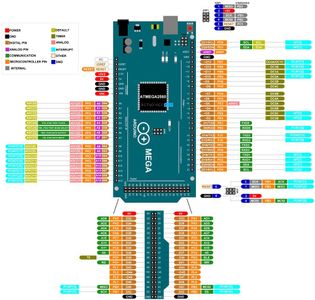

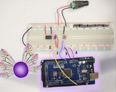

Step 7: Connect the Arduino
Next connect pin 11 from the Arduino to the motor driver as shown with wire 1. Connect the pushbutton to A0 of the Arduino as shown with wire 2. Finally, connect wire 3 and 4 to provide 5V and ground to the breadboard. Tina uses the pin out sheet provided to make sure she connects the wires correctly to the Arduino Mega 2560.

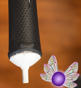

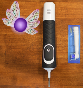

Step 8: Begin to Edit the Toothbrush
Moving the breadboard aside, get out the toothbrush. Tina had a rather hard time opening the box, so if need be use a small knife to open the package. If you are unfamiliar with how to use a knife safely, allow an adult to open your toothbrush box.
Step 9: Begin to Disassemble
This step is a little tricky so be careful! Get a small flat head screwdriver and gently pry up the plastic around the top of the toothbrush head. Once you’ve gotten it loosened up, pull the plastic piece around the metal shaft towards the front of the toothbrush. The cap should now come off.
Step 10: Innerworkings of the Toothbrush
Shown are the three main components to the toothbrush. The cap, the circuit board and motor assembly, and the housing. Tina makes sure she has all the correct parts from the toothbrush before continuing. If your toothbrush does not look like this, or something breaks, you have to get a new toothbrush! Tina does not want her tooth followers like you to get harmed by a wild electric toothbrush.

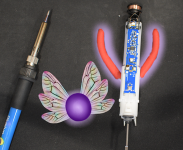

Next up is some soldering, locate the soldering iron from the kit, along with the sliver and blue tube called a ‘solder suck’, along with the circuit board.
Step 12: Heat Up the Soldering Iron
Now that your circuit is open to use, take your soldering gun and turn it to a comfortable heat. This is the setting used on the gun from the materials list, but if using a personal soldering gun, the temperature settings may differ. Tina reminds you not to touch the metal part of the soldering gun, as it can cause major burns. If you do touch this part, let an adult know immediately!
Step 13: Soldering Stabilization
To provide more support with soldering, you can place the circuit in the middle of a pair of household plyers. This is optional, but recommended for those with little soldering experience. Tina prefers to provide support when she solders, to prevent any from slipping and sliding around the circuit and her tiny tooth fairy hands.
Step 14: Desoldering
Now you can begin to remove the solder already present on the tooth brush circuit. Watch one of Tina's helpful fairy's complete this in the video.
Step 15: Soldering Results
If the video is followed correctly, the circuit should now look like this! There should be no solder left on the pads and the plus symbol should be visible.

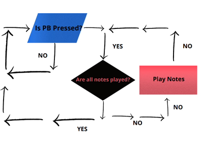

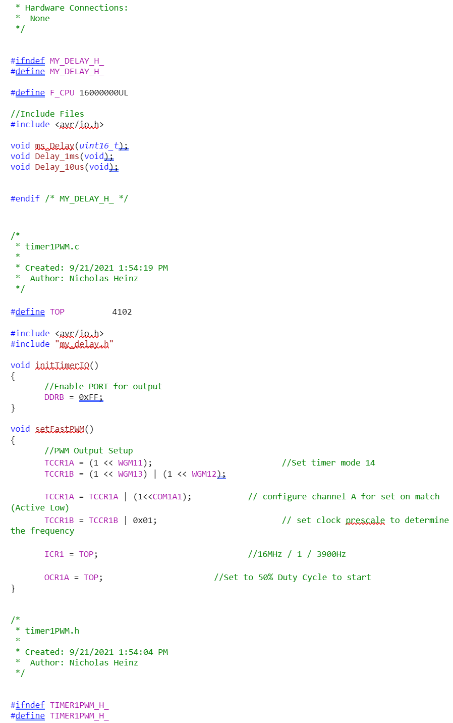

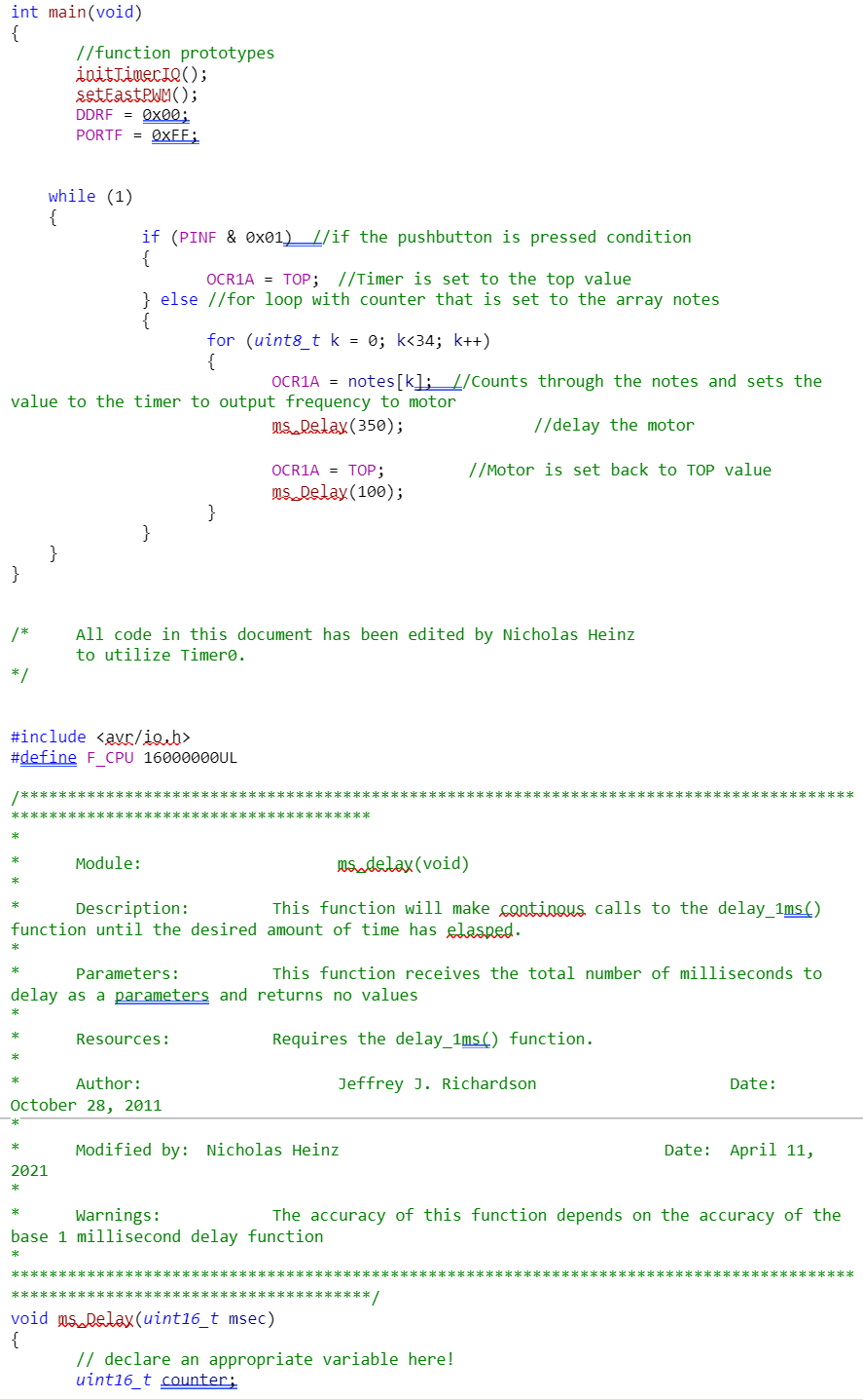

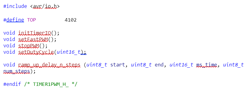

Step 22: Download Code
Connect the Arduino to a computer with the Arduino cable and download the code provided. Tina wrote the code and is happy to share it! (If you want an extra challenge, Tina encourages you to change the music notes for your own song)
Step 23: Code Analysis
Tina wanted to provide an explination to the code and how it works while it downloads to your computer! Comments, which are in green, explain what lines perform what actions in the code.
Step 24: Connect Toothbrush to Breadboard
To make the connection between the toothbrush and the Arduino, connect the red wire to in between the black and yellow wire, and the black wire to the negative terminal of the breadboard.
