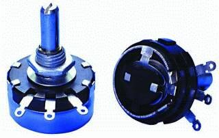

Now here is the part of soldering the speakers and making the volume regulators (potentiometers) functional. You will have two wires from your backpack, a speaker with two connection points (an input and an output) and a potentiometer with three connection points (see picture). Also you'll need some lose wires to solder the potentiometer to the speaker.
First take a lose wire (not to long) and solder is to the first connection point of the potentiometer. Then solder the other end of the wire to the input of the speaker. Then take an other lose wire (also not to long) and solder one end to the second connection point of the potentiometer and the other end to the output of the speaker. Next your going to solder the speaker and the potentiometer to the wires which are already in your backpack. Solder one of the wires which comes out of the shoulder strap of the backpack to the output of the speaker (this will be the output wire, so remember that). Then solder the other wire from your backpack to the third connection point of the potentiometer (this wire will be the input wire).

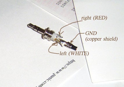

Step 8: Solder the Mini Jack
Now it's time to solder the connection to your Ipod or MP 3 player, the mini jack. First you need to take off the housing of the mini jack and pull it over the wires. If you don't, your won't have any housing on your mini jack, so the wires won't be save and will not stay on there places. Then you need to solder both output wires to the ground point (the big one) of the mini jack. This is the way the electrons will be going back to your audio device. Then take the wire which comes from the right speaker's input and solder it to the right point of the mini jack. Then take the last not connected wire and solder it to the last not connected point of the mini jack. This is the way the music will leave your audio device and go to the speakers. Be sure the wires do not touch each other or make contact, because that way you won't have any music from your backpack. Now close up the mini jack by pulling the housing over the soldered parts.
