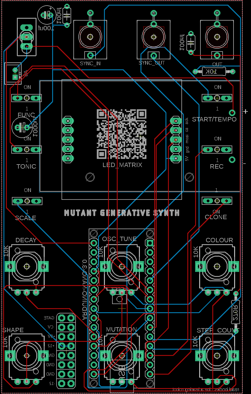

Step 1: PCB, Front Panel & Schematic
Firstly, all the files that you need to build your own Mutant synth can be found in my GitHub Page. This includes the parts list, Gerber files for the PCB & front panel, schematic, Arduino script etc.
The build consists of 2 PCB’s – one is for the components and the other the front panel. You’ll need to send the Gerber files to a PCB manufacturer like JLCPCB (Not affiliated) who will print the boards for you. Jump into my Google Drive link, download the 2 Gerber files to your computer and then send them off to your PCB manufacturer of choice.
If you have no idea how to do this well, I've put together an Instructable on how to get your broads printed which you can find here.
NOTE: The manufacture will include an order number on both the PCB and front panel. It doesn't really matter where it is on the PCB but you don't want it on the front on the front panel!
Over at JLCPCB you can 'specify a location' once the Gerber files have been loaded so click this for the front panel and the manufacturer will add it to the back where I have indicated.. You can also just hit 'No' when asked if you want to remove the order number. However, this costs $2.
Front Panel
As mentioned, the front panel is actually just a PCB without the components! I use the silk screen on the PCB to print the design and then included drill holes for the components. All this information is in the Gerber files for the front panel which the manufacturer uses to print the board.
If you are interested in creating your own front panels then I highly recommend watching this YouTube vid. I watched it as couple times and also put together a step by step guide for myself which I have also included as a PDF in this step.
In my GitHub Page you will also find the Eagle schematic and board (PCB) files. You can play around and modify these if you like.

Step 2: Adding Components to the PCB
The PCB is 2 sided. The front has all of the active components like the pots and switches and the reverse has the passive components like the Arduino, caps and resistors. As some of the components are underneath the Arduino and (9v battery holder (if you install it), you have to be aware of the order that you solder parts into place.
Let's start with the reverse side and add the passive components:
STEPS:
- Always start with the lowest profile components - in this case (in probably all cases!) it's the resistors. Solder them all into place and check the values before soldering so you don't have to troubleshoot the parts later if something goes wrong! There's only 2 resistors as well!
- Solder the capacitors into place. If you find that the 1000uf cap is sitting up too high you can always solder it into place so it is lying down
- If you are going to power the synth via the 9V battery then you can also solder that into place. If not, then solder the JST header into place.
- You may have also noticed that there is a double row of holes (16) in the board as well. This is in case you want to power it via a Eurorack power board.
- Now you add the header pins for the Arduino. The best way to do this is to connect the header pins to the Arduino and then place them into the PCB and solder into place. This way they will be straight and in the correct position
