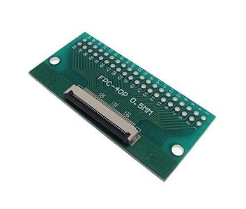

There are 2 chip needs to be programmed, ESP32 and the EEPROM. You need 2 part
  1. FPC brakout board - 40pin/ 0.5mm pitch
  2. FPC cable - 40pin/ 0.5mm pitch ( same connection orentation)

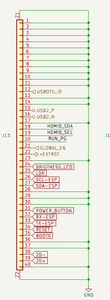

You have to use the Debug FPC Port to flash them. See the connection required to flash them in the pic above. You can use a FPC breakout to make the connections.
Flash ESP32-S2
Follow this guide to flash the ESP32-S2. This is the firmware code
  1. Firmware
Connection required from the Debug FPC Port
  1. RX-ESP
  2. TX-ESP
  3. RESET
  4. BOOT0
  5. GND
  6. POWER_BUTTON
Power the PCB using the changing USB-C port. Now connect the POWER_BUTTON pin to the GND to power on the device. And connect rest of the connection to flash the ESP32.
Flash EDID
To flash the EDID EEPROM follow this guide from Adafruit, use the code as it is.
  1. Flashing/ Editing the EDID
  1. HDMI0_SDA
  2. HDMI0_SCL
  3. GND
  4. POWER_BUTTON
Power the PCB using the changing USB-C port. Now connect the POWER_BUTTON pin to the GND to power on the device. And connect rest of the connection according the guide to flash the EEPROM.
