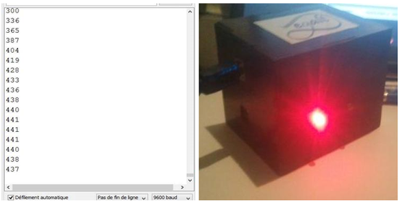

the integer variable SensorValue represents the current value at the sensor, it has been initialized to zero. By visualizing through the serial monitor, we can choose a decision threshold at which the gas will be assumed rate sufficient to trigger the alarm.
It places the analog value sent by the sensor on the A0 sensorValue variable. This allow to display it on the monitor with Serial.println function (sensorValue, DEC) stating that the display should be in decimal. From this view we fix our decision threshold
After some tests with a simple lighter we noted that the value 300 well suited as a threshold. Indeed one hand, if the threshold is too low, the alarm may trigger oddly without good cause. On the other hand if it is too high, it will take much more gas for our system to detect it. However remember that it will take more rigor on bench-marking for efficiency and reliability of my system. It then sets the conditions and the corresponding commands:
-If the sensorValue value is below the 300 threshold decision then the gas rate is normal, everything is fine and the green LED is lit while the other components are off.
-If, against the sensorValue value increases and reaches or exceeds 300 then the red LED and audible alarm are activated and the green LED is off it there's leakage. These two components are illuminated nearly simultaneously and intermittently.

The system test phase has been satisfactory; everything works well once the program flashed on the board. The green LED illuminates when all is well and the sensor monitor series gives the value 127
Using a lighter to present a little gas around the sensor while viewing the value read with the serial monitor. Note while the value increases more and more and as soon as the value 300 (threshold) is reached the green LED turns off and the red LED will flash and the buzzer sounds: " there's leak detection ! ;p "
