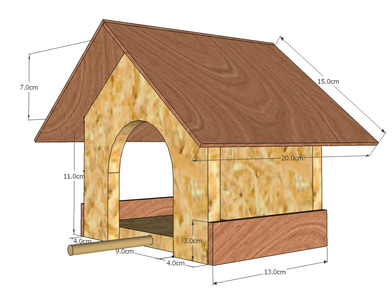

The design as Corel Files are attached, also the SketchUp drawing

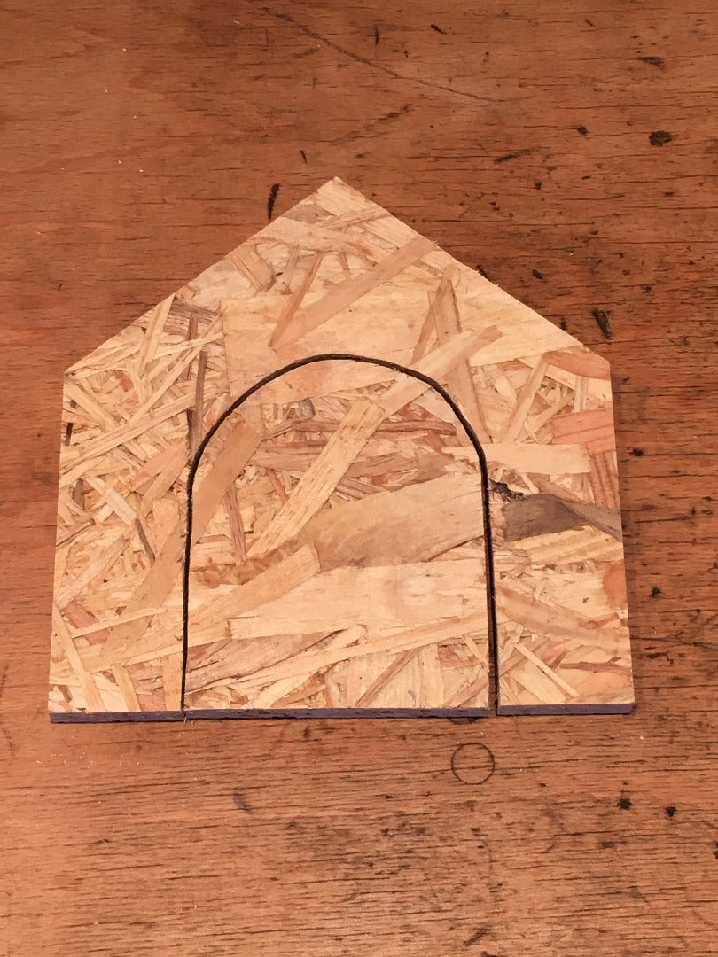

Step 1: Prepare and Cut
Material:
it doesn't really matters which shape and size you're using, however I made mine out of OSB plates, MDF for the roof and tar paper for protection. Finally some hazelwood sticks and stone gave the whole a nicer look.
Of course you need some screws (2.5mm x 20mm + 3.5mm x35 mm) to fix anything.
Prepare material by cuting the material in the right size, form and drill accordingly.The attached ZIP file contains the drawing in more details.
The second ZIP file contains the SketchUp Drawing and also the CDR Files for Laser Engraving

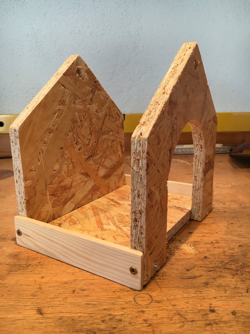

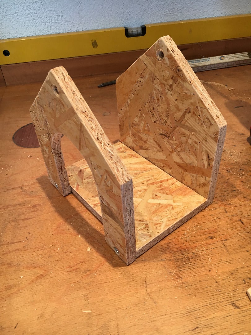

Step 3: Mounting
As you already have drilled all the holes, it is easy to mount all parts together. It figured out that slightly larger screw for the front and back side are more useful.
Mount also the small side wood - this will prevent the fodder to fall outside the house once it swings in the wind.
The roof shall be assembled in a way, that the woods are touching at 90°
