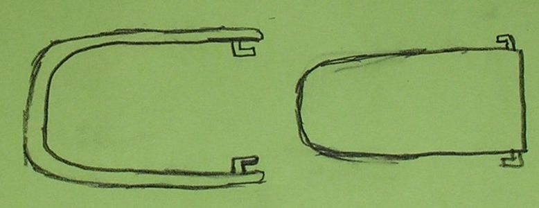

Getting the cover of this thing is a major pain. No screws, just some really long, annoying L-flanges keep it in place. There are also some tabs that catch on some of the vent holes, but these are easily depressed.
The easiest way to separate the flanges is to gently pry the cover away with one screwdriver and push the flange down with another. Using this method I was able open the enclosure with minimal damage to the plastic.

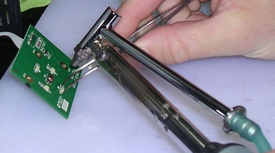

Before removing the LEDs, I took quick measurements while the drive was on with my trusty multimeter to get the voltage. I then ordered some suitable red replacements that would fit the leads on the board.
Removing the LEDs was not that hard. I tried a hot air "pencil" that I made from an air pump and a desoldering iron, but the solder failed to flow completely. Because of this and my lack of patience, the first two LEDs I took off brought one the leads from the board with them. I switched to a real soldering iron (WESD51) and had no problems thereafter.

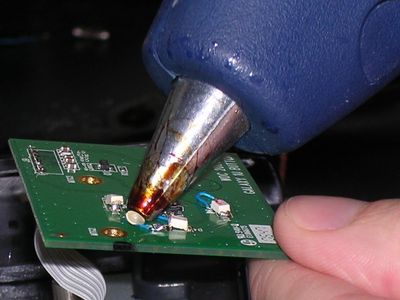

Putting the new LEDs on was not that big of a deal, either. My procedure:
1. Tested and marked the LEDs to know which end is which (anode / cathode).
2. Tinned the LEDs and the leads on the board.
3. Flowed the solder on one of the board leads and slid the LED into place.
4. Heated the opposite side of the LED until the solder flowed together with the solder on the board.
As you can see, my job is far from perfect - even on the two mounts I did not rip the leads off the board. I think most of my problems stemmed from using too much solder, especially when tinning the board.
On the two mounts that lost a lead to my carelessness, I simply used a wire to jump over to the resistor. I then used hot glue to minimize the wires getting stuck on anything and coming off when I put the cover back on. Besides, I was going to have to ship it to my friend, so the more stable the better.

Then I tested it to be sure everything was functional, and slid the cover back on. Voila, a red My Book.
