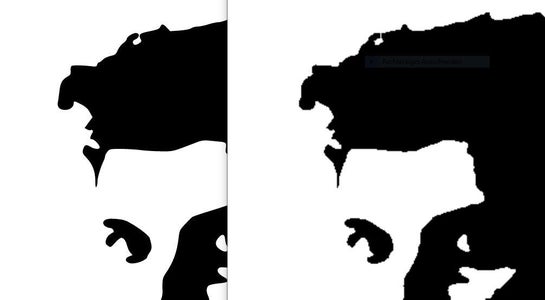

Here is another teaching moment. We discuss the difference between pixel/raster and vector graphics and when to use one or the other.
I use convertio.co or freeconvert.com/gif-to-svg/ to convert the GIF into SVG.
I have tried many online converters and those two are the best. If you want to have a whole class convert their images in one network at school, convertio will display a limit and stop converting files after the first 20 or so images.
Now the children can see the difference between the GIF and SVG when they open both in a browser window side by side and zoom in.
You also can use InkScape to trace pixel images into vector graphics. Using a converter is just the easy way. There are also converters that will output perfectly useable DXF files.
