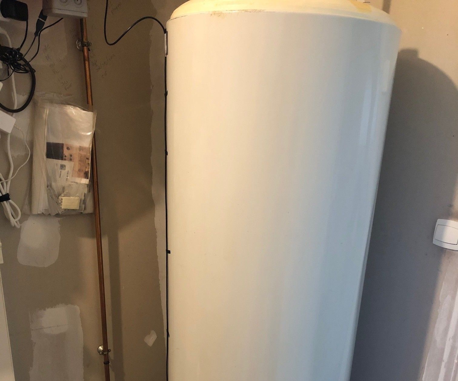

Step 12: Design Ipad Jeedom
Formatting of my design displayed on my Ipad used to control my Jeedom home automation box.
On this page you can see my 7 heating thermostats, as well as the management of my water heater and the heating of my swimming pool. All done with Shelly1pm. Really great these modules.
Our presence being managed by Jeedom with Nut bluetooth, wifi and our geolocation, the heating will therefore be entirely optimized according to our presence.
