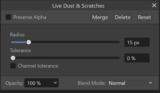

Now navigate to the right part of the screen and find the live filters as highlighted in red.
We will use Two filters to make our graffiti super realistic !
  1. Diffuse
  2. Dust & Scratches
Set the Diffuse to 1% or 2% and Dust to 15px

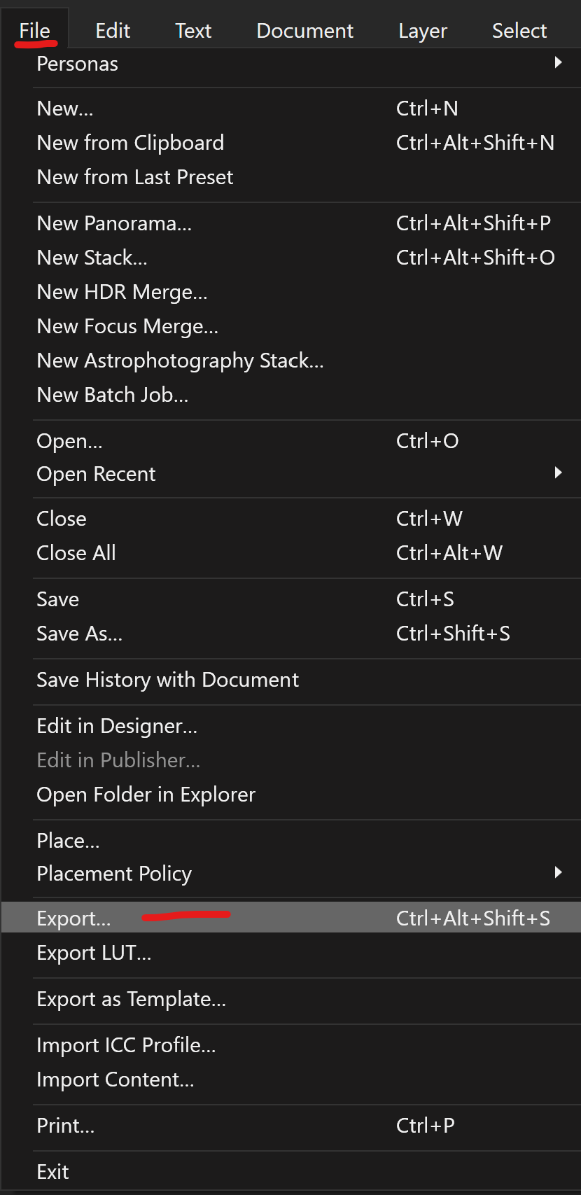

Step 7: Export Your File
Go to the file tab again and click on export.
Find the JPEG format and click on export.
