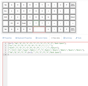

Step 1: Knowing the Matrix
Keyboards have a specific way of communication which is extremely important to understand when developing your own custom layout. Switches send signals to the microcontroller in which each pin input access a part of the code to output the specific signal the switch sends. The easiest way of creating these circuits is to directly wire the individual switch to a designated input pin. The problem with that is that larger keyboards would have switches that outnumber the amount of pins on a microcontroller, hence the keyboard matrix.
This matrix sends signals in terms of rows and columns, where each number of rows and columns are instead connected to individual pins. Here, the input from the switches send 2 signals from their row and column which works like a coordinate map. For my keyboard layout, I have a 5 by 12, 5 rows and 12 columns. In total, the amount of pins that this layout would use is 17 (5 rows + 12 columns). This drastically decreases the amount of pins needed from 59 total keys --> 59 pins to 17 pins. For even larger layouts it is best to keep in mind how many addressable pins are on the microcontroller you are using to prevent the case where the amount of rows and columns on the keyboard outnumber the pins. Finally, with the knowledge of the matrix, you can start creating your keyboard layout.
For the CAD developing software I am using, I needed to have raw data of the keyboard layout that I am using. I used the website, Keyboard Layout Editor which can edit a keyboard layout design for you. It doesn't matter what keys are displayed as long as the overall layout corresponds to the position of each key is. Once you are done, keep a copy of the raw data found in one of tabs on the editor.
Step 2: Creating the Keyboard Casing
The first step to creating this DIY keyboard is to develop the casing for it. With this online builder, we can input a plate layout and adjust settings in accordance to the materials we use to develop the CAD files for the casing. The layout comes from the previous step where we copy and paste the raw data into the plate layout section. For the case type, I made a sandwich design with 10 mount holes with M3 diameter. I selected the bottom and top layer CAD files as I didn't need the other pieces as I had standoffs to connect them. From there, I laser cut them onto the 1.5 mm thick wood sheets I had.

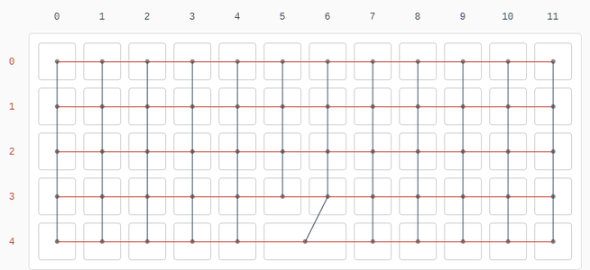

Once all of the pins are removed, we should next keep note of where we are routing our wires. Keep note of which row/column is connected to which input pin as it is very important when approaching the firmware process. From there, we can start soldering the wires from the microcontroller to the rows and columns. It doesn't matter where you solder the wires on the lines, but make sure each row and column has one line connecting to one pin on the Arduino. I found this the most difficult step, but one tip I have when completing this part is to solder the rows and columns nearest to where you want your microcontroller to sit, then work towards the further ones. Remember to also add a power and ground wire to the Arduino if you would like to create the analog RGB control for the backlit effect.

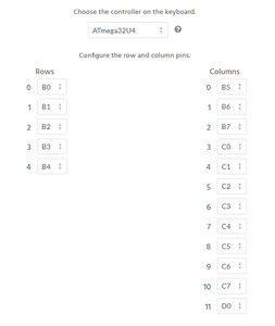

Finally, when everything is wired up, you can start the process of flashing the keyboard firmware onto your keyboard. Here you would need to install the QMK toolbox for Windows and Mac in order to compile the keyboard code onto the Arduino safely. I used the Keyboard Firmware Builder online to develop the code and custom layers for each of the keys on the keyboard.
On the website, refer back to the raw data you had when you created the CAD plates for the keyboard. You would need the same collection of text to import the layout onto the website. From there, we can check over the wiring on the wiring tab. Then the next step is to deal with the pins.

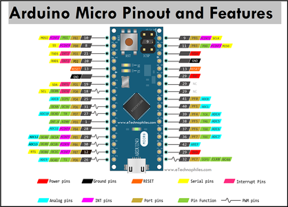

The controller on the keyboard is run by the ATmega32U4 datasheet installed on the Arduino chip. The row and column pins are different from what the Arduino has on the printed pinout guides on the microcontroller. If you refer to the pinout diagram in the picture above, the port pin section has the pin codes corresponding to each pin listed. With this data, select each of the pin codes corresponding to each of the pins on the microcontroller that is connected to the specific row or column to generate the first part of the code.

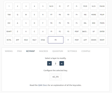

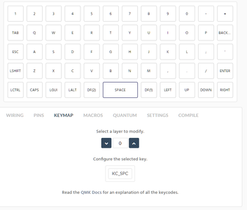

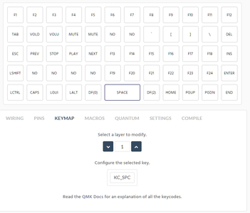

Next is the keymap. Here is where you can design each individual key input to your own preference. The layering aspect can be edited as well through the selection of QMK functions on the website. You can select different layers to modify and include a layer switch button to switch between the layers of keys you placed on the layout. You can refer to my layout with the file attached, or the pictures of my layout above.
Finally, you can name your layout and download the Hex code to compile on the QMK toolbox. You first, select the hex file in the directory, then you flash your microcontroller by pressing the reset button on the microcontroller. Hit flash on the QMK toolbox and if the flash is completed, you can test the keyboard with the key tester that is also on the QMK toolbox. Check if every key works and corresponds to what you designed on the firmware.
