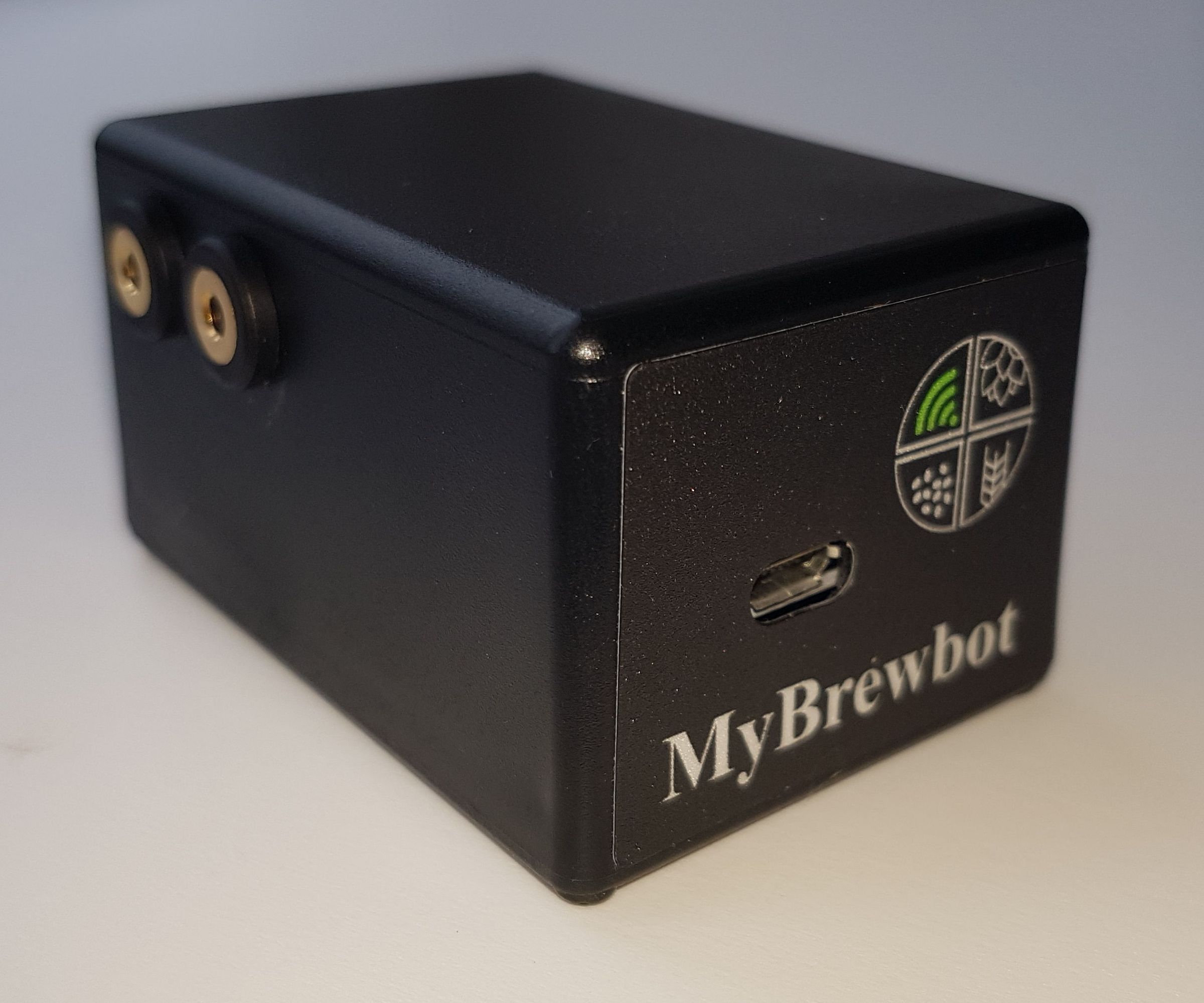

Introduction: My First IoT Device
In this Instructable we will learn how to install Arduino IDE for the My First IoT Device so by the end we can run arduino code on it and control it from your mobile phone.

To run My First IoT with Arduino we have to select the Board NodeMCU 1.0 (ESP-12E Module).
This can be done by scrolling down, as shown in the figure above. Press return
Step 6: Connecting to the PC
Connect the MyFirst IoT controller to your computer using the USB cable . When it connects the COM port will be detected and you should see your PC loading the appropriate drivers. Once that has completed go to the device manager and note the Com Port in use (shown in the above figure)
