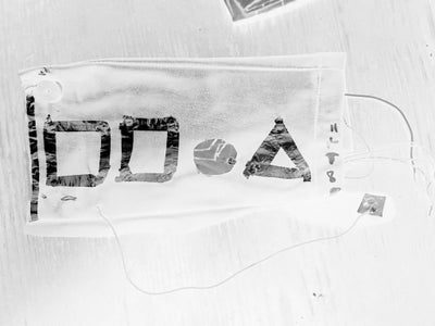

The Controller- There are three shapes, square (2), circle (1), triangle (1). Once connected to Ableton Live, I would like the squares to be a symbol for rhythm (the students will map it to some kind of drum output), the circle would symbolize effects (reverb, cathedral, distortion, etc), and the triangle for auxiliary instruments or samples.

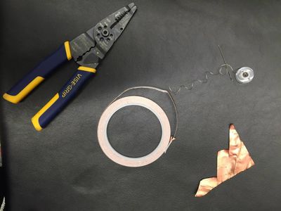

Step 2: Materials
Conductive Thread
Copper Tape
Roofing Copper
Recycled Pleather
Piezo
Solid Core Wire
Glue Gun
Soldering Iron
Wire Cutter
Glove or finger of a glove (I cut out of finger of the glove)

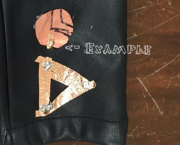

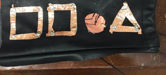

Choose your design and use a conductive material to form it. I used copper tape, but you could use conductive thread, conductive fabric, or other conductive materials.
If you choose to use copper tape, make sure to solder all of the places where you need to make corners, and where you overlay two pieces

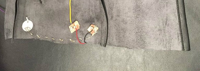

Strip one side of your button wires .5 centimeters or so (you will need 4)
Pierce it through the backside ("ugly side") of the fabric and solder it directly onto the button.

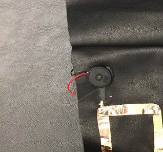

Solder solid core wire to the power side of the Piezo. This will be your digital pin.
Step 6: Almost Finished!
Hot glue your piezo where you would like it to go
Like what you did for the button, Strip one side of the wire about .5 a centimeter and pierce it through the "pretty side" touching it to ground

To mask solder joints on the button side for a sleeker appearance, you can put copper tape on them.
