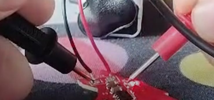

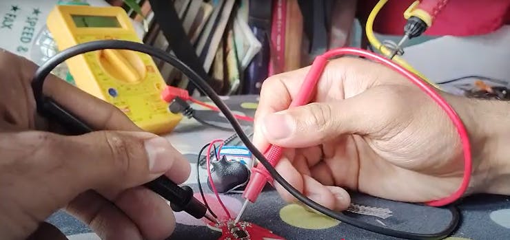

I have made a design error, I have been trying to figure out the what the problem was, I actually spend a coupleof days, and while I was checking continuity on the board

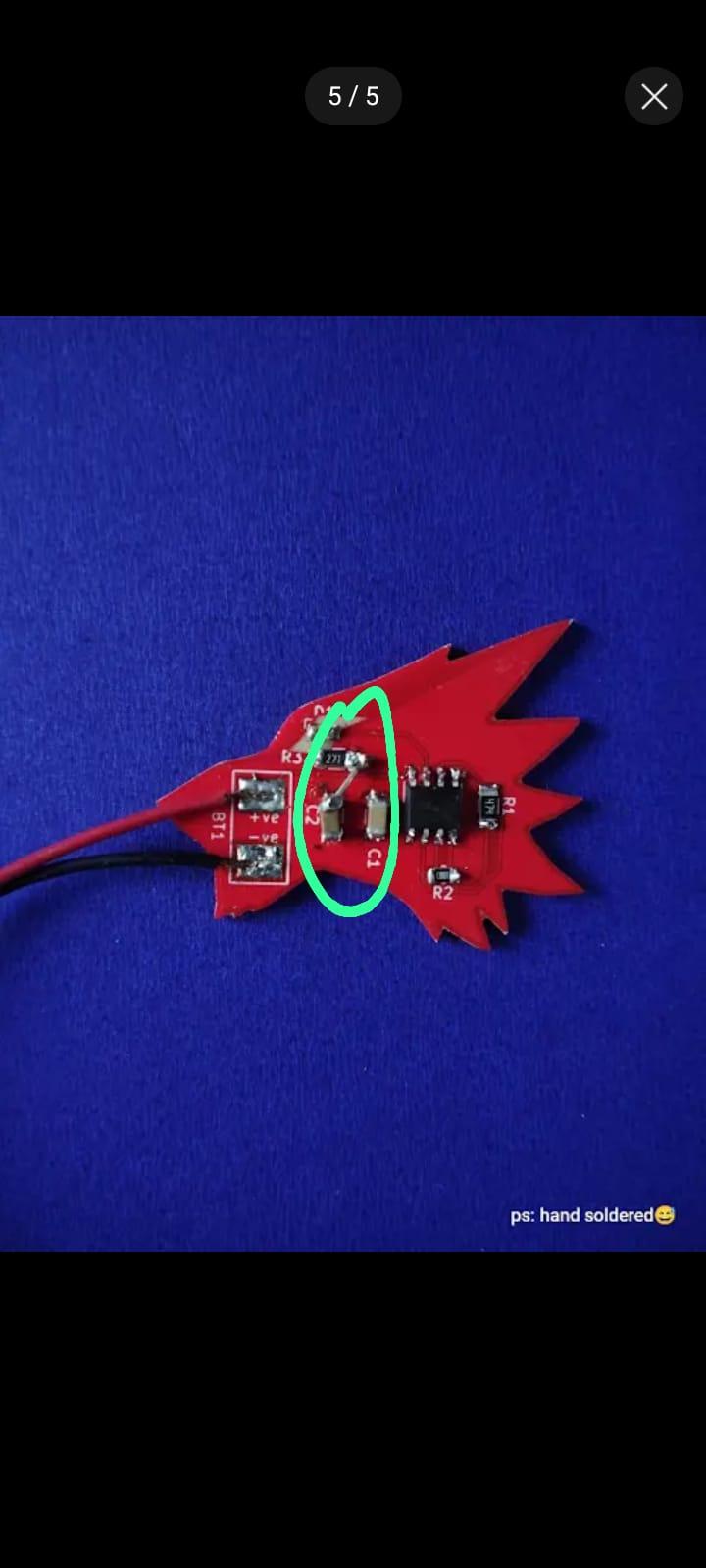

only in one part there was no continuity, between this capacitor and the led, as I looked into it I found that the copper pour for the gnd wasnt complete there(i used copper pour for gnd connection).
This happened because the copper traces the way I arranged the components actually isolated that area from getting the copper pour, I understood my mistake, you learn from mistake.
