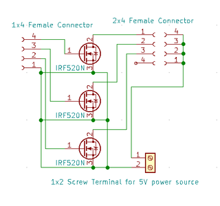

I've started from the part which I knew worst - working with pumps. It is possible to drive the pump by directly connecting it to the digital output pins of Raspberry Pi or Arduino. But they provide not so much power, and also, it is usually shared between all the pins. So, if I try to work with more than one sensor or an actuator (pump or screen), then the power is lower for each of them. That is why I decided to use the trick described in the Arduino starter projects - using MOSFET to let logical pin from Raspberry to control higher power connection for the pump. As I learned from this experiment - MOSFET cannot be easily controlled from the Raspberry Pi board, because MOSFET is triggered only when ~5V is applied to it's gate pin, while Raspberry Pi has only 3.3V on it's logical pins. So I had to use Arduino to control pumps. Using 3 MOSFETs, bunch of wires and connectors, I was able to build first driver for three cheaper pumps. It uses external 5V USB charger as power supply for the pumps.
After some experimentation, it turned out, that cheaper pumps were able to lift the water higher than 60cm. I wanted plants to get as much sun as possible, so I wanted to keep them on the level of the windowsill. Also I wanted to have 3 buckets of distilled water, 5 liters each, as a supply. I could not fit them close enough to the plants, so I had to have an intermediate vessel above the main supply, and below the plants to be able to use cheaper pumps.
That is why I had to construct one more driver with 12V power supply and one more MOSFET.

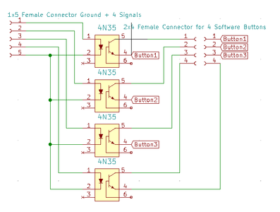

Light and mist maker were controlled by simple hardware push buttons. According to another lesson from the Arduino starters book, it is possible to programmatically "click" these buttons using optocouplers. This was the last lesson in the book and I have never had a chance to try it out. I didn't want to break any of my home electronics just to try out that lesson. Now, when I've purposely bought lights and mist maker for my automated bog garden, I finally had a chance to hack hardware buttons. Unlike MOSFETs, optocouplers can work with 3.3V signals, so they could be controlled directly from the Raspberry Pi Zero W.
Using four optocouplers, four small LEDs and a bunch of wires and connectors I was able to build a 4-software-button driver, which can be operated from the Raspberry Pi. LEDs are optional, I used them to make sure that the signal from the Raspberry Pi actually reaches the driver board.
To "click" buttons from Raspberry Pi Zero W we can use such a code:
from gpiozero import LED
from time import sleep
button = LED(17)
button.on()
sleep(0.150)
button.off()
Sleep period could be adjusted. Longer sleep period can mean long button press in some appliances.

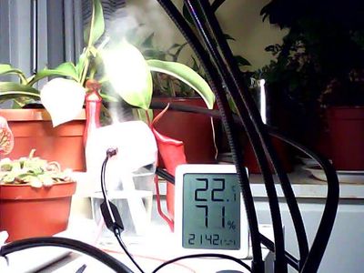

Raspberry Pi 3B+ has 4 big USB connectors. These can be used to plug web cameras. I've purchased 3 small cheap video cameras, which turned out to be quite bad. But they were fine to check small things like water level in the main water tank or in the mist maker cup. I've also purchased one better webcam capable of making HD video. It's not an amazing image quality, but much better than the cheap video cameras were making, and good enough to see how are plants doing overall.
To actually work with the video, it is possible to use ffmpeg-server tool, or separate RED5 rtmp server. I tried both, but it seems that Raspberry Pi is not capable of transcoding HD video on the fly, so I've got 5 fps video at best. Also, I was unable to reach shorter than 15sec delay of the "live" stream. Both these facts pushed me towards another solution.
I decided that a simple HTTPS server, able to enumerate video devices on the Raspberry Pi, and deliver single frame from selected video device, would be enough. For example, simple routine of adding water to the plants tray would look like this:

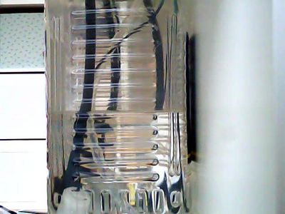

  1. Take a photo of the tray and main water tank. Visually make sure that there is not enough water in the tray, and that there is enough water in the main tank.
  2. Request tray pump to work for 15 seconds.
  3. Take another round of photos, to make sure that the water was successfully added to the tray.
  4. In case if there is not enough water in the main tank - add water from the water supply to the tank, before refilling the tray.

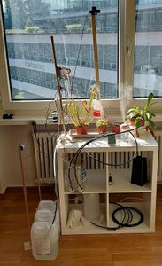

To place cameras in good positions, I've used sticks from local building market mounted to the rectangular pieces of wood serving as base. I've used self-tapping screws to couple stick and wooden base together. One good lesson to learn about using self-tapping screws is that you should make a hole before screwing the screws. Otherwise, stick can give a crack.
Later I discovered that it is possible to use ESP32-CAM device which provides quite good live video streaming. I haven't yet tried to use it for actual projects, but it seems to be a promising direction.
To take photos from connected USB cameras I used this ffmpeg command:
ffmpeg -i /dev/video0 -vframes 1 photo.jpg
All the cameras were available under even ids as /dev/video{0,2,4,6}.

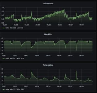

Step 10: Optional: Grafana
Every 10 minutes I was taking measurements of the humidity, temperature and Nepenthes soil moisture level. I've written this data into a log file in a format of SQL inserts:
INSERT INTO humidity VALUES ('2021-08-02T22:13:33', 58);
INSERT INTO temperature VALUES ('2021-08-02T22:13:33', 27.5);
INSERT INTO moisture VALUES ('2021-08-02T22:13:33', 245);
This data could be later imported into some database. To plot the data, I've used Grafana. It should be possible to display two datasets with different measurement units on a shared chart, but this function was buggy for me, so I had to create three different charts.
Anyway, from this charts I learned about a correlation between soil moisture readings and temperature in the apartment. This could be important if I would decide to implement alerting system. Threshold value would depend not only on the value of the soil moisture sensor, but also on the temperature at the moment.

In the end I was able to successfully manage my bog garden remotely from another country. The only thing which broke was a mist maker. After few weeks it just stopped turning on. After I've returned home I just plugged it out of the power, and turn on back again, and everything was working as expected.
Having computer with an ssh access turned out to be a great flexible tool. Arduino in this case seems to be a separable, low cost worker. Putting any heavy logic into it seems to be less flexible overkill. It should be able to take enough parameters for any piece of work, while Raspberry could actually make decisions what should be done and how. It can also be a nice sensor information collector.
After a month away from my bog garden, I discovered that few new pitchers grew on Nepenthes and Saracenia, while Droserra became much fluffier. I had to spend some time to trim old dead leaves from Drossera, and it was looking very nice after that.
